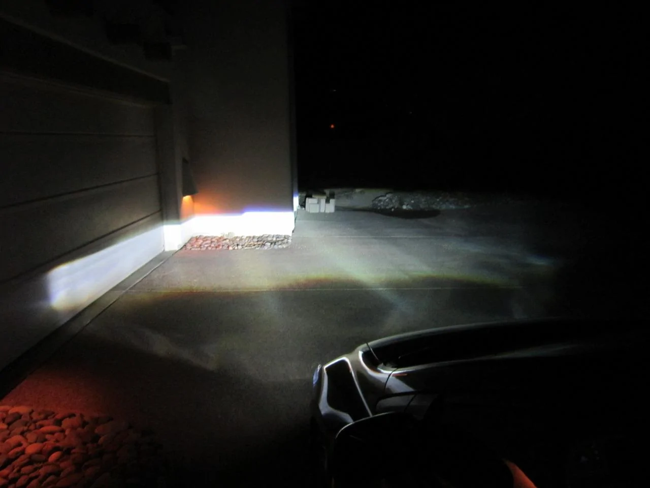

I have pics from my old projector retro and what the output on our stock halogen projectors is. I'll try and remember to post them up when I get home.
