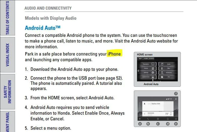

Android Auto issue possibly solved!
I've had my Touring for about 3 weeks, then suddenly Android Auto won't load anymore when I plug in the USB. I went through the manual to see if there was any setup stuff i should do, and i think I've discovered the issue. According to the manual I need to be using an iPhone to run Android Auto.
Anyways, i'm going to try pulling the fuse tonight and see if that fixes it.
did pulling the fuse fixed it?
