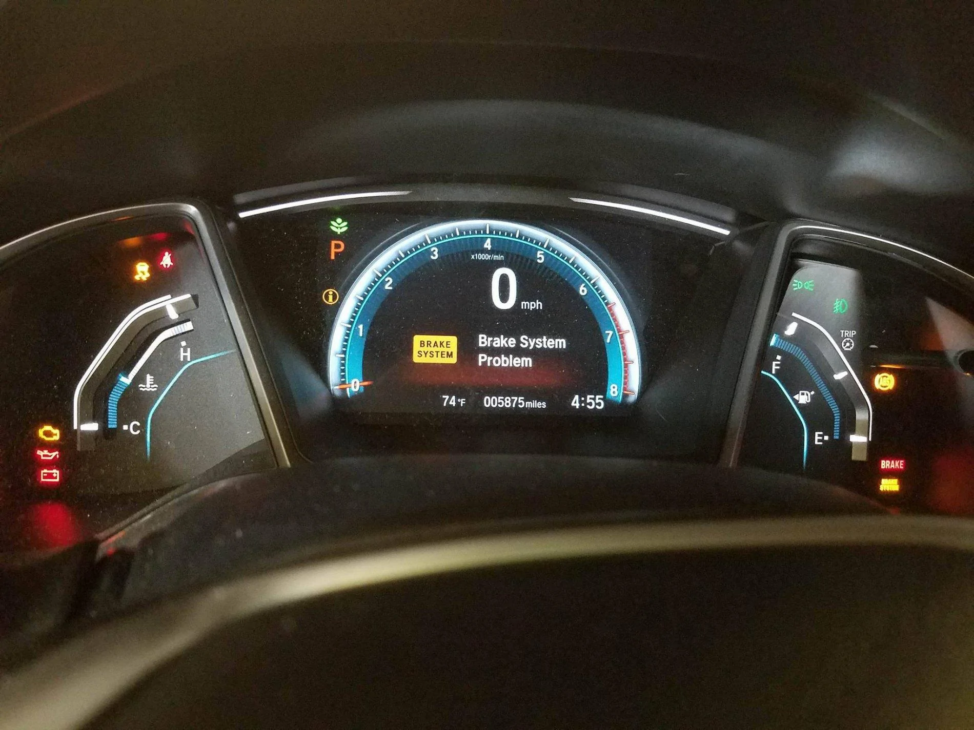

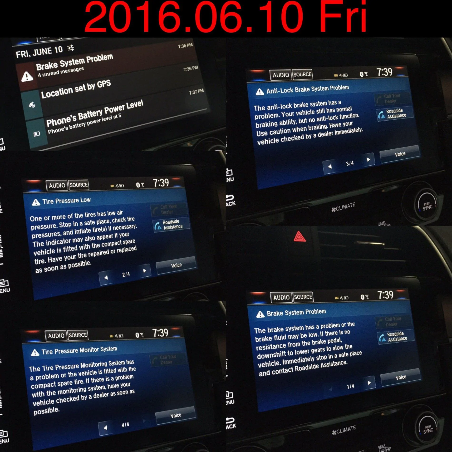

Hi everyone. My 2016 EX-L is about a month old and yesterday/today I'm getting these warnings seen on this thread. It started with just one yesterday (the 12 volt battery charging system problem message) and then about 4 additional warnings this morning after I turned off the engine at work and turned back on to ACC mode.
I called my Honda dealer to set up a time tomorrow to bring it in but I'd like to cancel and delay that and just clear the messages myself and see how long it goes without further warnings returning.
I did not download/install any additional apps. I have an iPhone 4S that I sometimes use bluetooth or hotspot with. I do not use HondaLink (that I'm aware of anyway), and I thought reading the messages would dismiss them but I still have them. I'm about to go back to it and try rebooting the HU or whatever.
You guys have any suggestions? Do you think I should bring it in tomorrow? I'd like to take care of it myself if all I have to do is calibrate the TPMS again (just one of the warnings, getting warnings about the breaks too, which is kinda scary) and the car appears to handle normally and stopping at the dealer is inconvenient.
