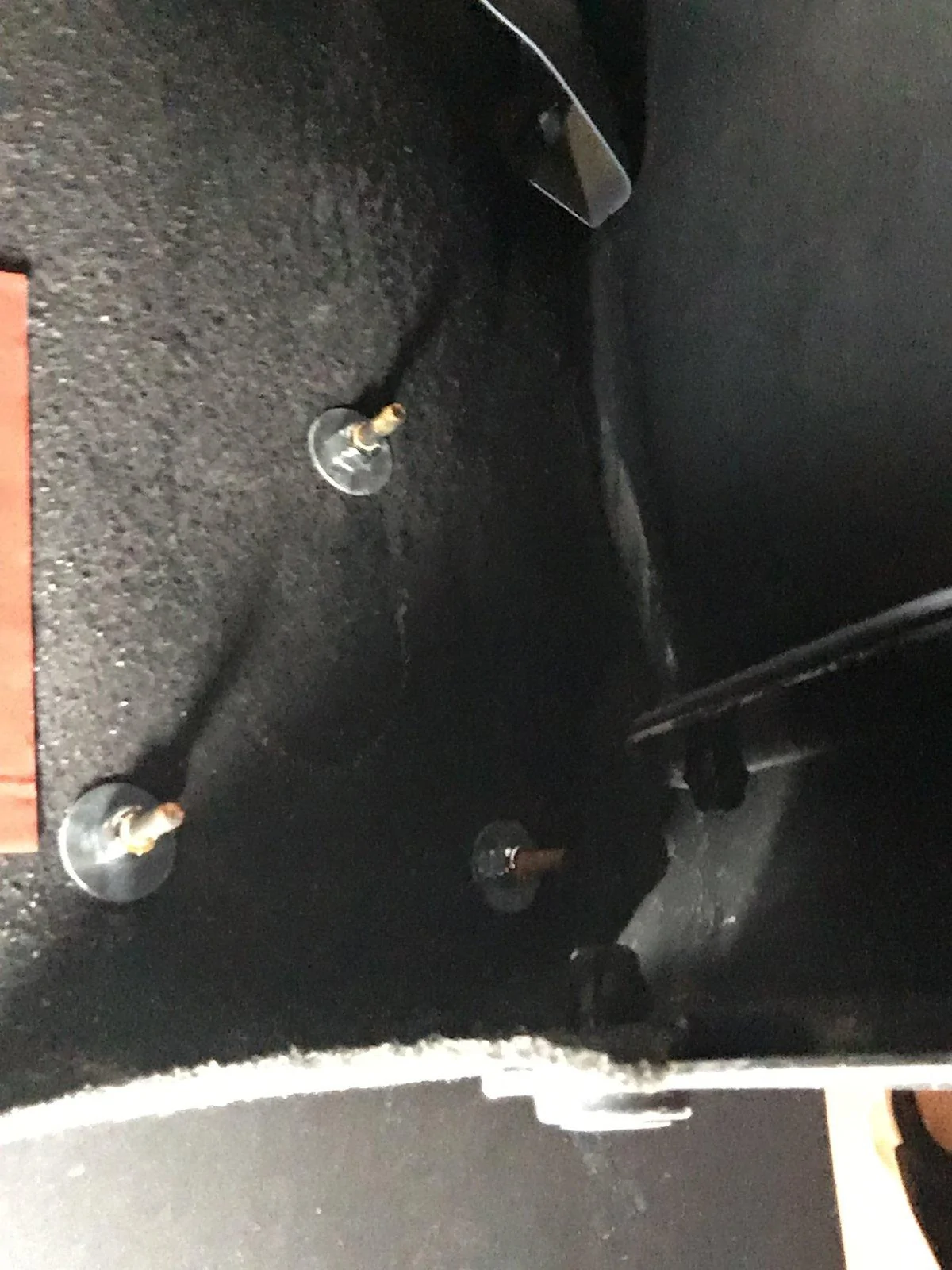

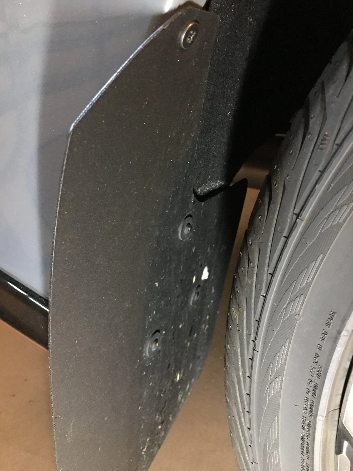

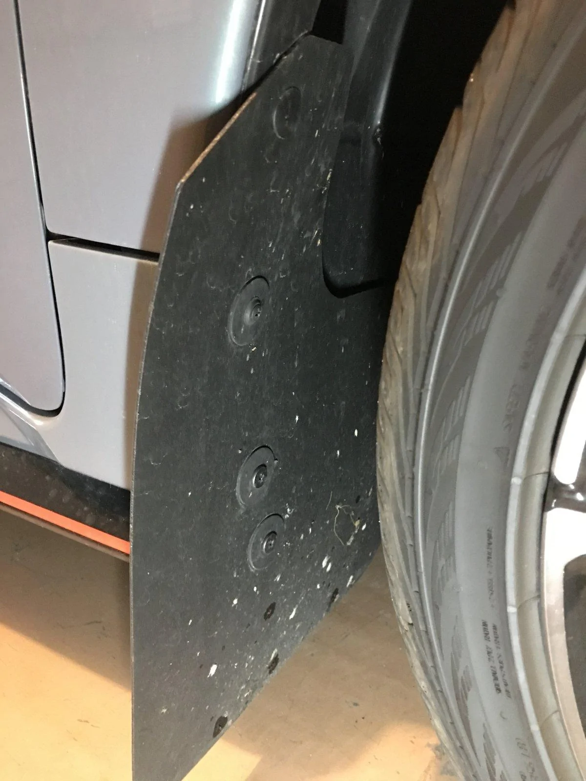

For the front ones, I used the factory screw holes with a washer behind them and the stock screws, and drilled a hole at the top for a push retainer. Also have a piece of double sided adhesive holding the inner piece to the wheel well so it doesn't flap around at all. Rear ones were the same deal but had to drill through the felt wheel well material in the back to help attach the mud flap with some screws, washers and a nut on the back to secure it all in place.

These look tough and packed with peanuts.
