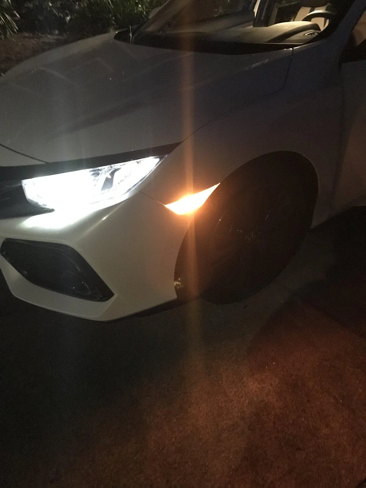

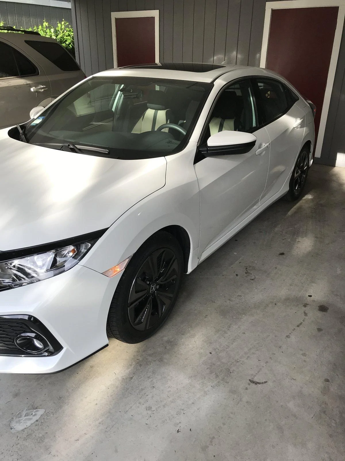

I installed the LED switchback side marker from Optix Autolabs. I will post some pictures later tonight with them. They are very nice. Tapped the wire into the turn signal so when the lights are on, the LEDs are white, turn signal they flash amber.
