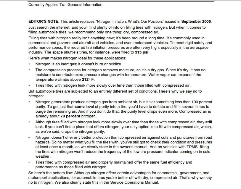

Tpms lights been on a few weeks now. Just wondering if anyone has manually removed or have to bring it back in to dealership. Tires look perfectly normal and only have 900+ miles on the odometer. Originally filled with nitrofill so this was supposed to eliminate any false readings such as temp drops.

did you reset the light? it will not go off by itself you need to reset it by going into vehicle settings. also honda recommends not using nitrofill, there actually a bulletin on it. not because it hurts anything because it really doesnt do anything for our vehicles. anyways try resetting the light after checking your pressures, if the light keeps coming back then id take it in Honda Civic 10th gen TPMS Sensors nitro
