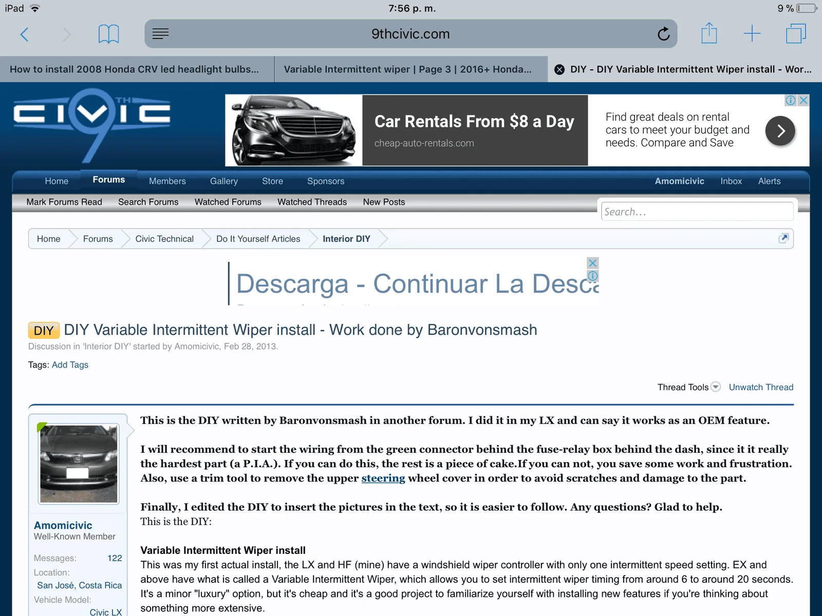

I did it in my 2012 Civic LX. You can check it. It is an easy and useful job. Good luck.
Honda Civic 10th gen Variable Intermittent wiper D945A551-ADD1-4ECB-93C7-9729AC551637
I tried the same thing in my 2017 Civic, but this time the feature was not available into the computer.

Hello,
I wired everything before as you say with no results. I bought the same wiper stalk and runned a wire from pin 10 to E21 and nothing happened. I think that because there are several control modules versions, the feature is not programmed in my Civic LX control unit.
Let us know if you have better luck with yours.

I wired everything without any testing done before, because the success I had with my ´12 Civic. I was expecting the same results.
