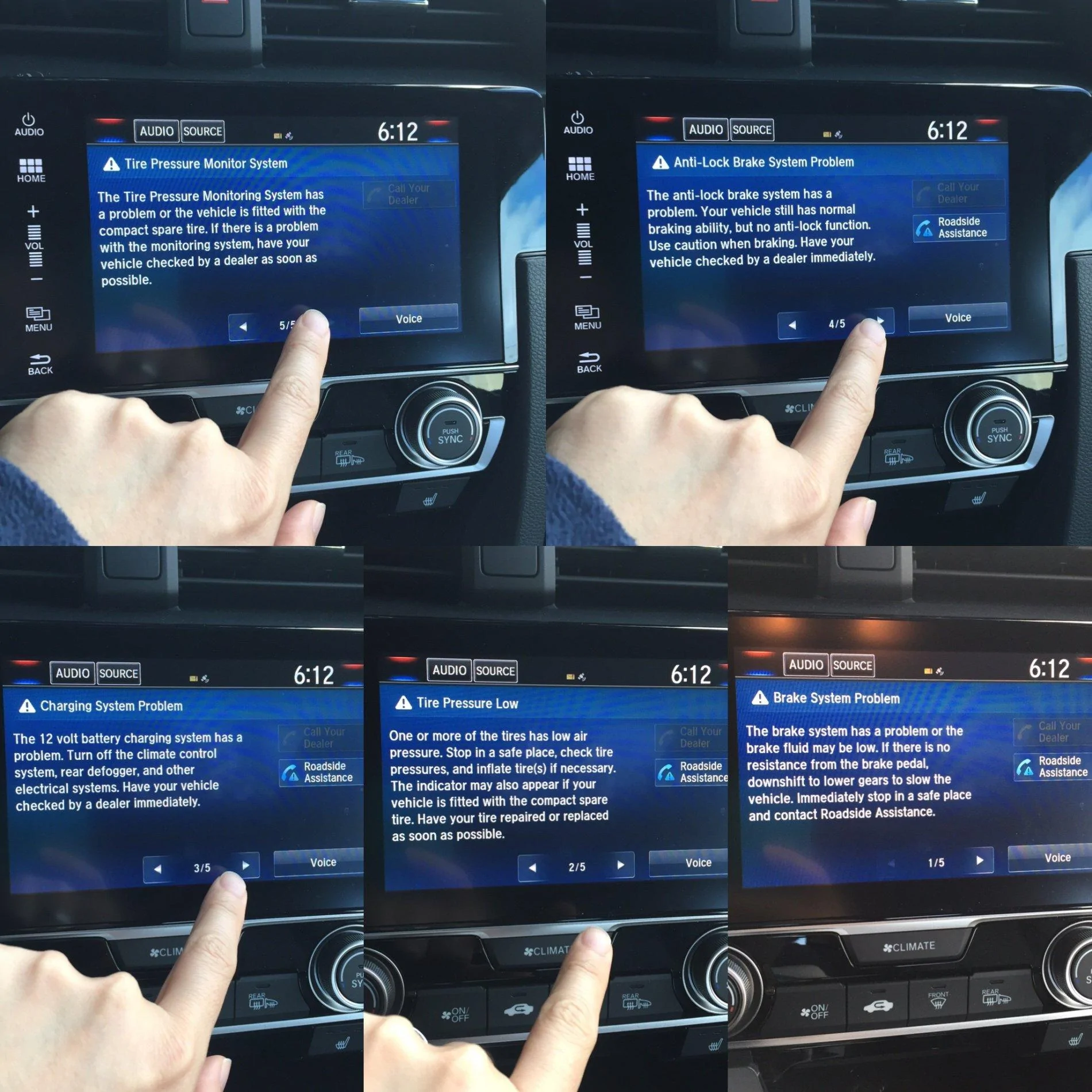

After 13 days in the shop (long story), I got my car back. VSA Modulator replaced.
The next day? Got the same 5 errors. Even worse, my car wouldn't unlock again. WTF.
What do I do?
What do I do?
Do you often use your car in accessory mode?

Well, my adventure was fun today. So I go in for...
Oil Change/Tire Rotation
TSB 16-22 (Radio Update)
Error messages on radio that came up Tuesday
They claim TSB 16-22 would probably fix that. Nope. Before I can even drive off the lot....5 error messages. I drive straight back in and don't even turn the car off and show them. This is the first time they have physically seen the error. All prior times have been pictures on my phone. They take it back, have a tech look at it, and say it's throwing voltage issues causing the errors to display. They figure it's because they didn't reset some computer after the software update. They reset it and bring it back and say I'm good to go.
What do you know, before I get off the lot, Brake System Failure. I turn around again in the lot, take it in and that message disappears and it shows Tire Pressure Low. They test all four tires, all are great. After all, I just had them do an oil change and they even reset the TMPS Calibration after I circled the lot the first time (as that was one of the errors.)
So, they give me a loaner and say they will give me a call. They finally called 2-3 hours later and say they are replacing the VSA Modulator again. They claim there is a new version out with new software that they cannot update so they have to replace the whole thing. They are freight overnighting it for $300 (I call BS as it's a small part and UPS next day is only about $50) and should have it replaced tomorrow.
I explained that this was the final chance as before driving in my car qualified as a lemon in Ohio. They begged me for one more try so I'll give it to them. However, after this, it's replace the car, no other options.
Oddly, they are still telling me what some on here are saying, those are error messages I can ignore and a true error will display in the instrument panel. I still don't believe that. Why would they even place those errors on there if they are just "additional" to the IC? No car doubles up on error messages. And if it is bogus, then why won't they sign a piece of paper stating my vehicle is 100% safe to drive if those errors come up and I can ignore them? It seems they think there is some issue.
I'll update more once I get it back again. But now it has four official documentations of the errors at the dealership (they didn't do a service order when I picked the car up the first time.)
