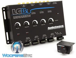

I run the speaker wires in the trunk (including the subwoofer wire), through an LC8i (see photo below). This allows me to listen to the radio from the Honda system (which is rare). I also plug my iPod Classic directly into the LC8i and control it from the iPod as I could never get the Honda system to consistently play the iPod (this is a known issue in this forum). Then the stereo RCA outputs are run through a sound processor to perform EQ, and then out to amps for the speakers and subwoofer. I added a 10" sealed sub box, and replaced the stock speakers with Focal Power. It sounds very good but it was a lot of work and money (fortunately, I had most of the equipment from my old car).
What is sad is that the upgraded, stock sound system in my Subaru Outback sounds almost as good, and I haven't done a thing to it. Honda totally blew it on the audio system on what is otherwise a jewel of a car.
Honda Civic 10th gen Touring Tweeter Upgrade LC8i

Thanks for the info. So if I understand correctly, you started with replacing only the front tweeters...but ended replacing all of the remaining factory speakers and factory subwoofer and factory amplifiers.
2016TouringSLC
2016TouringSLC
Feb 21, 2016
80
Salt Lake City
2016 Honda Civic Touring
That's correct. Fortunately I had the amps, sound processor, and sub from my old car, so I only had to buy the LC8i and the speakers. I only recently upgraded the speakers, so for many months I just had the tweeter replacement. I also used a generic Dynamat product to seal the front doors and did some other sound-deadening upgrades, and those have provided a nice improvement.
I'll say that to my ears, the most significant improvement came from adding a sub box in the trunk and the tweeter replacement in the front, as the stock midrange speaker is not bad and is able to put out reasonable bass.
