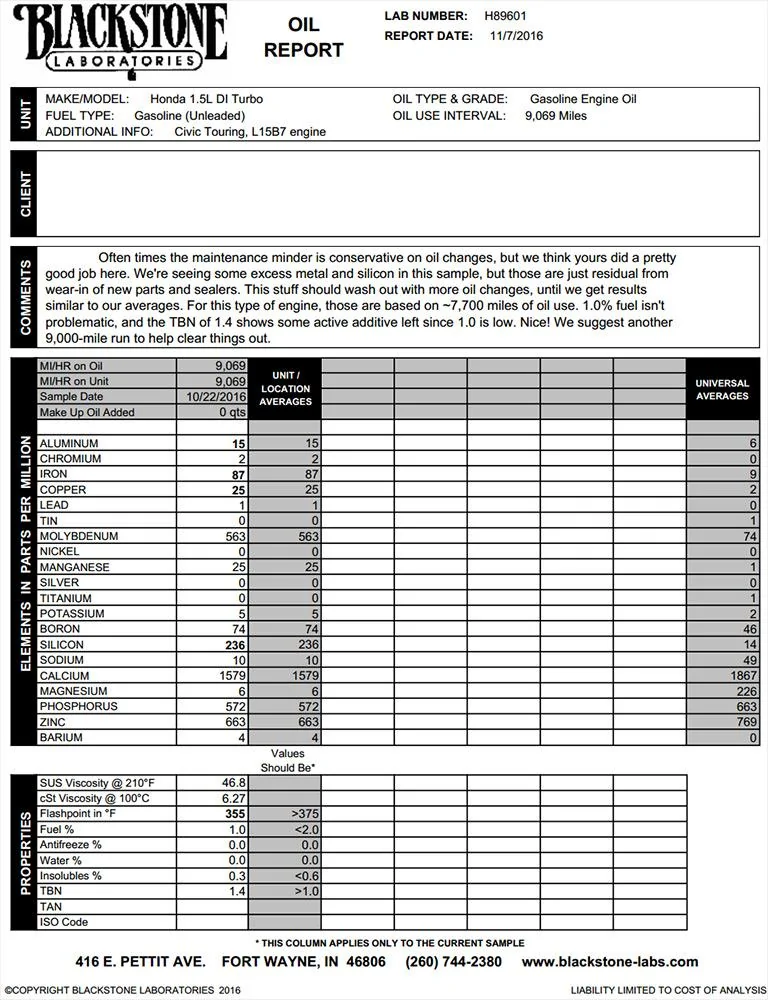

Honda Civic 10th gen The Oil Thread oil-1
Above is my UOA (click for full size) from after my first oil change at 9069 miles. My Maintenance Minder was showing "125 miles overdue" (i.e. 125 miles past 0%), so I mentioned that in my notes to Blackstone Labs and paid the extra $10 for TBN analysis since I was curious how much life was really left in the oil. Looks like it was fine.

Most have been reporting that the maintenance minder errs on the side of caution. Good to see that reflected in your UOA as well. I agree with their assessment that wear particles should improve over the next oil change (or two).
Thanks for sharing. :cool:

Anecdotally, there is one - the FAQ at Blackstone Labs says "We here at Blackstone generally use regular petroleum-based oil because honestly, it works just as well for us." I assume their decision is based on all the analysis they do, so that seems like a pretty good study even if it's not a scientific double-blind one or anything. I put Mobil 1 in when I did my recent oil change, since I didn't have my UOA results yet, but based on my results I think I'll probably do regular oil next time.

lets acidic / corrosive compounds created by combustion into the oil.
Isn't the fact that my TBN number was fine at 9K miles evidence that what Honda's doing DOES result in a ring seating that adequately keeps acidic compounds out of the oil?
