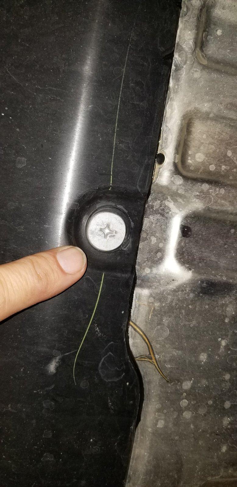

Remove the aluminium pan under the car, covering engine. There are 6 each 1/4 turn, flat head screws and 2 each cross tip screws you need to remove to expose the oil filter and the oil drain plug.
Honda Civic 10th gen Oil change and transmission fluid change 20171106_112041 Honda Civic 10th gen Oil change and transmission fluid change 20171106_112217

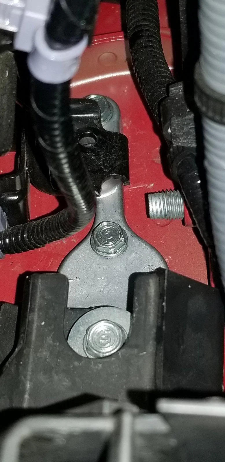

You must remove the air intake box, to access the fill plug.
Remove 4 each 10mm bolts securing the box to bay. One is at the back, by the battery, the other 3 are on the right bottom front of intake.
Honda Civic 10th gen Oil change and transmission fluid change 20171106_143405

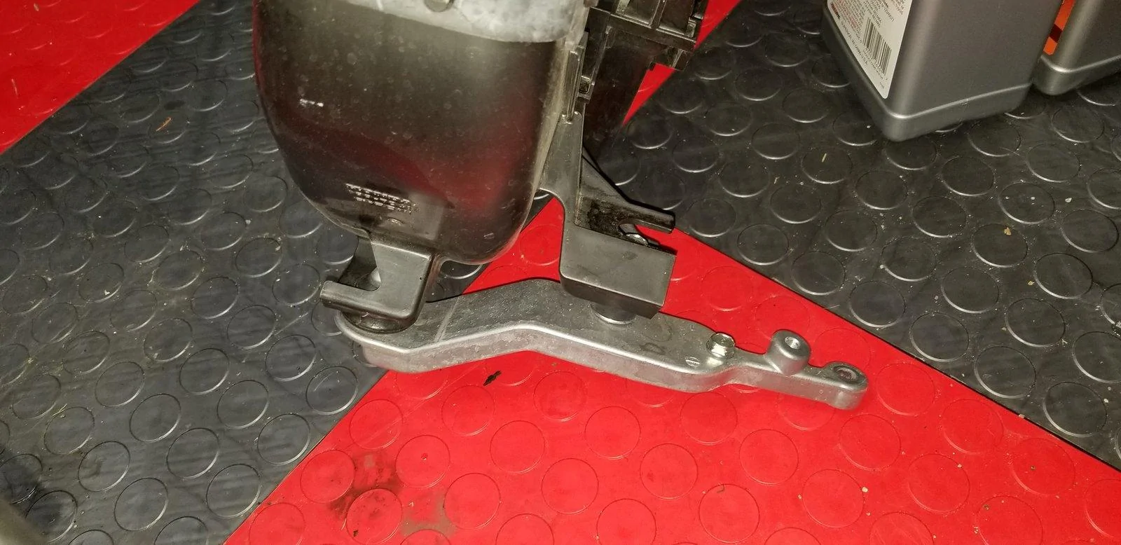

This is what the bottom of the Intake box looks like
Honda Civic 10th gen Oil change and transmission fluid change 20171106_131739

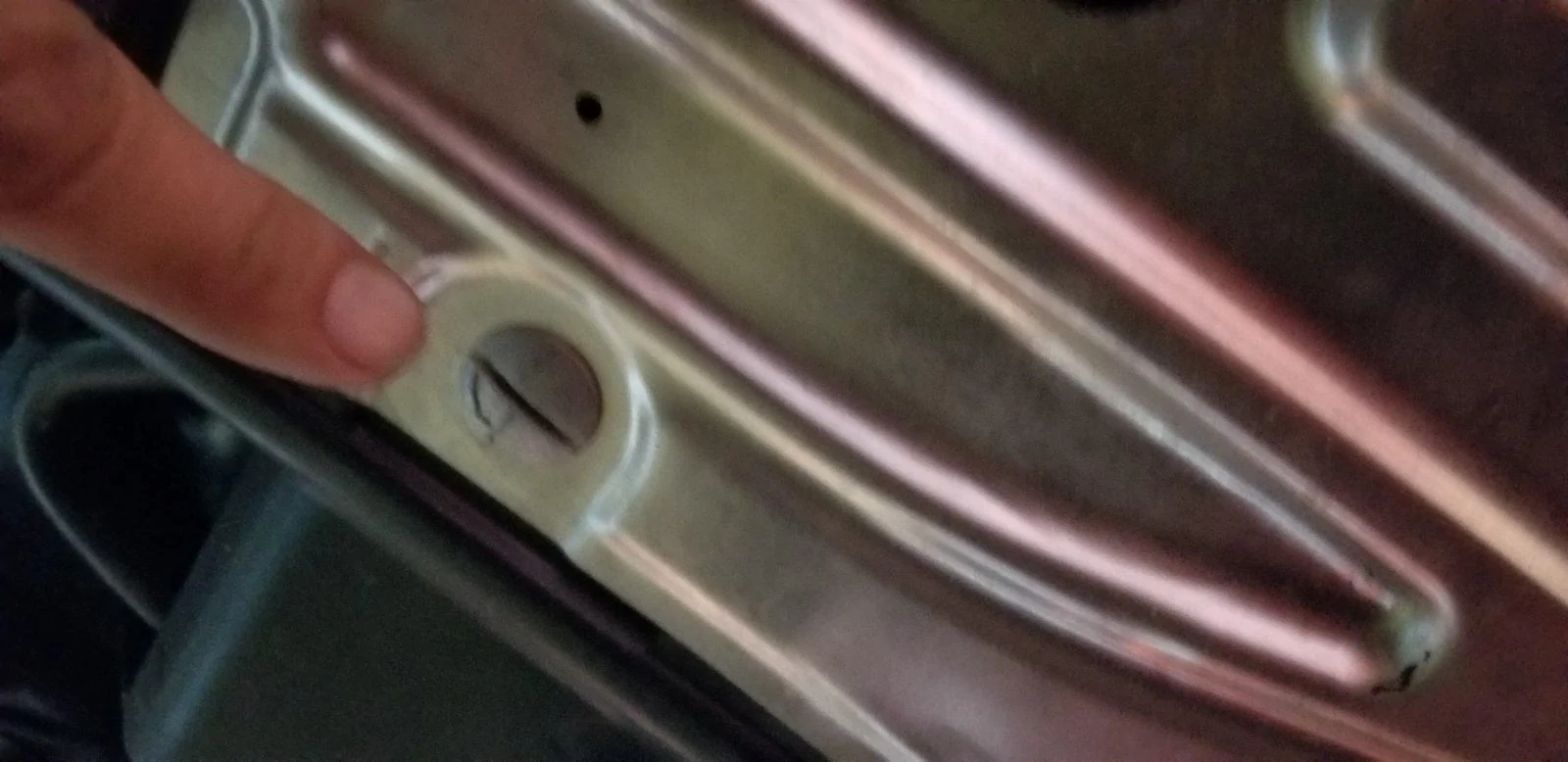

Remove the rubber seal that surrounds intake aperture from front of car.
Honda Civic 10th gen Oil change and transmission fluid change 20171106_145216

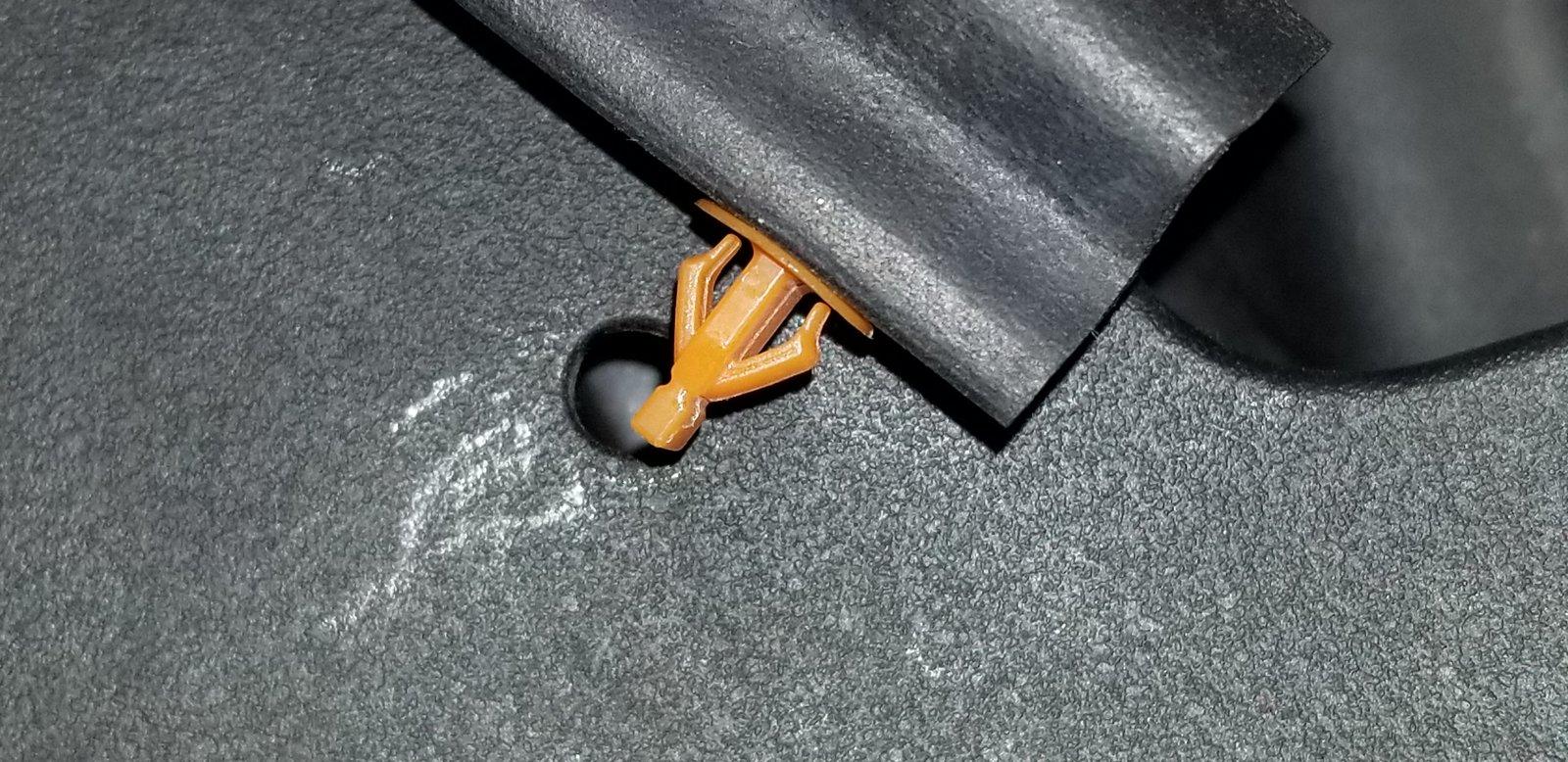

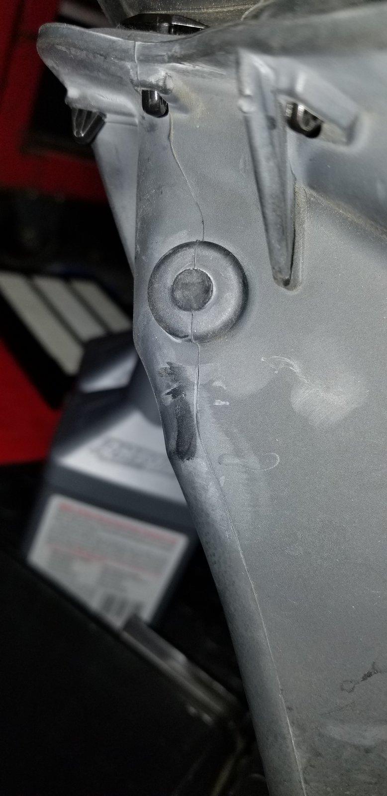

Remove the two nubs(tits) that are at the upper portion of Intake. Careful not to tear one like I did.
Honda Civic 10th gen Oil change and transmission fluid change 20171106_131754

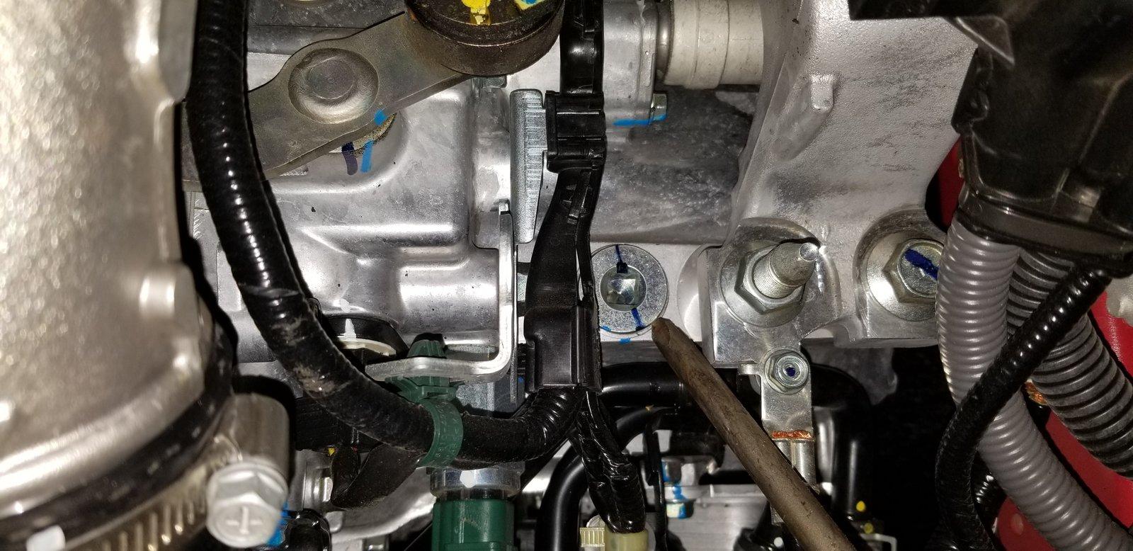

Honda Civic 10th gen Oil change and transmission fluid change 20171106_131256

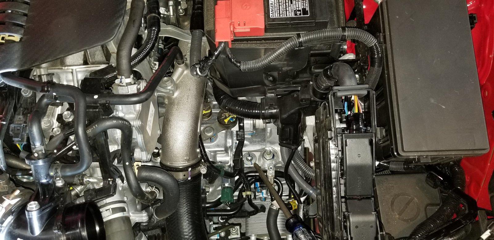

Use 3/8" extensions to remove the filler bolt.(pointed at it with the big screwdriver)
Honda Civic 10th gen Oil change and transmission fluid change 20171106_131303

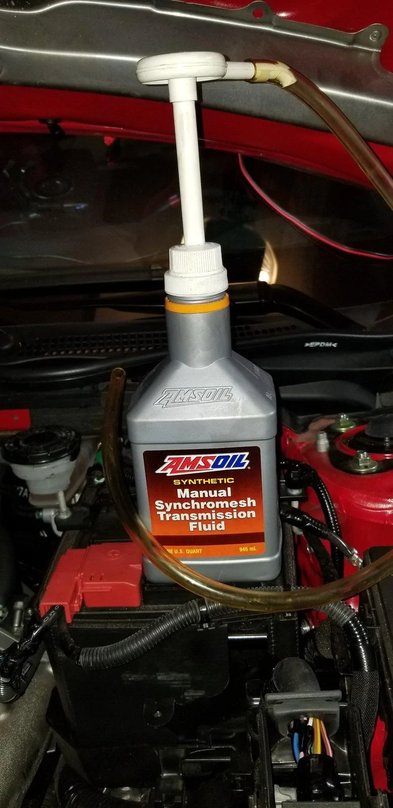

I used a pump for the Transmission fluid
