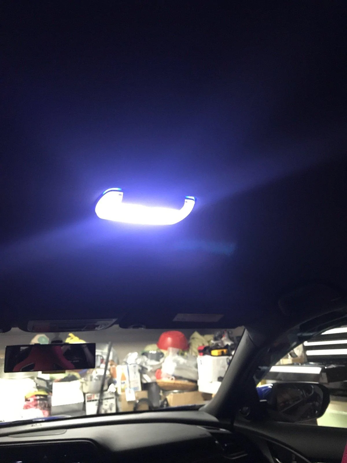

Installed with dome light on:
Honda Civic 10th gen LED Dome Light 0DzkYcr

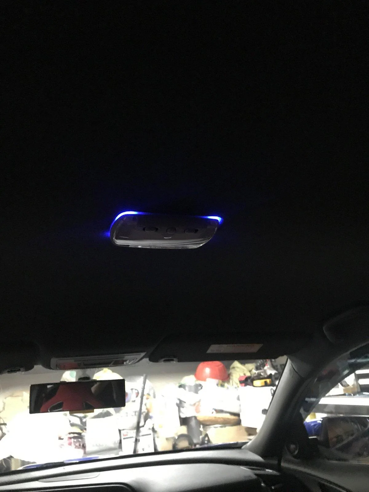

Spot light on and "Room Light" on. It would be better in red other than blue but whatevs it's cool nonetheless:
Honda Civic 10th gen LED Dome Light uXGeqeI

Blue Fancy Light:
Honda Civic 10th gen LED Dome Light l6suXif
Honda Civic 10th gen LED Dome Light xWfeavG

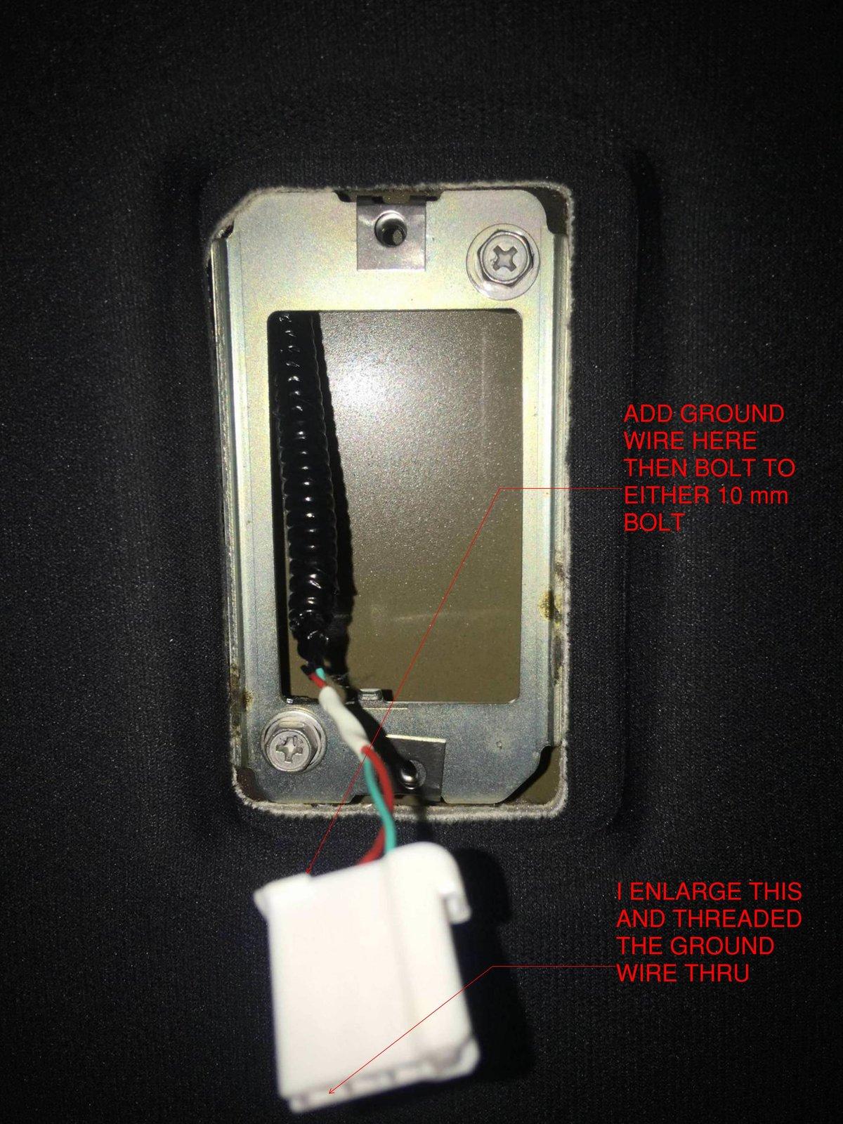

installed!
I'm going to take it that this install is literally as easy as remove and replace?
Dads coming back from Japan in a few days so I had him pick me up one while he was over there so just curious to see what's involved.
UFO CTR
Oct 12, 2016
2,530
1,877
San Frrancisco, CA
2017 CTR#1348
yes, it's as simple and remove and reinstall. but my kit didn't come with the proper harness, so you'll have to add a ground wire to the factory harness and ground it, then plug factor side (now with 3-wires) to the provided harness (that came with the kit) and you're good to go!
oh one more thing, the ground wire that was supplied with my kit didn't fit my harness; the pin was to big to fit into the factory harness, so I've enlarged the square hole for the ground pin and threaded it thru the enlarge front side, then pull the rest of the ground wire thru from the back side. just like threading a thread thru a needle. Basically, find a way to add the ground wire and you're good to go.
Honda Civic 10th gen LED Dome Light 9GZCTp4
Well, I sent UFO the wrong subharness, so it was more involved. I didn't have any subharness, so there was a little wiring similar to UFO. I was finally able to get subharnesses that I have a proper connection and crimps to make it easier.
