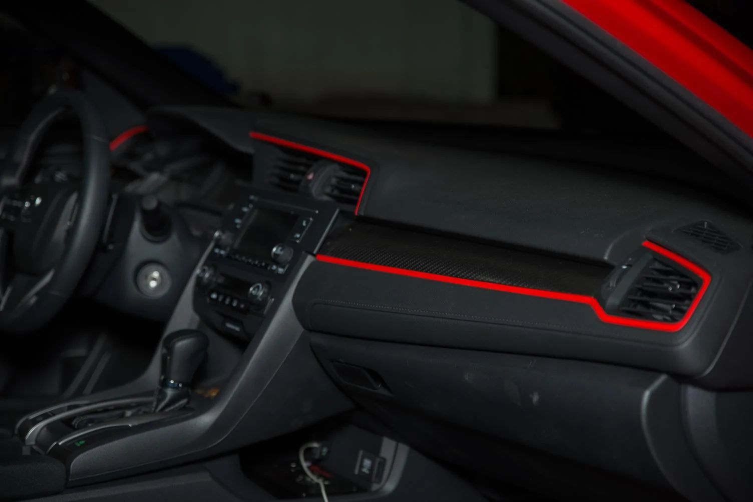

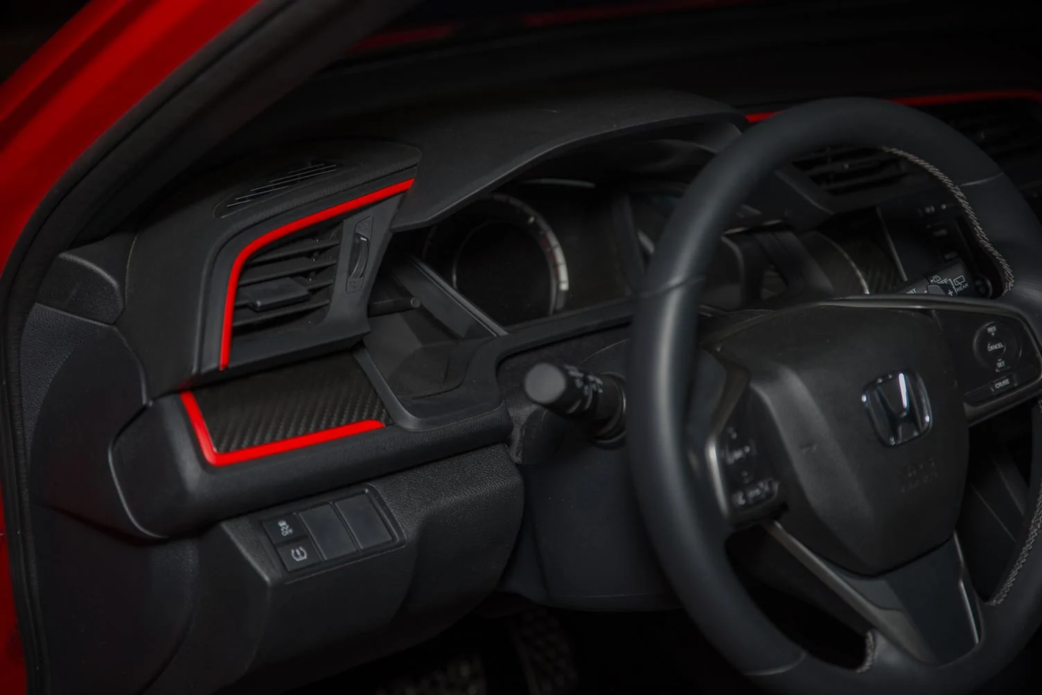

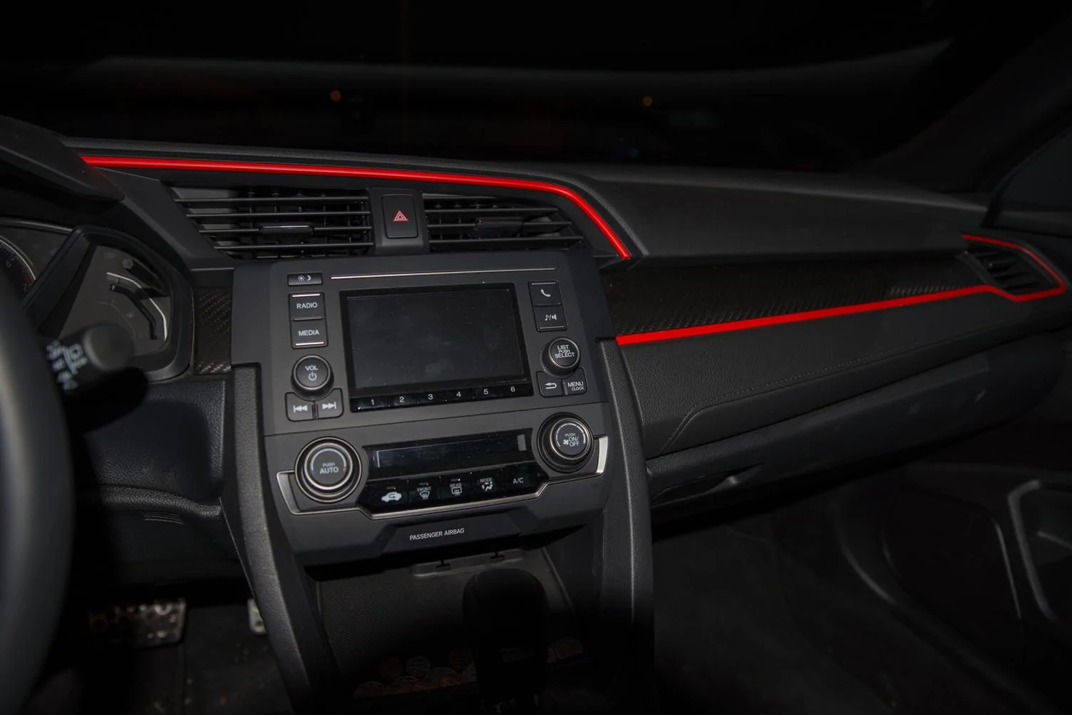

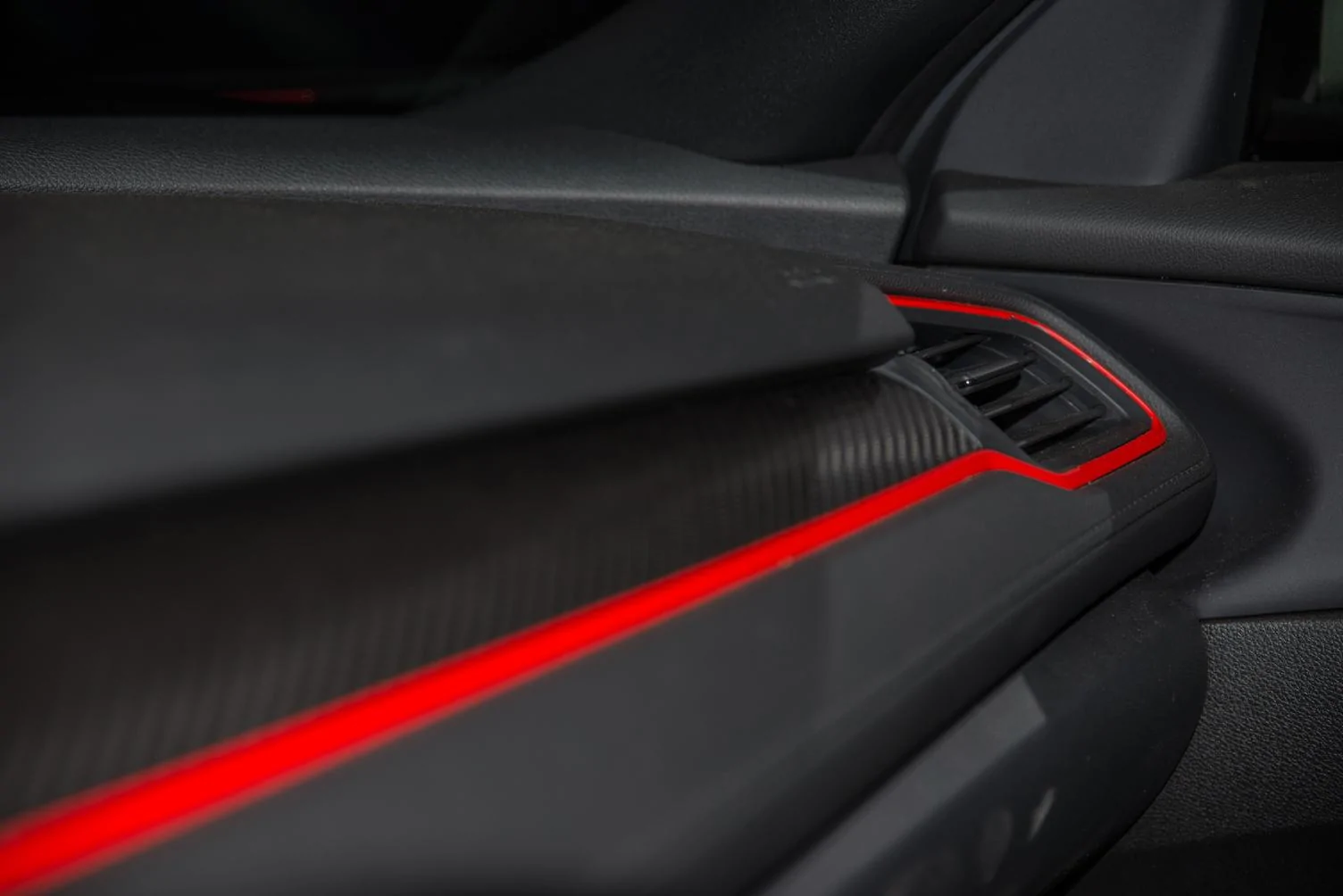

I know I've seen a few people do this already so it's not something new but I just wanted to share my project. I took out all the plastic trim pieces that would be red on the Type R dash and I wrapped them with matte red 3M vinyl. The 2 pieces to the left of the steering wheel came out in 2 seconds as well as the one above the center air vents. Now the one to the right in front of the passenger seat is a little trickier. You have to remove the whole trim piece that it is connected to above the glove box and the air vent as well, then you have to remove some trim below the radio and loosen the radio and A/C controls to get the trim piece out.

How did you go about pulling these trim pieces? Did you need to lever something under them?

I used a small screw driver and a cloth being careful not to scratch anything.
