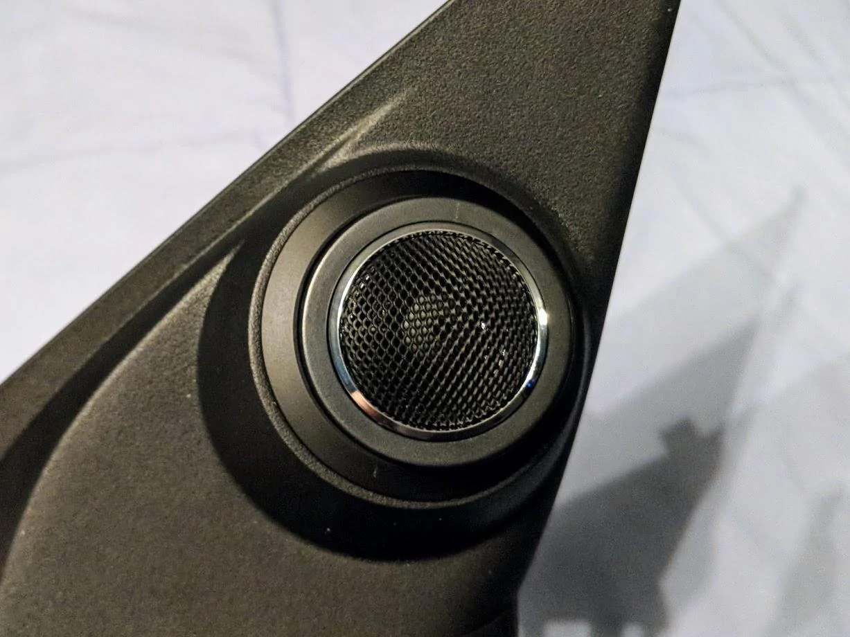

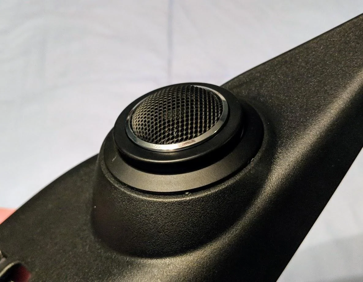

So I just got these, and I'm testing out the tweeter installation.
I was surprised to the point of laughter at how easily it mounts...they literally screwed right in!
Honda Civic 10th gen Infinity Components & Subwoofer w/ Alpine Mono Amp IMG_20180609_172903 Honda Civic 10th gen Infinity Components & Subwoofer w/ Alpine Mono Amp IMG_20180609_172922
I didn't have to use the giant plastic threaded nut to clamp it down.
It was tough to get it threaded initially, but you can push the side that sticks up to get it to go in even. You can force a thread or two in is what I'm saying...it's nice & tight, and not going anywhere.
They fit well in the hole with the stock mounting hardware completely removed.
Honda Civic 10th gen Infinity Components & Subwoofer w/ Alpine Mono Amp IMG_20180609_173711
The only negative I can think of is that they do stick out some. But that's so you can adjust it left to right in its bucket. There's a screw in the rear to lock the position. It's mainly made for door sails w/o a mount to begin with. I'm assuming it would be awesome as well in non-10-speaker system that don't come w/ tweeters, but can't verify (obviously).
Honda Civic 10th gen Infinity Components & Subwoofer w/ Alpine Mono Amp IMG_20180609_173726
I'm going to leave the Infinity sticker off of it for more of a stock look.
If you were curious, Infinity uses a 5.6uF 100V filter.
I'm going to try it w/o the filter first, but I have a feeling I'll need it.
I hope I can salvage it from the Crossover box, but if not, there's plenty on eBay.

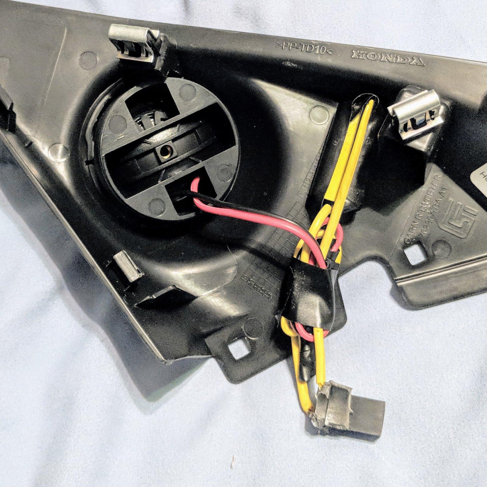

Here's what I have after it's all soldered together.
I was able to remove the filter from the crossover box and soldered it in-line.
I hot-glued it to the rear of the sail (top right in the pic w/ electrical tape around it).
I also took @galoki 's idea and salvaged the connector off of the old speaker.
Honda Civic 10th gen Infinity Components & Subwoofer w/ Alpine Mono Amp IMG_20180610_213131
added more electrical tape after this, and I'll connect it up and test it tomorrow, it's a bit late now...

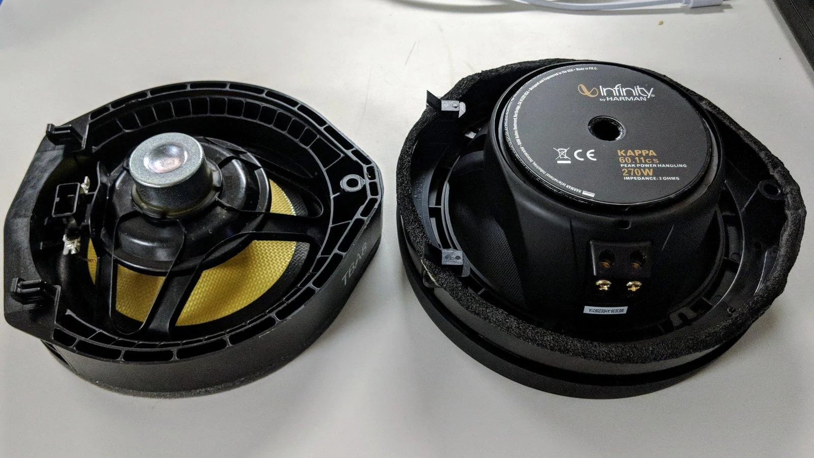

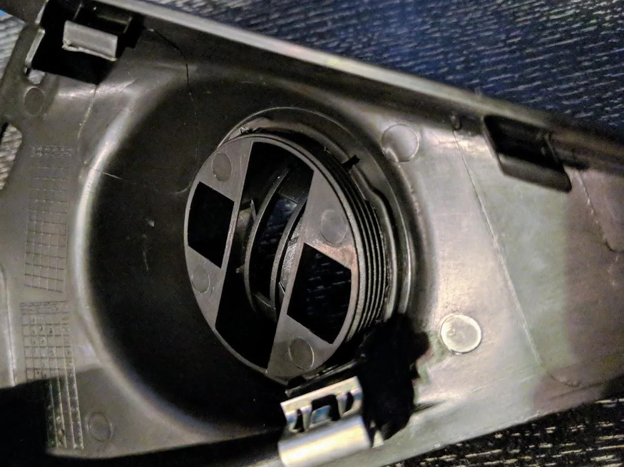

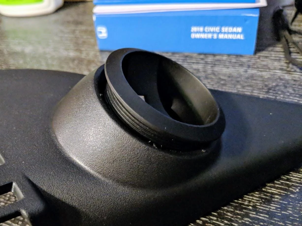

Installed one of the mids in the door yesterday evening. Didn't take any pics as it was 120 in the garage and I just wanted to get done. I'll take pics of the other one when I install it, just don't have time to do it now...
Here's the comparison tho:
Honda Civic 10th gen Infinity Components & Subwoofer w/ Alpine Mono Amp IMG_20180621_064742
Notice I reused the gasket.
Also, I'm not sure how others got the speaker adapters to screw into the door as they are thinner than Honda's, and I ran out of threads. I had to run to Home Depot and get fully-threaded screws.
Honda Civic 10th gen Infinity Components & Subwoofer w/ Alpine Mono Amp IMG_20180623_085632
Also, another tip, don't put the speakers in before installing the adapter. Not only are they crazy tight, the speaker surround of the Infinitys only fit in certain directions, and you won't know until the adapter is in. Unfortunately the screw I bought didn't allow me to use the pre-drilled holes in the adapter as well. It pushed the speaker down a bit with it's big head. I found one hole that worked, and drilled 3 others with a small bit. They screwed in fine after that and are solid.
