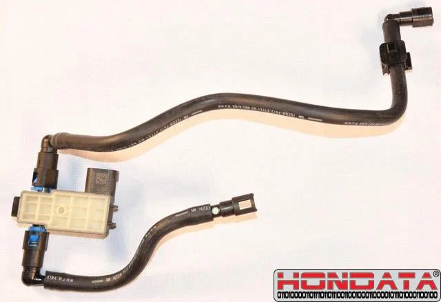

Remove the Clip from the connector
Honda Civic 10th gen Guide to DIY Flex Fuel Kit for Hondata or KTuner upload_2017-11-22_16-30-24

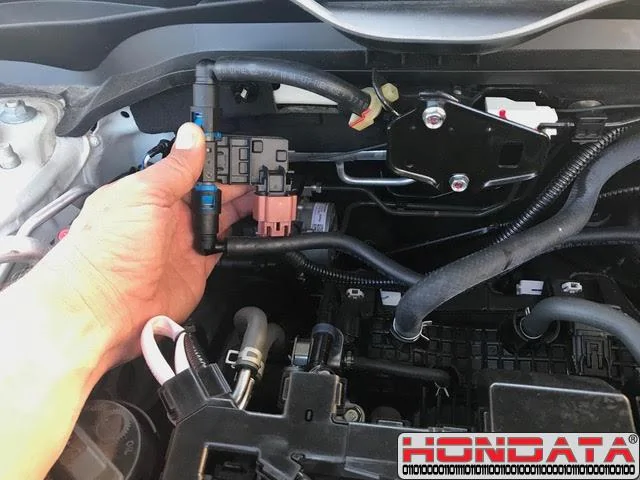

Push the green clips in and pull on the line to remove it off the fuel line.
Honda Civic 10th gen Guide to DIY Flex Fuel Kit for Hondata or KTuner upload_2017-11-22_16-32-59
Do the same on the other end of the line by the intake manifold
Honda Civic 10th gen Guide to DIY Flex Fuel Kit for Hondata or KTuner upload_2017-11-22_16-33-49

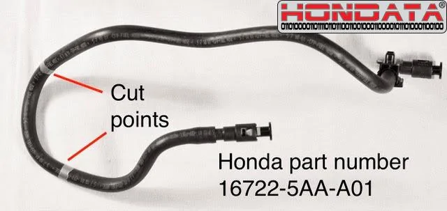

2. Cut the fuel line, insert the fuel clamps and add the Dorman fittings. Use a heat gun to heat up the hose to easily slide over the Dormans fitting. You can also put the fuel line ends in boiling water for a few mins to soften them up. Tighten up the clamps after properly sliding the hose all the way.
