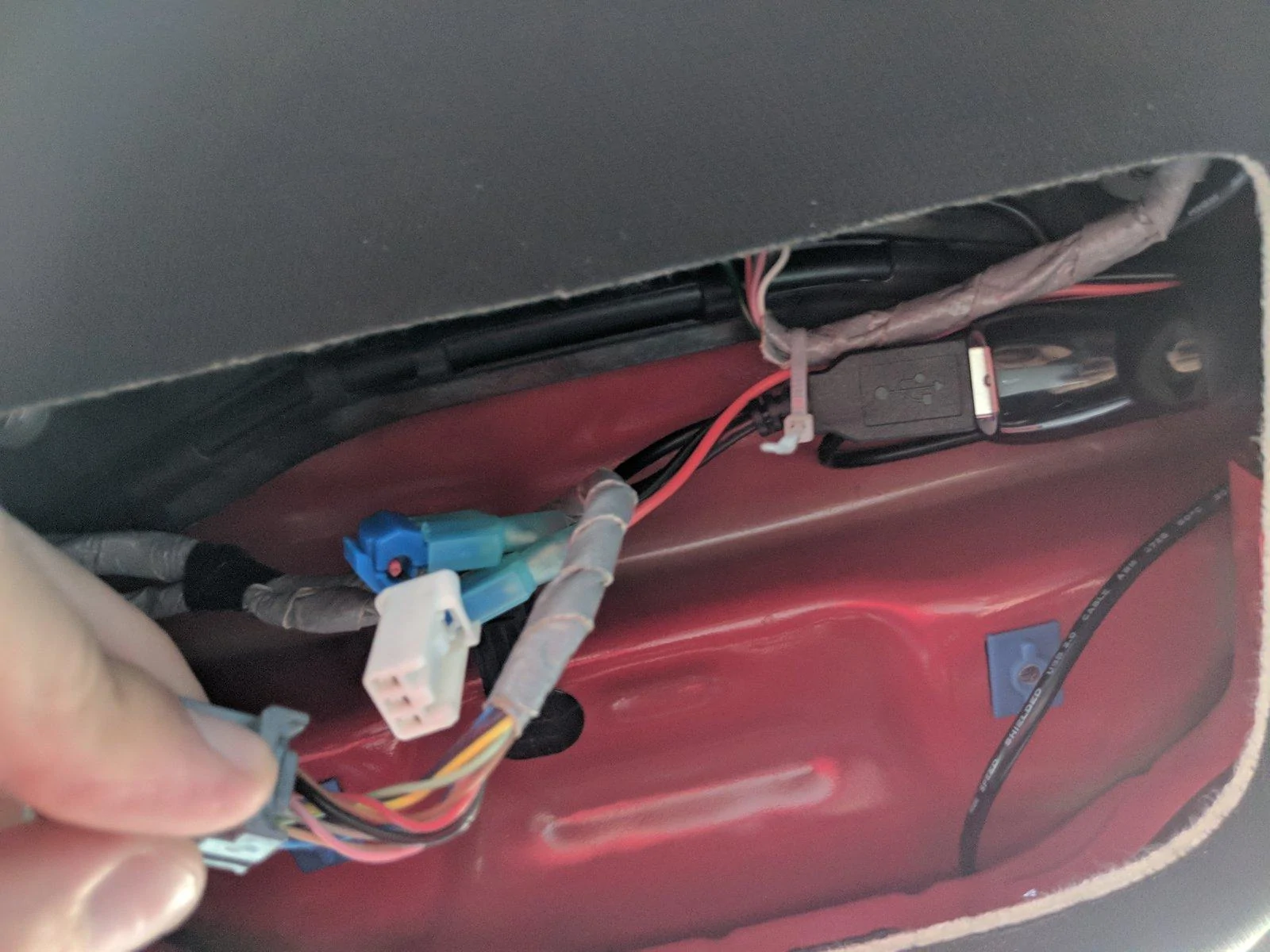

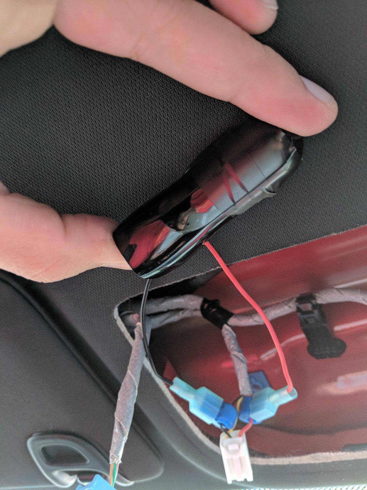

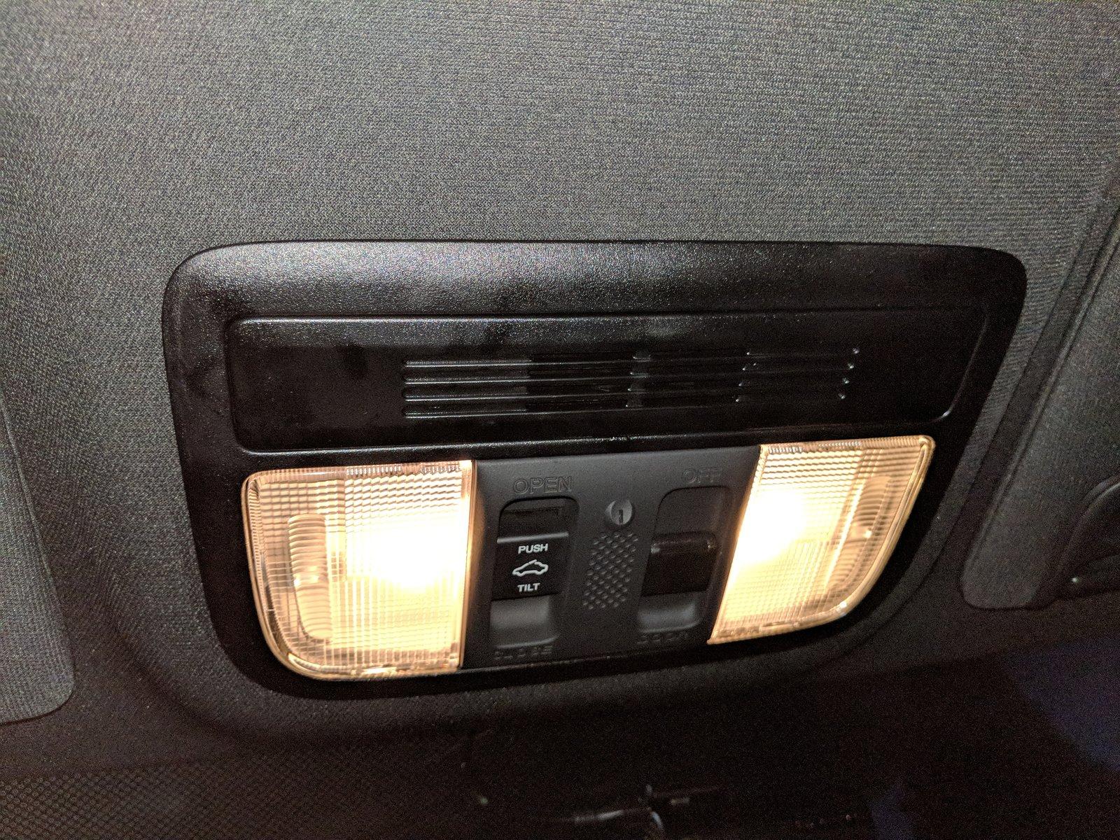

So, I wired up my dashcam today to the light console up top. Much easier than bringing the wire down, especially if you were going to direct wire it anyways.
Go here for detailed instructions for removal of light console
https://www.civicx.com/threads/oem-homelink-install.4683/
Honda Civic 10th gen Dash cams and installations IMG_20171227_173408

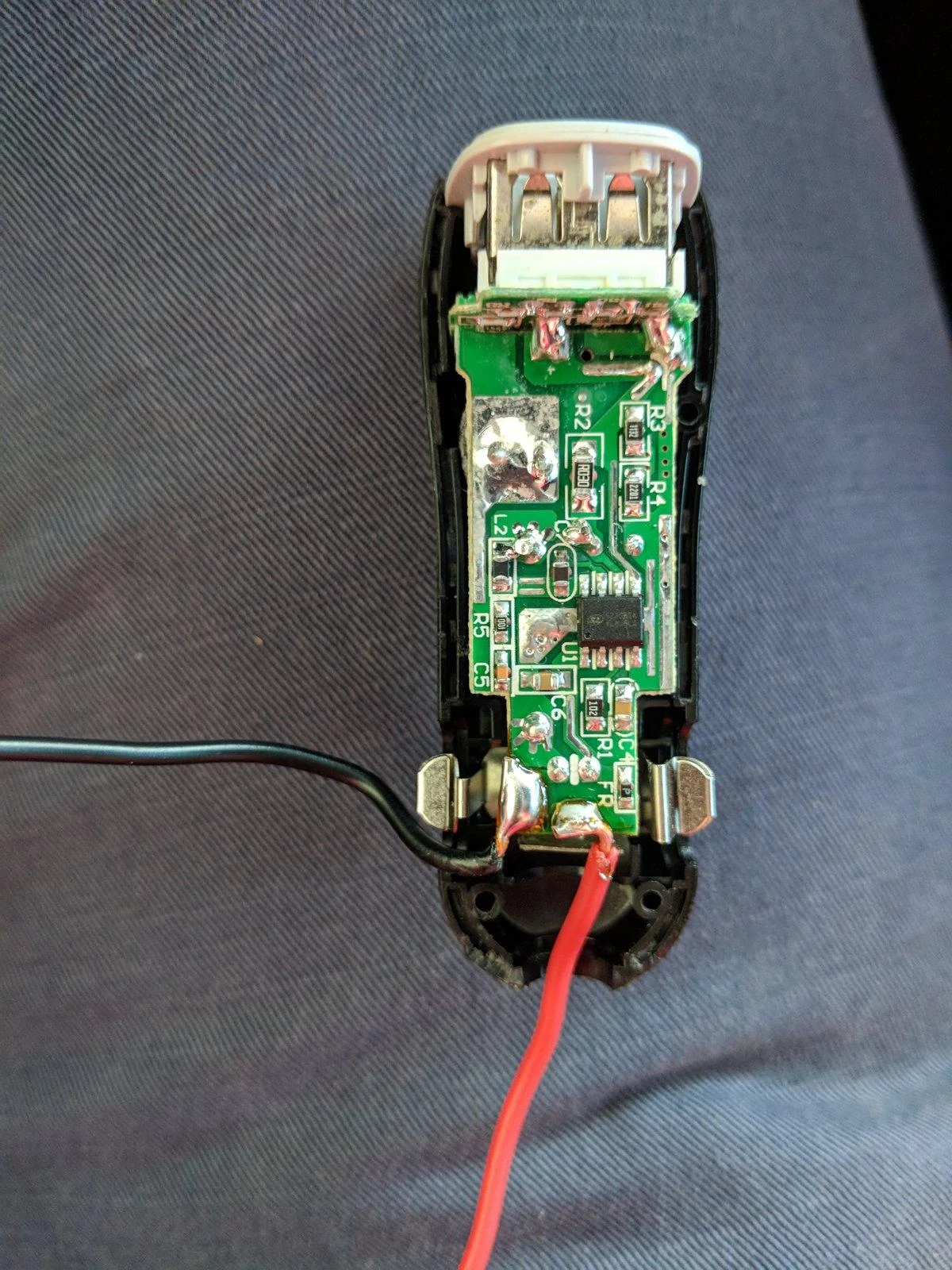

Soldered 2 wires into USB adaptor, you could also buy the direct wire kit, mine only came with a normal carcharger style USB adaptor, so I wired it in.
Honda Civic 10th gen Dash cams and installations MVIMG_20171227_153051
With 12v to USB adaptor wired in.
Honda Civic 10th gen Dash cams and installations MVIMG_20171227_154421
Zip tied to sunroof wires to hold in place

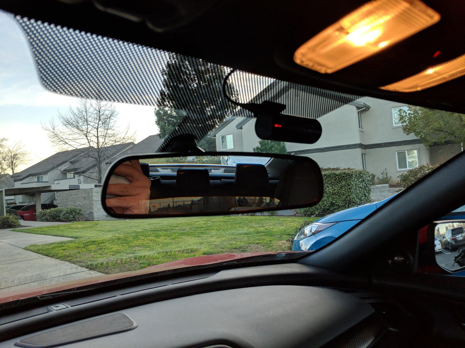

Installed, wire tucked above headliner
Honda Civic 10th gen Dash cams and installations MVIMG_20171227_163021

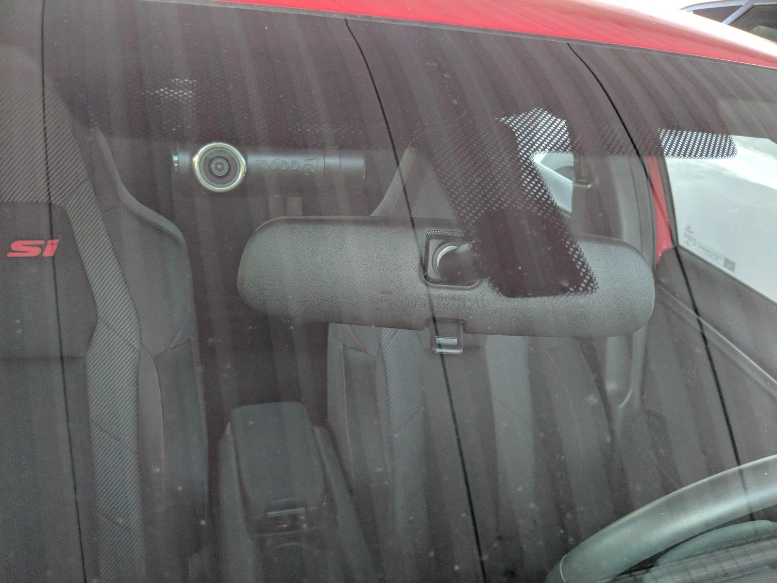

From outside
