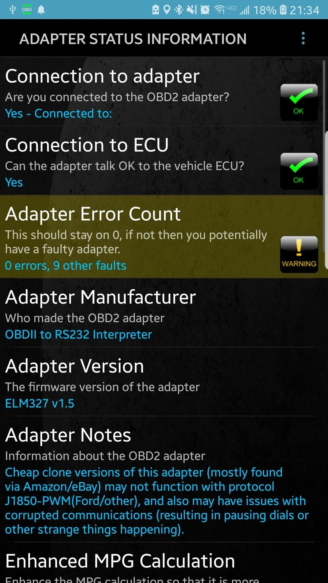

EDIT: ELM does not make version 1.5 as shown in the picture. VEEPEAK IS A CHEAP CLONE RUNNING V1.0.
Btw, sorry for hijacking your thread bro, ill just leave this here though for infomative purposes.
_______________________________
No lag issues with just torque on the headunit.
I do have another potential problem regarding the WIFI ObD2 adaptor.
This VEEPEAK wifi adaptor I am using seems laggy now. Torque Pro reads errors indicating a faulty adaptor (see photo), and benchmarking in the APP also shows this veepeak adaptor performs way below all the others.
Anyone else having smilar problems with the veepeak?
Trying to see if this is just a faulty one i got from veepeak ($17) or if i should just return it and get one of the higher priced adaptors.
Thanks!
Honda Civic 10th gen Custom Gauges Through Infotainment Console Screenshot_20190409-213431_Torque
Boosted1one
Apr 6, 2019
Crystal Black FI FC1 Si ✓
Just a follow up.
The Veepeak i had was faulty, but it seems any of the dongles in the $5-60 range are clones and not authentic ELM anyways. So whatever the brand. All have the same risks. I just went for another cheap brand that worked.
