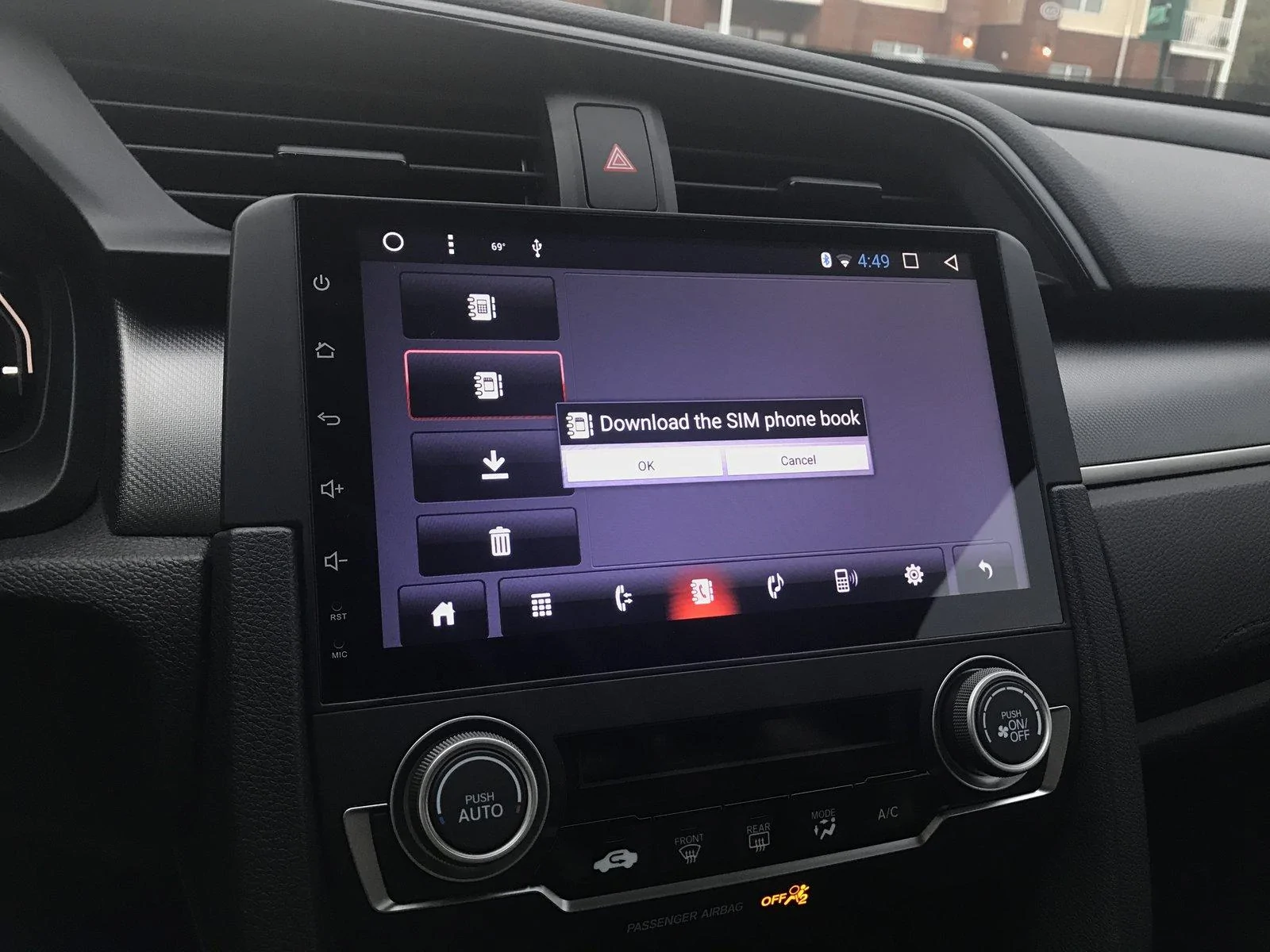

Hi! I just installed the Dasaita HU (MAX6), does anyone know how to import contacts from phone (without having to sync via google account)? I paired the phone via BT, I can make calls etc but the contacts list is empty on the HU.
If I remember correctly, I had to do two things. In my iPhone's bluetooth settings where it listed the headunit (I think mine was called "CAR-KIT"), I had to click on the info ("i") button next to it and enable Sync Contacts. Then in the head unit in the phone app, go to the contacts section, and I think there was a refresh or circular arrows-type of button at the bottom that syncs the contacts via bluetooth.

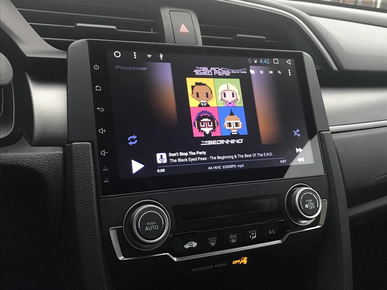

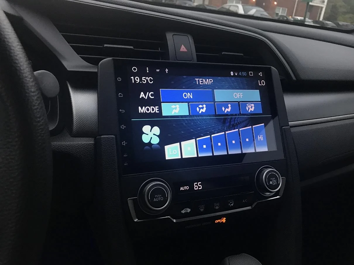

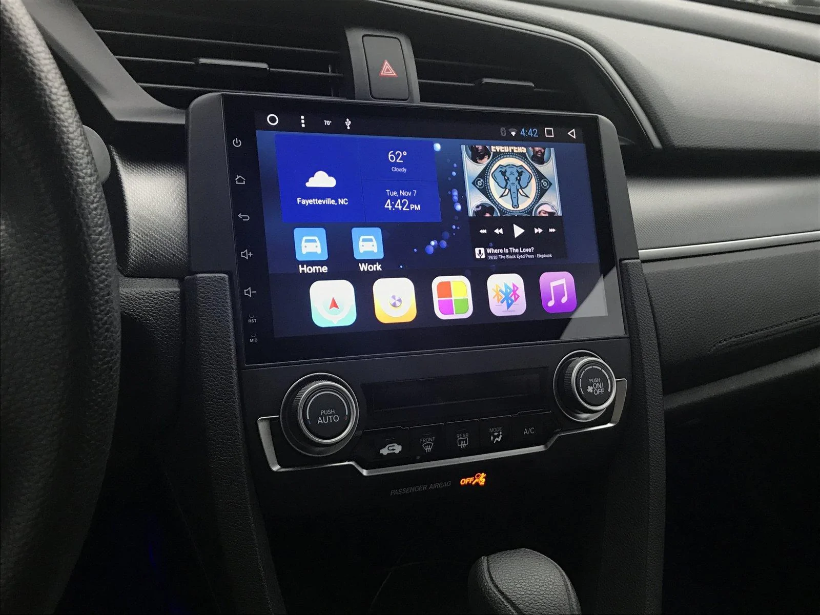

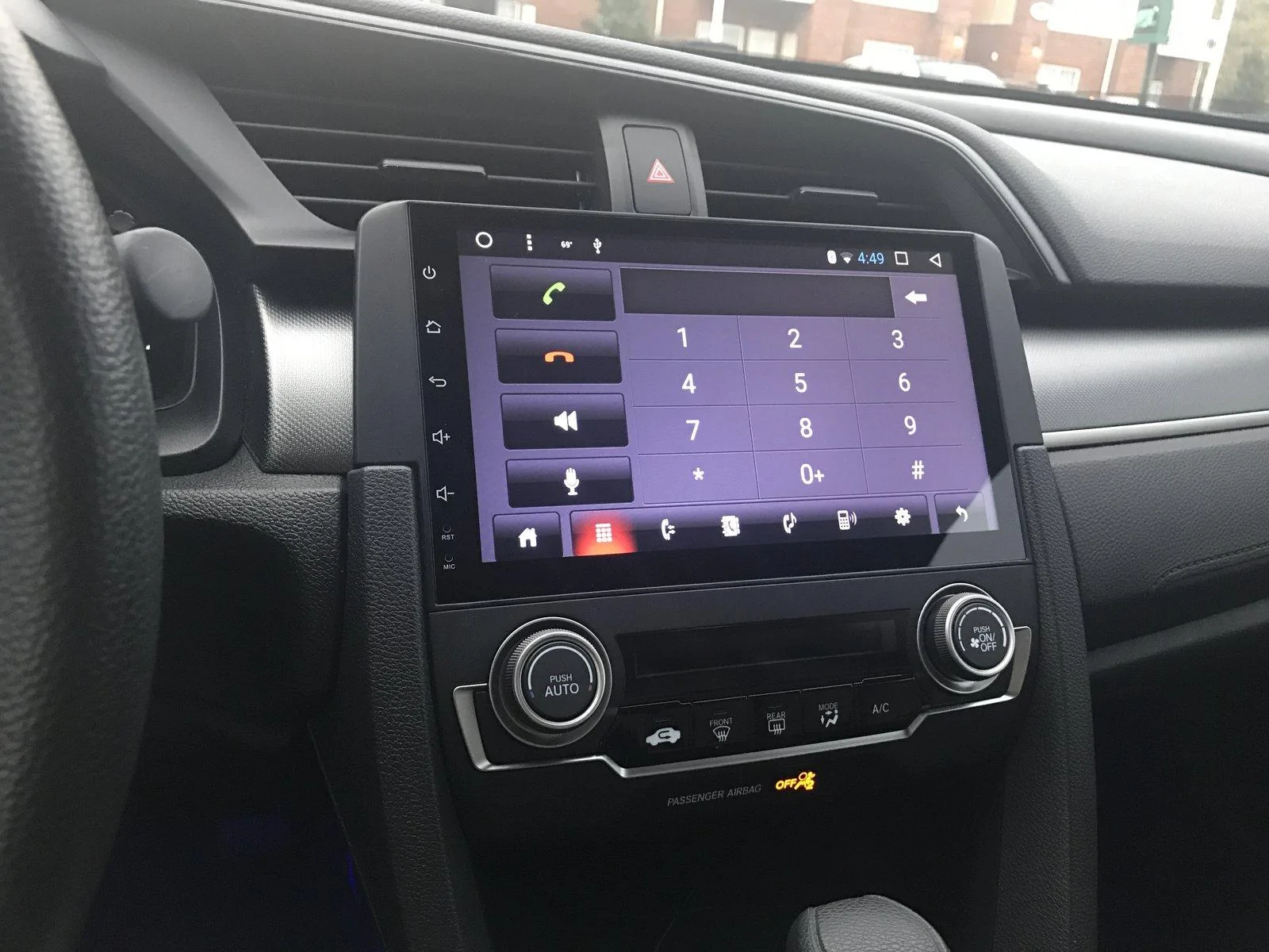

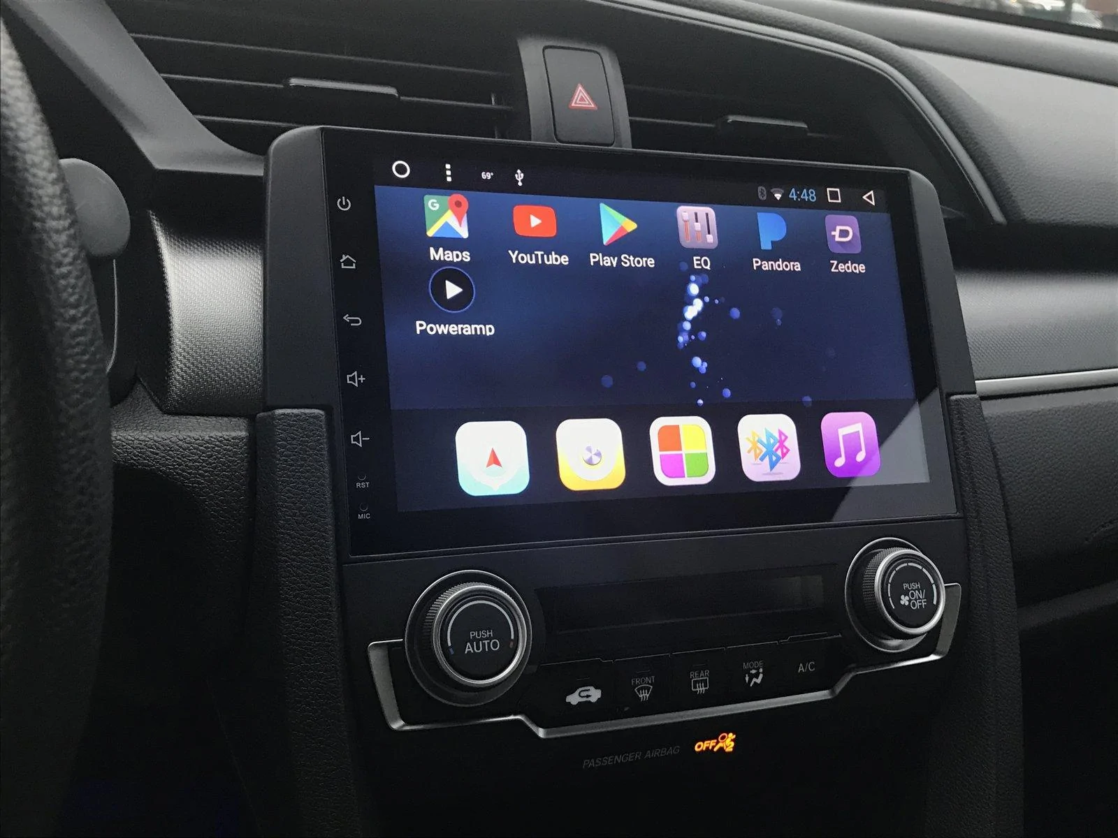

I recently installed an aftermarket 9" android head unit and was asked to do a review / overview of features. The price was $325 after shipping from China. The device works with all existing features in the 10th gen civic and adds some other features:
  • Backup camera - all angles available, also has trajectory lines that follow steering wheel movement
  • Lane watch - Can be disabled in the settings
  • Bluetooth - works with both Iphone and android-based phones. Downloads your contact list.
  • GPS antenna - Can use pretty much any GPS app from the play store. If you want to use ones that also require data (Waze, Google Maps) then you either have to tether your phone or download the offline maps to the device
  • Wifi - Works great with tethering
  • 2 USB ports - one routes to the OEM USB input, the other one goes behind your dash to the glove box. I keep a 1TB external hard drive connected with all my music / videos etc.
  • Steering wheel controls - Fully functional, can map any button to perform whatever function you would like. (The cruise control buttons are not able to be mapped however).
  • EasyConnect - a phone mirroring app - works with both iphone and android-based devices. Also allows you to play music over wifi.
  • Update: Apple CarPlay - possible through the purchase of this USB dongle.
System Specs:
  • OS: Android 6.0.1
  • 1 GB of DDR-3 RAM
  • 16 gigabytes of ROM storage
  • SD slot
  • 2 USB ports
  • CPU: A9, Quad Core 1.6GHz frequency
  • Screen Resolution: 1024 x 600
I have had the unit installed for over a week. Overall I am very happy with it so far. It is a major upgrade from the LX head unit. Music quality is at least equal to that of the OEM headunit, however I am only using the stock speakers. I am not sure how well it would handle an AMP and aftermarket speakers. It does come with the connectors to hook up that equipment however. An equalizer is included and does a decent job, but there are plenty of other ones that on the play store.
I made a video showcasing everything that I could think of. I am not an audiophile, or a master reviewer for head units / sound systems so take it for what it's worth. I made the video by request to show what you can do with this head unit.
I am working on an installation video next. The install was relatively easy and took a little over an hour for me, but could easily be done in less time. The unit is basically plug and play, with the exception of having to connect 2 wires which are clearly labeled.
If you are interested in the head unit or have any questions let me know.
