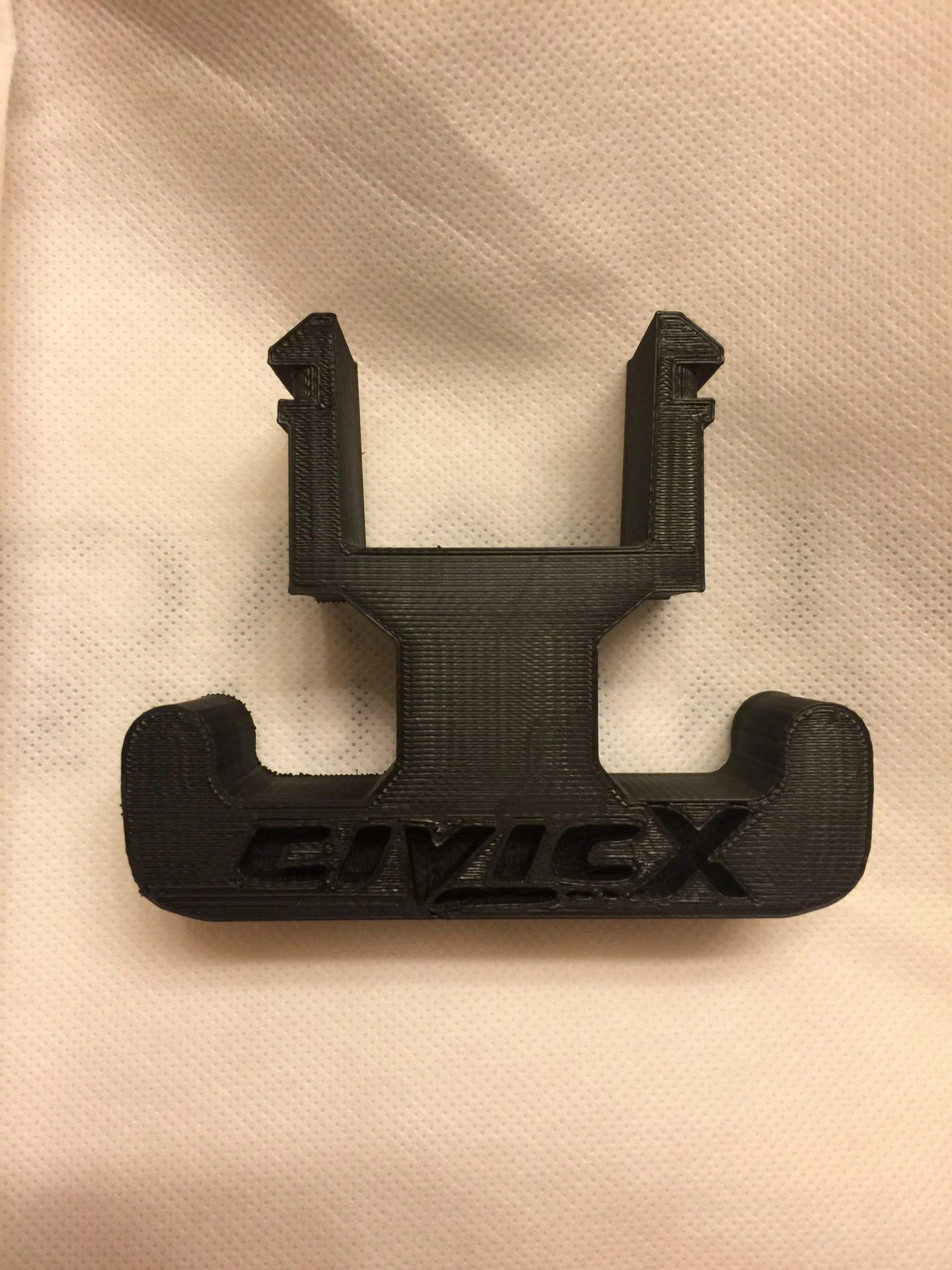

Ah no worries I have about 15 rolls of filament. I just did a quick print to see how the fitment is but ill check in the morning. I did a test at .3mm Layer height and 30% infill for a quicker print but i think it came out great and really sturdy considering its only 30% infill! Plus it only took 2 hours to print.
Honda Civic 10th gen 3D Printed Cargo Hook FullSizeRender

It fits really well, I had PLA loaded up so I don't expect it to last too long in this Arizona heat but I'll print your next one in ABS and see how it is.
Honda Civic 10th gen 3D Printed Cargo Hook ima
Looks great! I need to get out my caliper and get an accurate measurement of the width. Originally I measured it at 27mm to compensate for the rounded corners. Once I figured out how to round the corners 27mm was just a tad too small and the handle had more movement than I would like it to. It's a small change but it should make a noticeable difference.

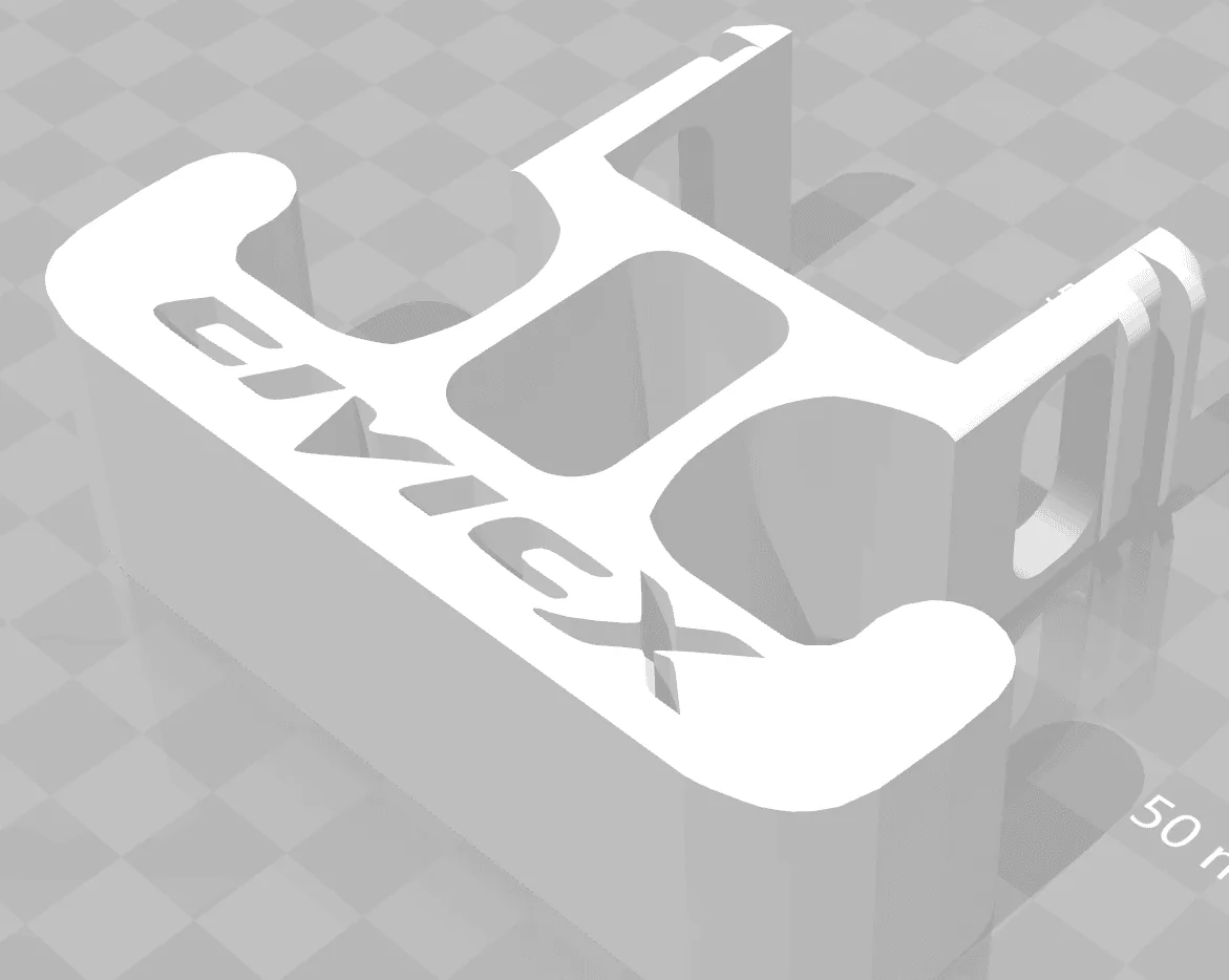

It's been a couple of years but I've updated the design to be less wasteful and install easier after a friend asked for a set

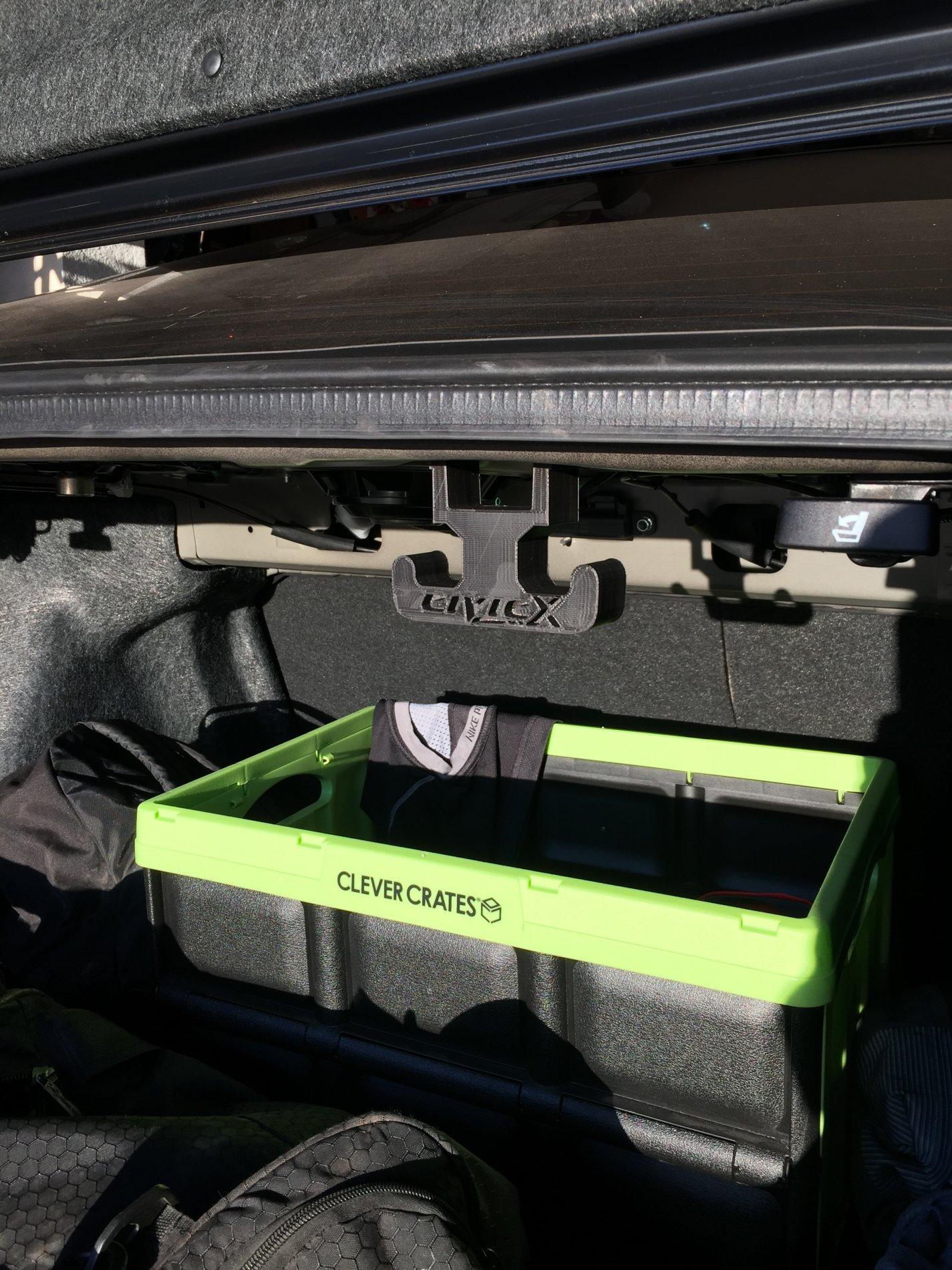

Thanks for posting the design on Thingiverse. Fits perfectly! I used PLA as that's all I have at the moment so we'll see if it stands up to the summer heat. :)
