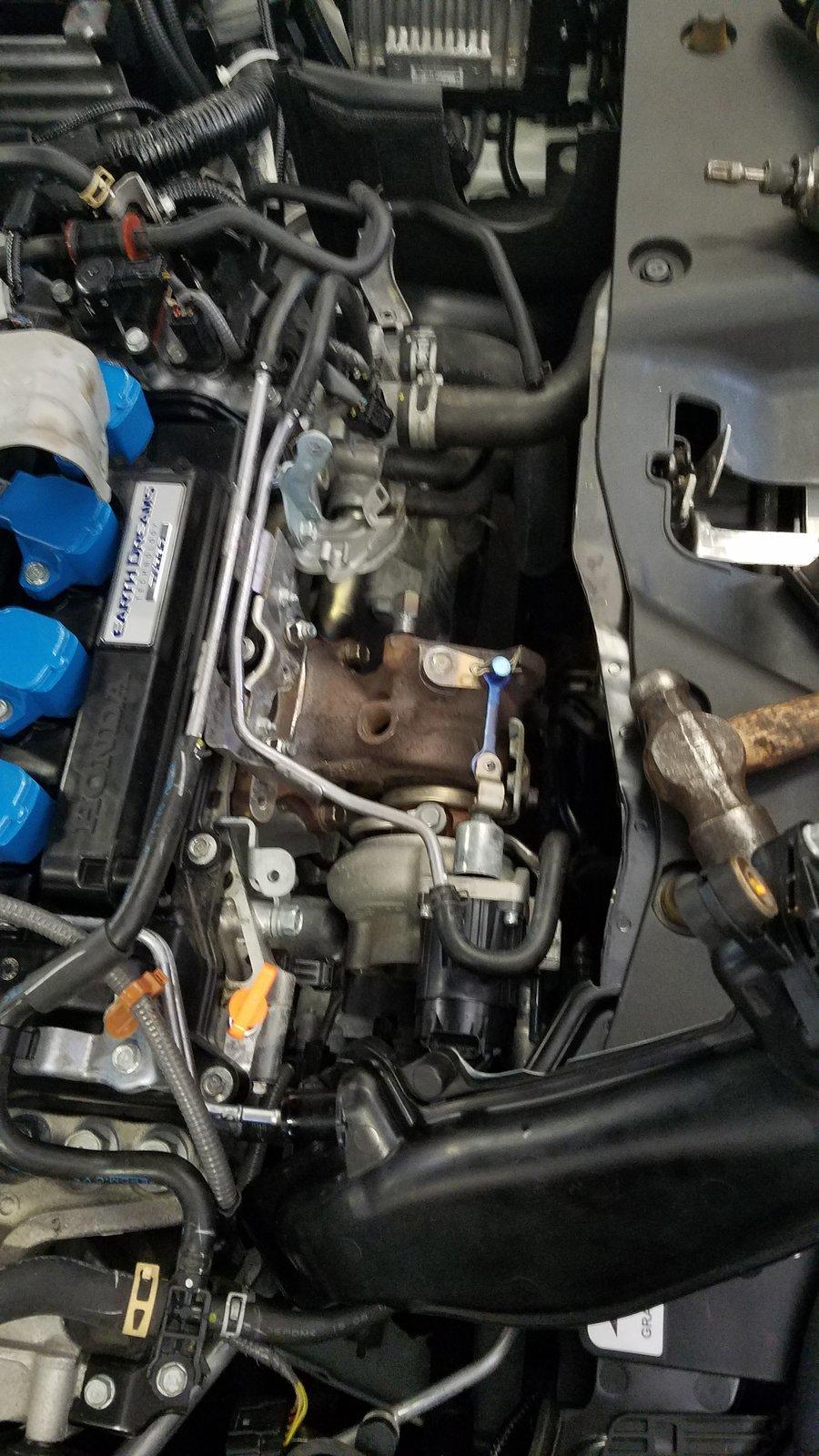

Can the inlet pipe be removed to thermal wrap it?

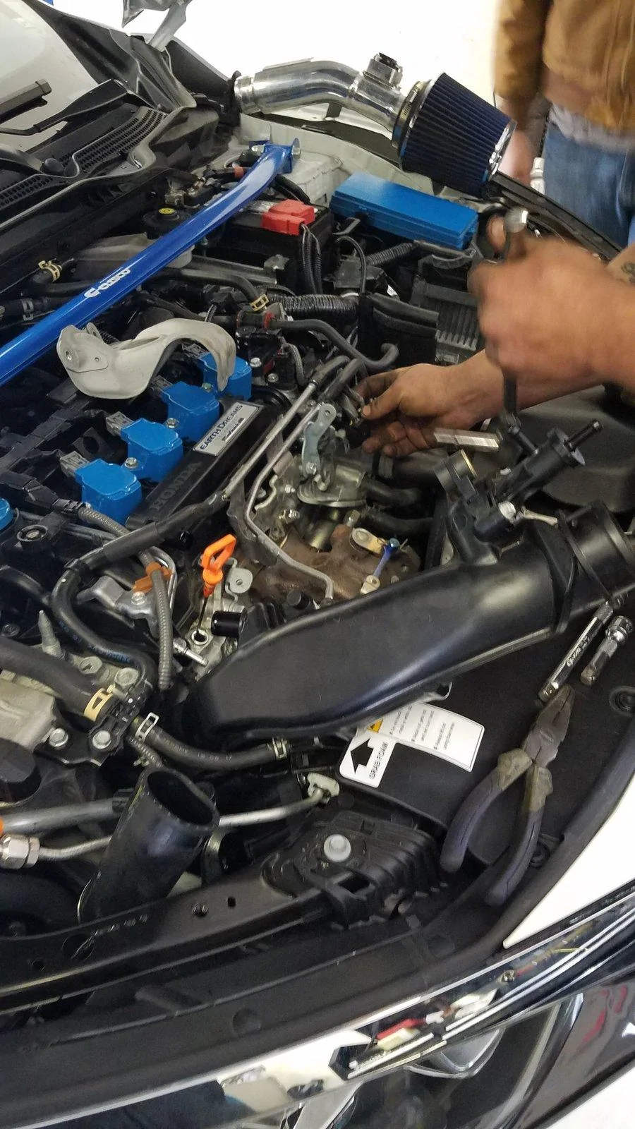

Yes. Not just that piece tho. But you would be able to wrap it. I had to take it off when I broke a bolt installing a downpipe haha. Honda Civic 10th gen Turbo inlet pipe.... 20170428_105527 Honda Civic 10th gen Turbo inlet pipe.... 20170428_105525

Yes. Not just that piece tho. But you would be able to wrap it. I had to take it off when I broke a bolt installing a downpipe haha. 20170428_105527.jpg 20170428_105525.jpg
It just lifts off the turbo after unbolting?
The BOV, or diverter if you're stock, will come off with that peice.

Thanks, I did notice an aluminum heat shield bolted to the bottom but I think wrapping it would be better....we'll see.
Thanks for the pics. I don't even own the car yet but that piece has been bothering me since day one. You are the first I know who seem to have tried to remove it or what not.
broke a a bolt on the turbo trying to remove the stock cat haha. had to pull the turbo out to drill the bolt
