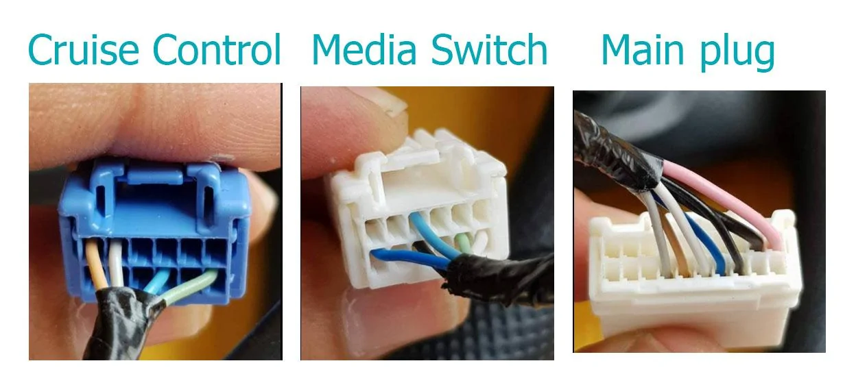

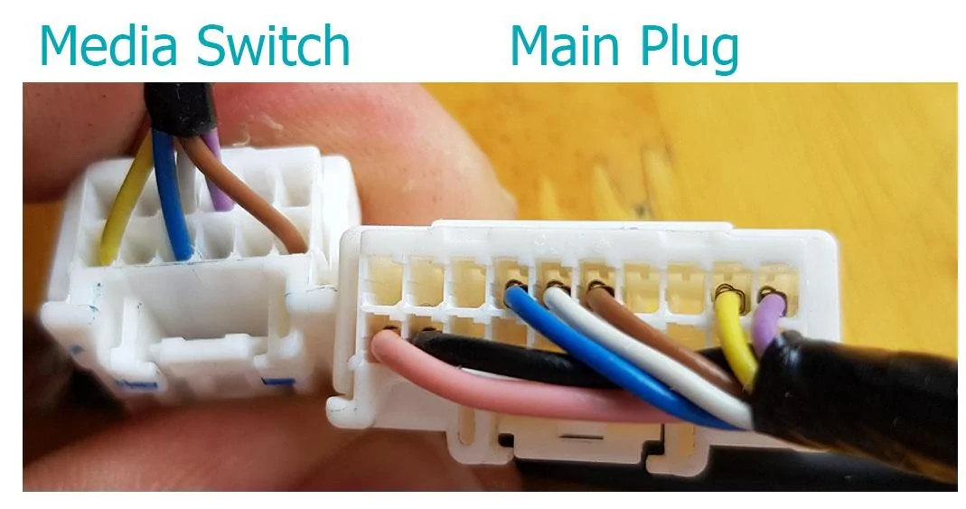

Hey guy my car civic x don't have cruise control then I buy cruise control switch and wire cable. But after I installed wire cable to media switch and cruise control can't work both. So I back to old wire cable.
Can guide me to install ? or share diagram ? Thanks.

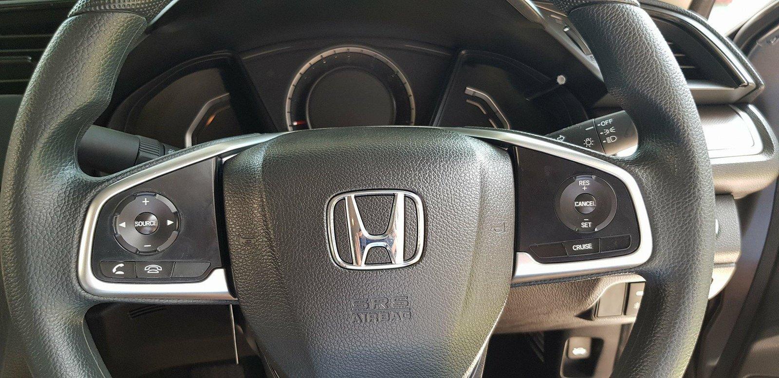

My Steering wheel after put cruise control switch.
Honda Civic 10th gen Request : Install cruise control stering wheel
New wire
Honda Civic 10th gen Request : Install cruise control new wire
Current I use Old wire. Because it' can control media switch.
Honda Civic 10th gen Request : Install cruise control old wire

dear , you dont have to change or modify wiring for ur buttons,, use old grips instead . you have to insert just wires within the grip for cruise control to be functional . here are attached diagram for your whole project. remember this is Oem method to install cruise , dont worry about the working its 100% functional, stay blessed,

Hi waqas ahmad,
today I have installed blue connect insert wires to old grip follow your guide. And light already showed in steering.
Can you show pic about 2 connector. Where are location connector B and connector cluster ?
Thanks :)
