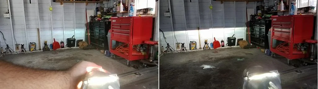

The thing about headlight discussions is: Most people don't have a wide enough frame of reference.
Are the LED lights better than the halogen H11 lamps in the non-LED versions? Yes, absolutely.
Are the LEDs good when compared to top quality lamps? Not even close.
This side-by-side of my H11 lamps vs FX-R lamps really shows the difference. This is a 5500k 35w HID in the OEM lamp vs a 5500k 55w in my FX-R. The OEM lamp is still on in the FX-R picture, but the FX-R output is completely covering it. Also, my FX-R + Morimoto HIDs isn't the best you can get. I could get more output and coverage with some Osram bulbs and different ballast.
Honda Civic 10th gen Poor headlight output - Options? 243763272572
(I need to redo this test with my DSLR one of these days)
