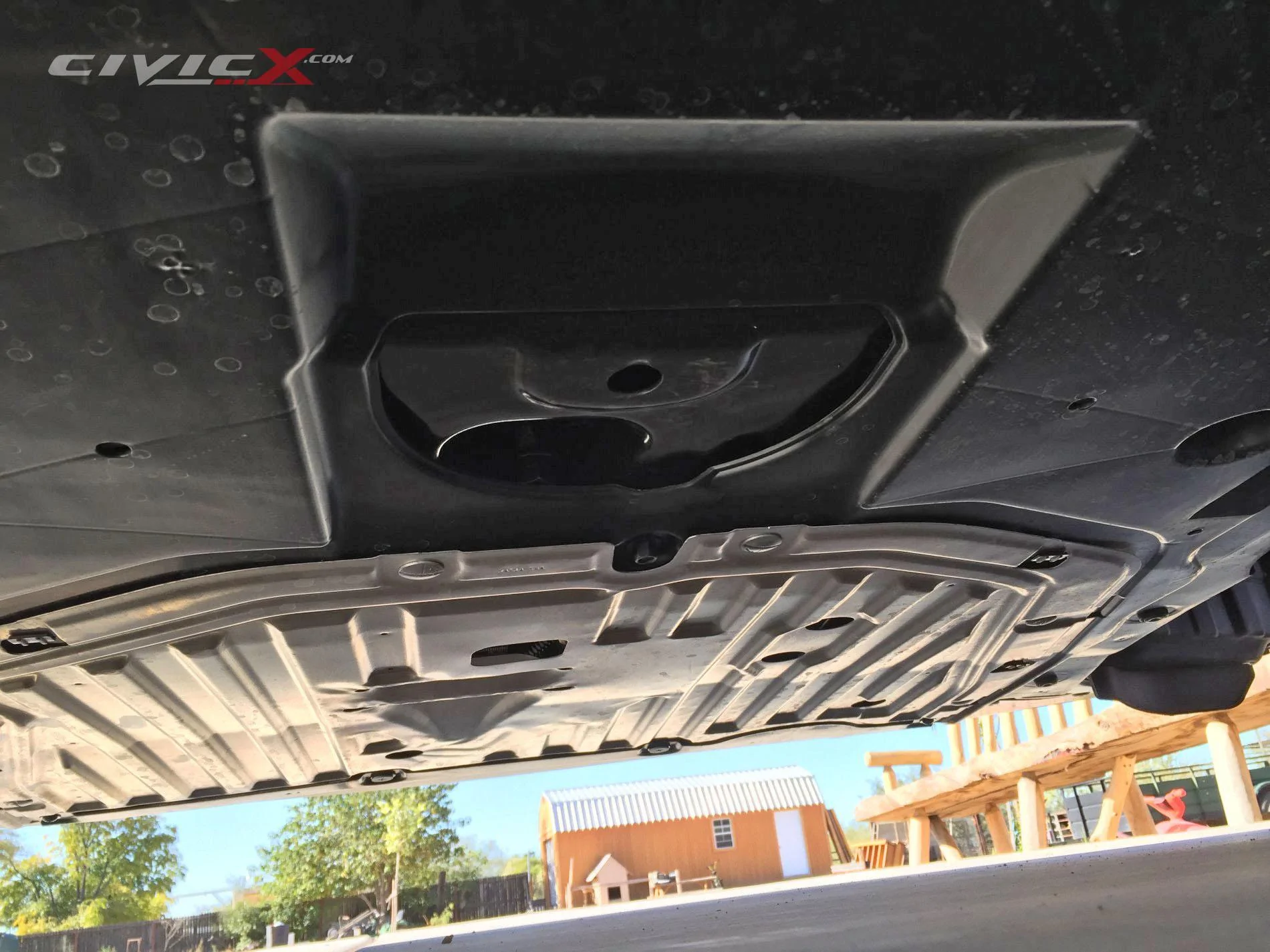

...here is the only place i think you could jack from, maybe with a bottle jack.
Yeah, that looks like a jack point. Should be able to do it with a regular hydraulic jack as well.
the problem is that its all the way in the middle of the car and a regular jack can't reach that far in. It's like under the shifter if that makes any more sense.
After searching online for hours, I’ve finally found this video which shows how to jack it up with a regular floor jack! Just watch the first minute or so. Hope this helps!

Has anyone figured out a good way to jack the front end and from where? Thanks MtheBeast for the pics, but I can't even stick my head under the car to see that far back (front the front or sides).
What I did was buy a few of the rubber anti fatigue Mats. Have like two folded over and drive over till both front tires at a higher point. That gives extra clearance to get a jack underneath to that far back lift point
