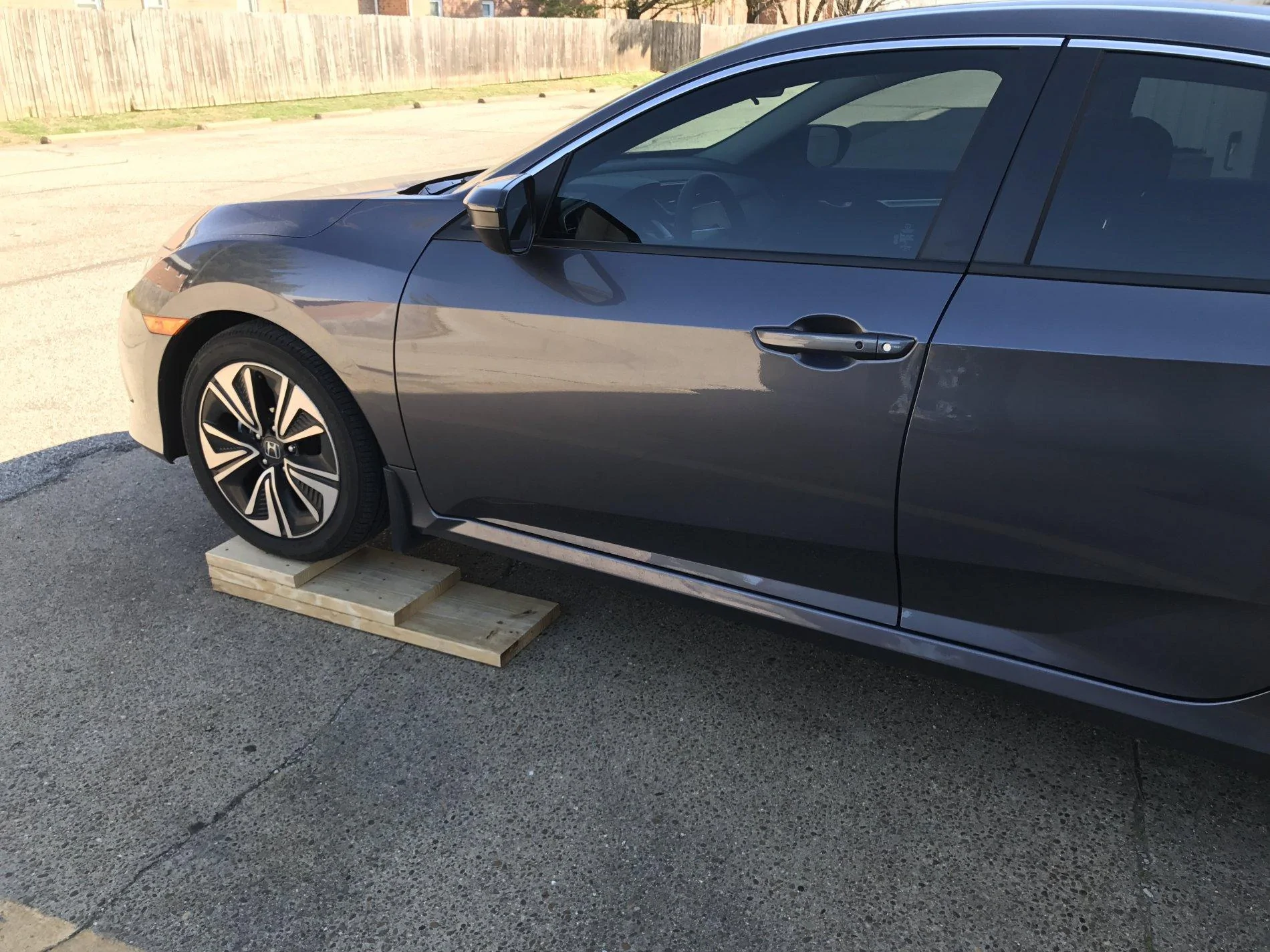

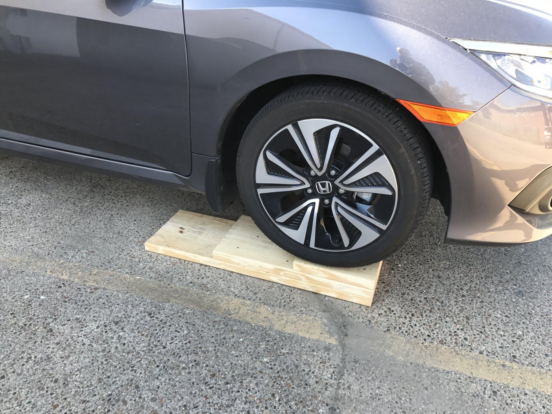

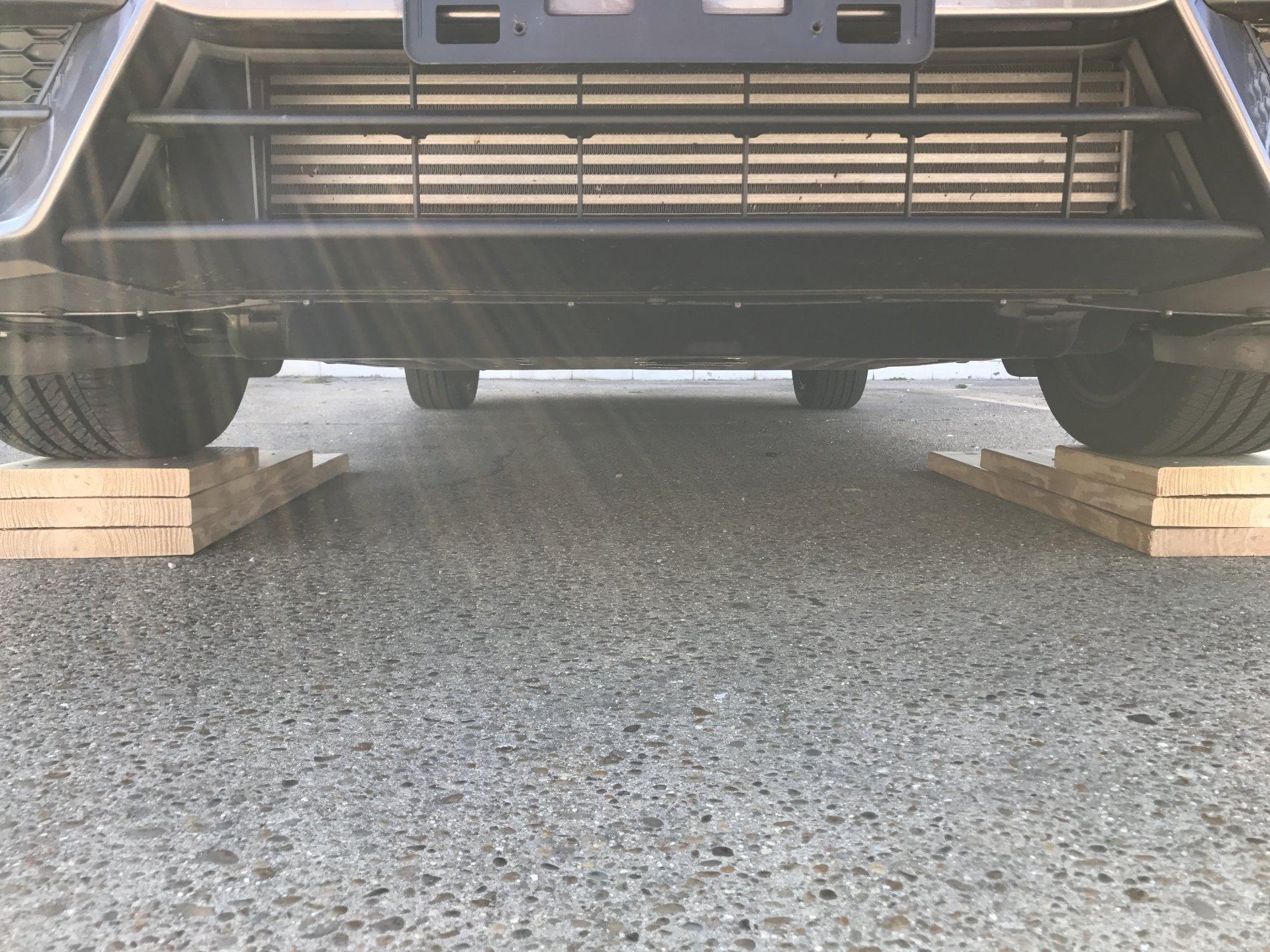

Honda Civic 10th gen Jacking up / jack point ? IMG_7177.JPG Honda Civic 10th gen Jacking up / jack point ? IMG_7178.JPG Honda Civic 10th gen Jacking up / jack point ? IMG_7179.JPG Finished the ramps I was talking about above. Turned out well and is the perfect height for oil changes. I can drive up the first step to give enough clearance for the jack so I can jack up the front end too for tire rotations. Highly recommend going this route.
