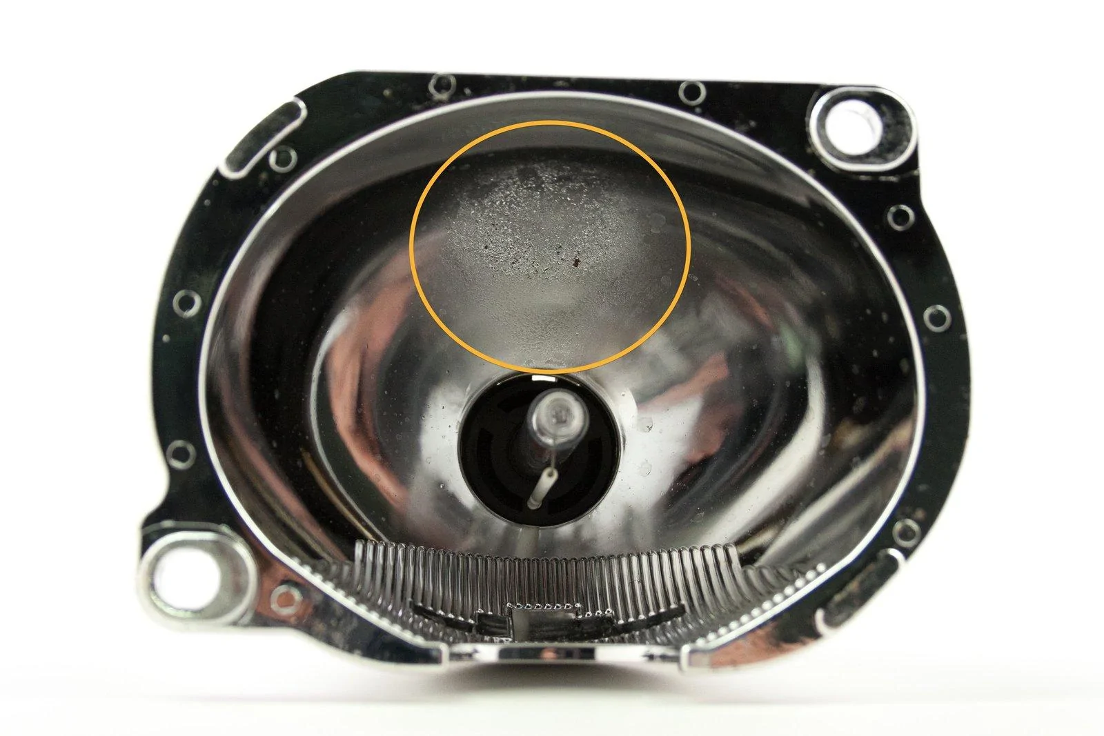

Would 55w run too hot or cause some other problems? With the 35w, is down the road lighting pretty good? Debating vetter LED's (currently have hikarilow beams) or HID's
55w have a tendency to burn the reflector housing on halogen lamps more than 35w kits do. When you get a lamp designed for HID that isn't an issue.
