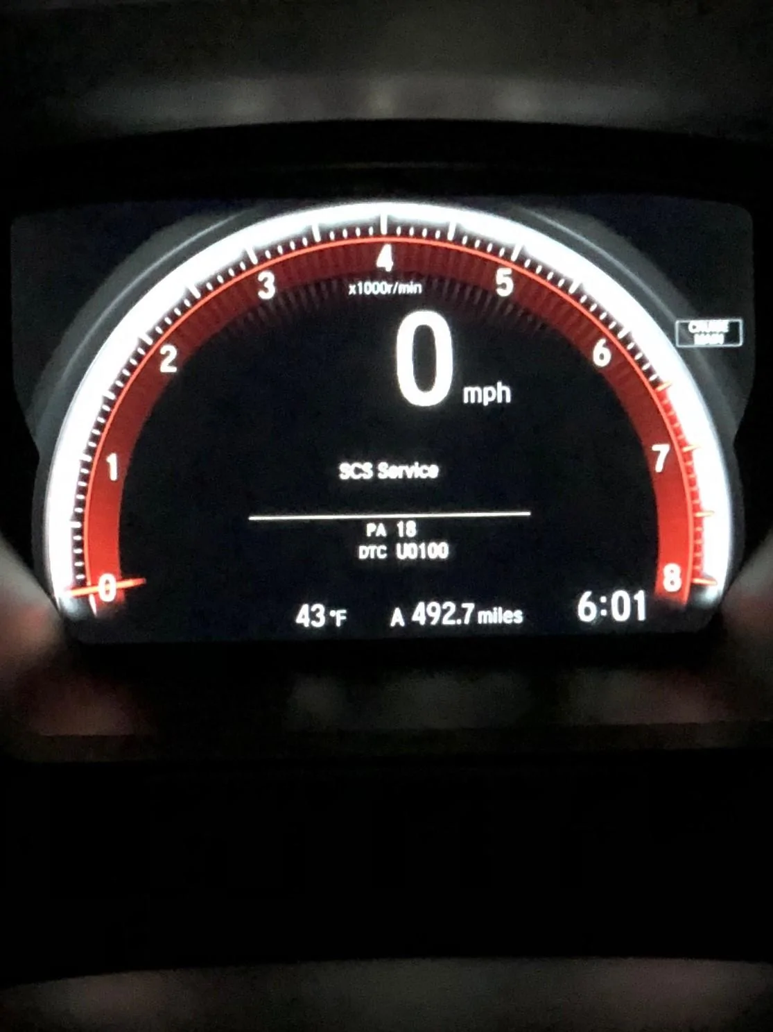

Here's is what I sent to Hondata just moments ago:
I recently picked up a FlashPro for my si and have ran into some issues since flashing it. I uploaded the +6 psi w/ fts calibration on Friday without issues. Now, ever since flashing it, I get the attached image on my dash whenever plugging the FlashPro in by itself (NOT connected to a computer). Also, when plugged into my computer and vehicle, FlashPro Manager does not detect an OBDII or ECU connection. Every now and then I get it to detect, but it sometimes randomly goes away. I'd just like to note that that all software is up to date.
Now I am at the point where I just want to return it to stock, but am afraid to do so since the connection might get interrupted during the flash. I am also slightly worried that the flash somehow got messed up, because in normal mode during WOT, it builds boost but then drops down to 10 psi and doesn't really go over that. And unfortunately with my situation of the FlashPro not detecting the ECU, I am unable to datalog to make sure everything is running smoothly.
Has anyone experienced anything like this before?

Problem solved! So I would randomly try plugging the FlashPro into the vehicle, and at random times it would connect. So, thinking it was a connection issue, I started moving around all the cables. The only one that made a difference was the OBDII cable where it entered the unit. I then opened up the FlashPro to see if there was anything I could do, and found the cable was only half plugged in to the unit. So just like that, problem solved!
Thank you everyone who tried to help. I'd also like to give a shout-out to ProCivic for PM'ing me to check in on how things were going, even when the product was not purchased from them.
