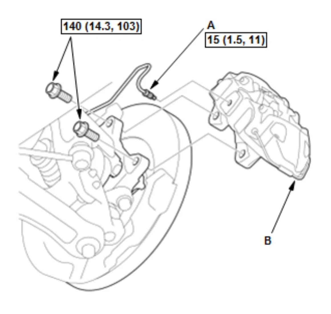

Hello everyone, by any chance would any of you know the front brembo caliper mounting bolts torque spec on an FK8? I ordered a brand new left front caliper due to damaging the caliper connecting/crossover pipe and apparently the dealership does not sell that caliper crossover pipe separately and the caliper would have to be replaced with a new one. Please let me know. Thanks

103ft lbs.
