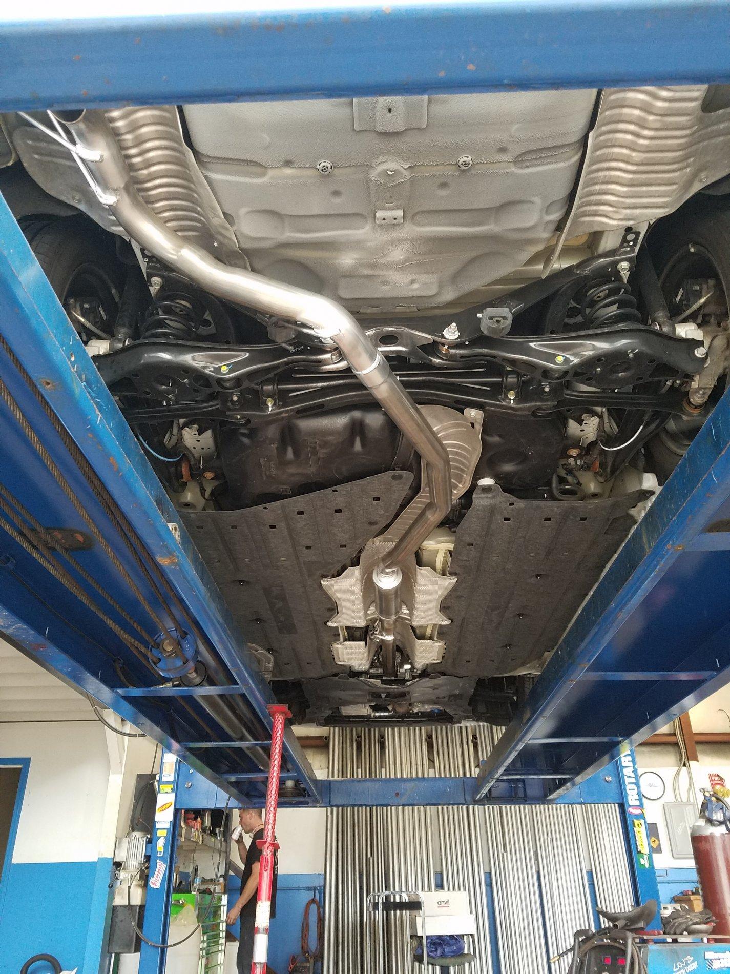

that exhaust looks pretty low, does it drag on things?
Honda Civic 10th gen Exhuast project 20160910_150704
Lowest point for the exhuast is where it's crossing the gas tank. but i haven't had a scraping issue yet.

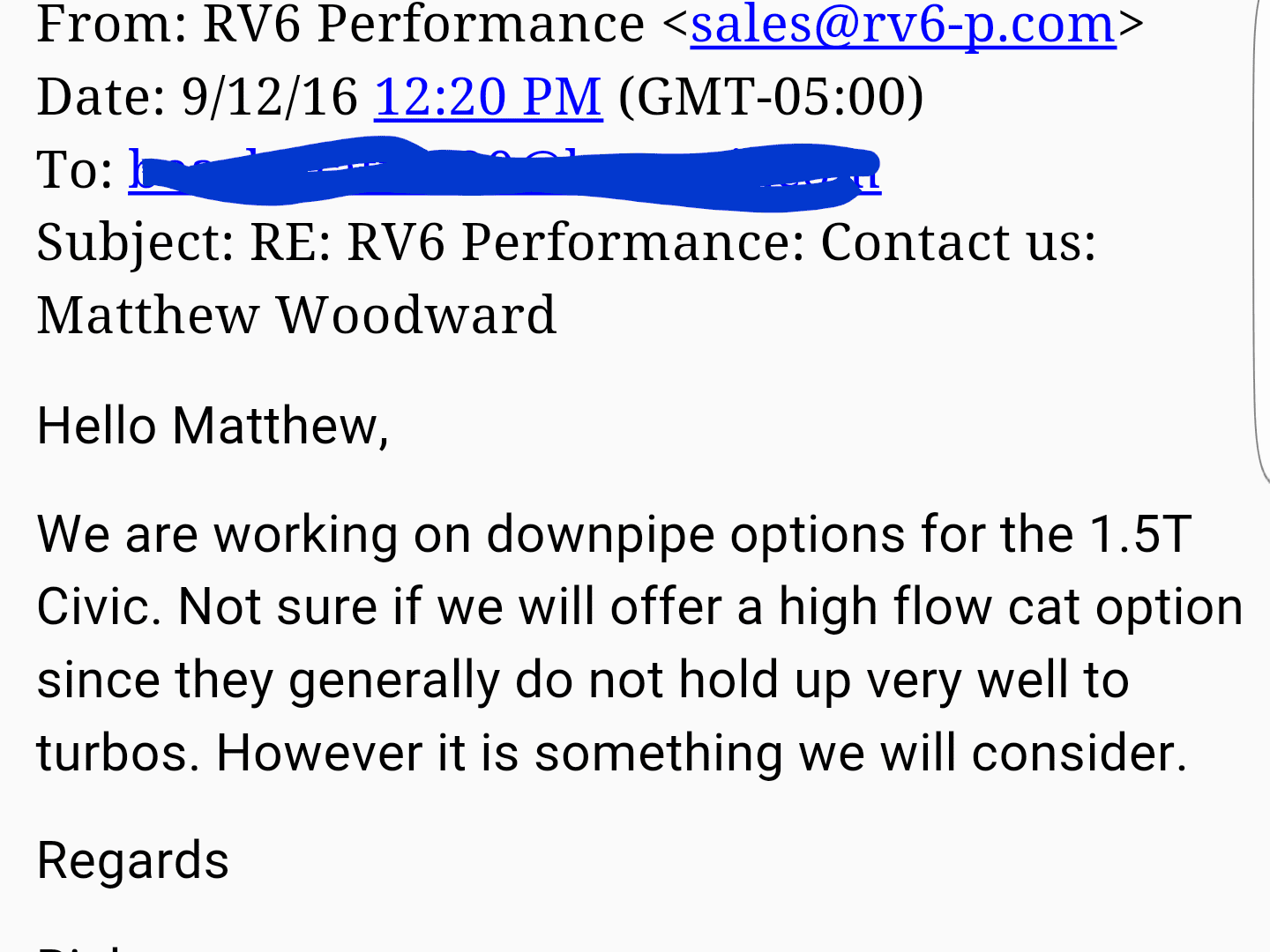

what should the diameter be for a universal high-flow cat? I don't plan to mod the rest of the exhaust.
From my conversation with RV6 performance. They believe that a high flow will be blown out by the turbo. but they will have a CAT delete option around the beginning of next year

But you're replacing a cat with another cat. A high flow cat shouldn't be damaged unless you buy a cheap one that is poorly made. There are much more powerful cars that use high-flows

This was the email

hmmm...every production turbo car in the world comes with a cat, and we have a 1.5L engine. I'm not concerned. I just wanted to know the size.
The issue is heat, and not all cats are the same. A high flow 200 cell metallic racing cat will not hold up to the increased heat, especially when it is mounted so ridiculously close to the turbo. A OEM ceramic core 3-way catalyst has more heat-resistant material built into it, so it can withstand the heat, but is more restrictive.
That is the problem.
Relocate the cat under the car and it will be fine.

That makes sense. I guess I still need a straightpipe and a high flow cat right after it.

made some changes xD

finally someone with a proper exhaust! not just random fart can hanging at the bottom
any dragging issues yet?
I love it. And haha yah no fart cannons. And no dragging issues yet. I'll get a sound clip tomorrow
