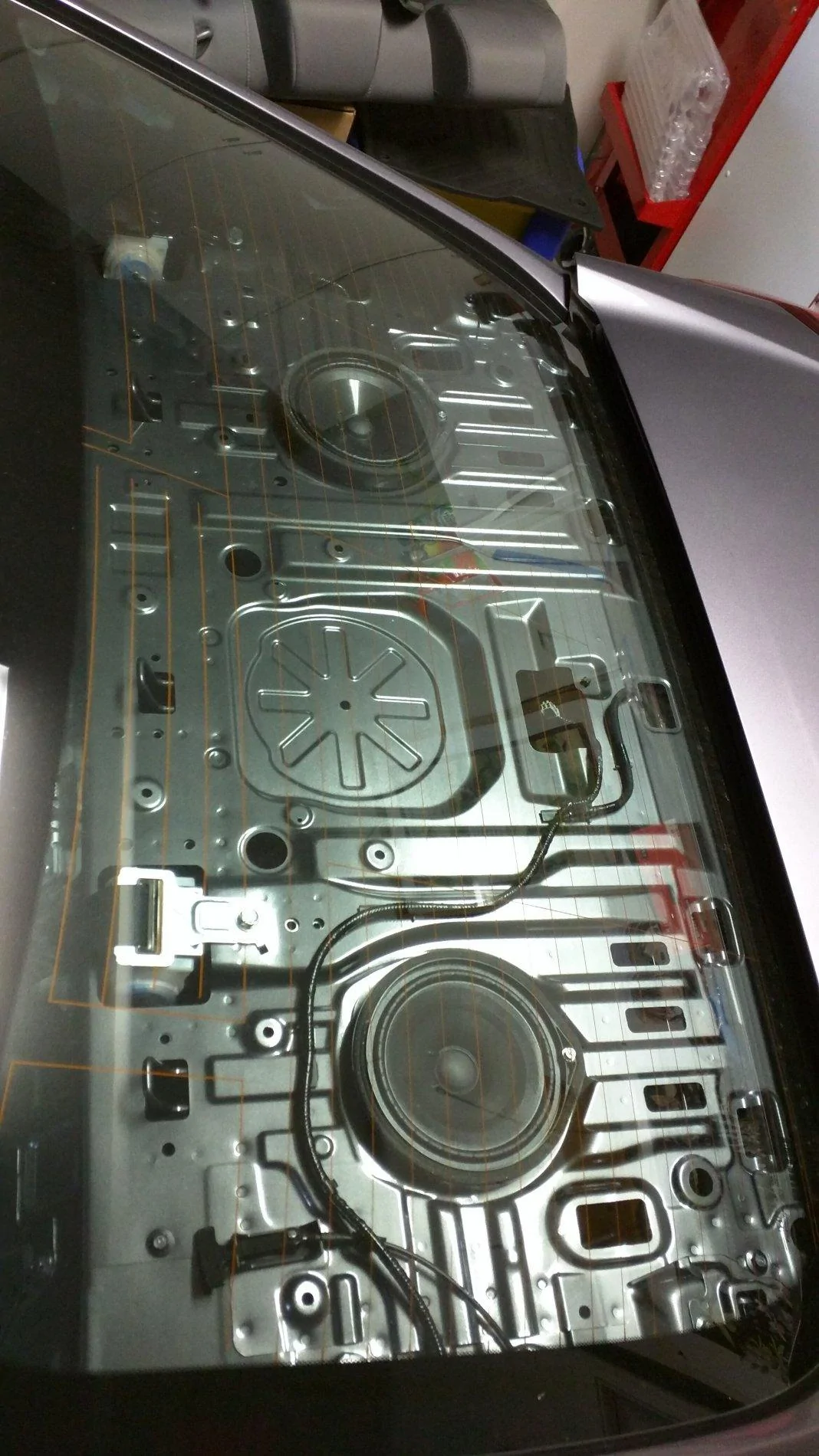

The rear decks on the LX and EX without the subwoofer are solid, so you would have to do some cutting in order to mount a sub back there. Honda Civic 10th gen EX-T subwoofer install??? IMG_20160228_173453

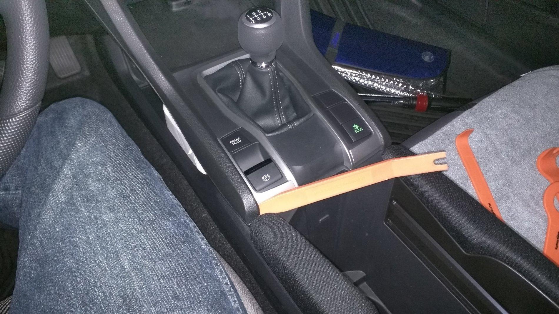

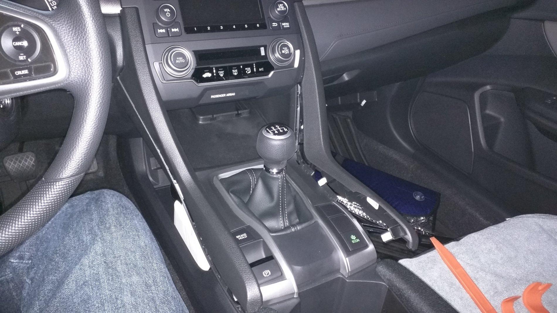

It's actually pretty easy to remove the head unit. Just use a plastic panel removal tool to remove the side panels on the console. Honda Civic 10th gen EX-T subwoofer install??? IMG_20160305_171326 Honda Civic 10th gen EX-T subwoofer install??? IMG_20160305_172025

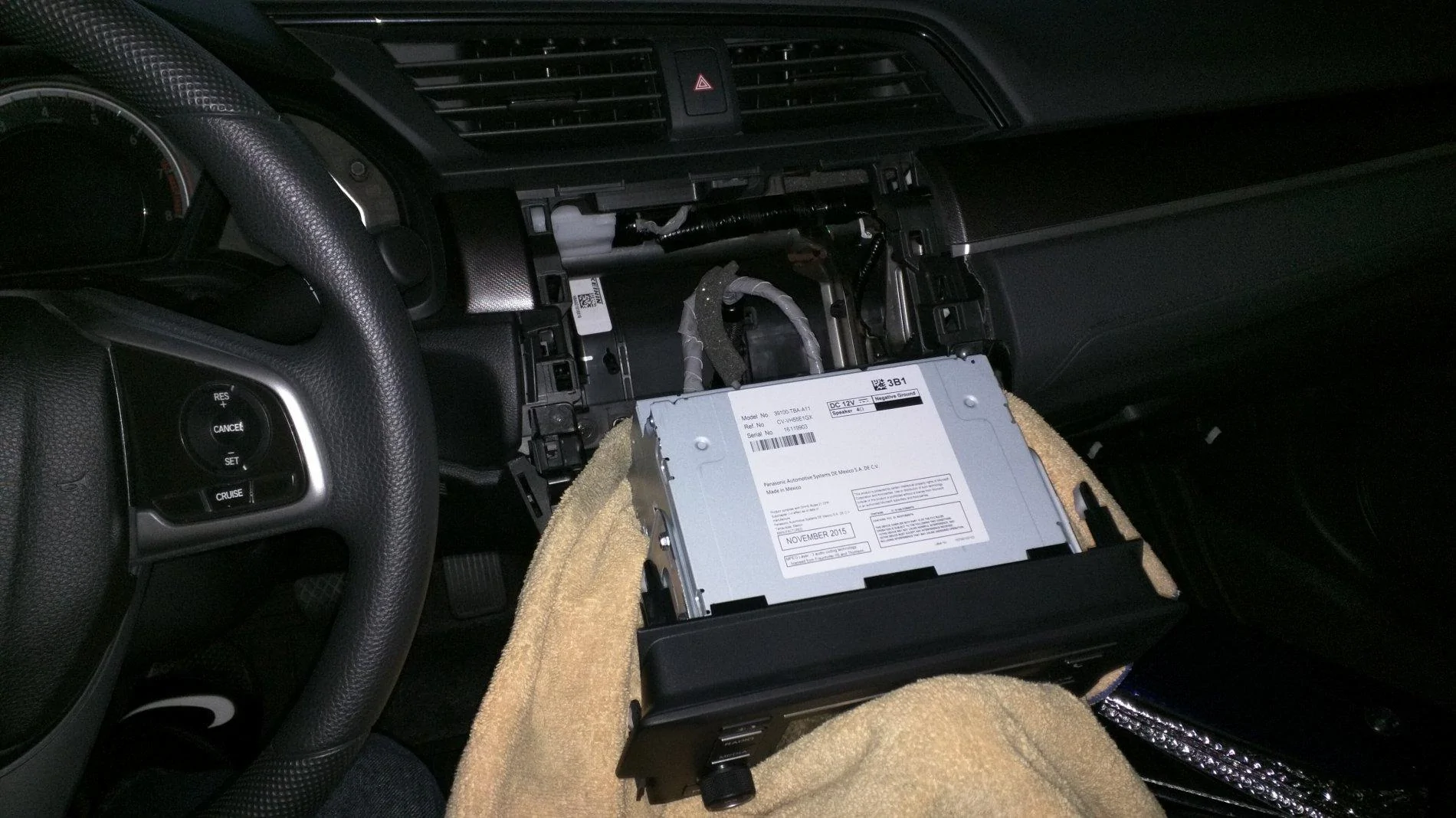

After you have those off, the HVAC control panel just pops off. Then you remove one screw on each side of the radio and the rest is just clips holding it in. You can reach under the head unit and give it a firm tug to remove it. Honda Civic 10th gen EX-T subwoofer install??? IMG_20160305_174522
