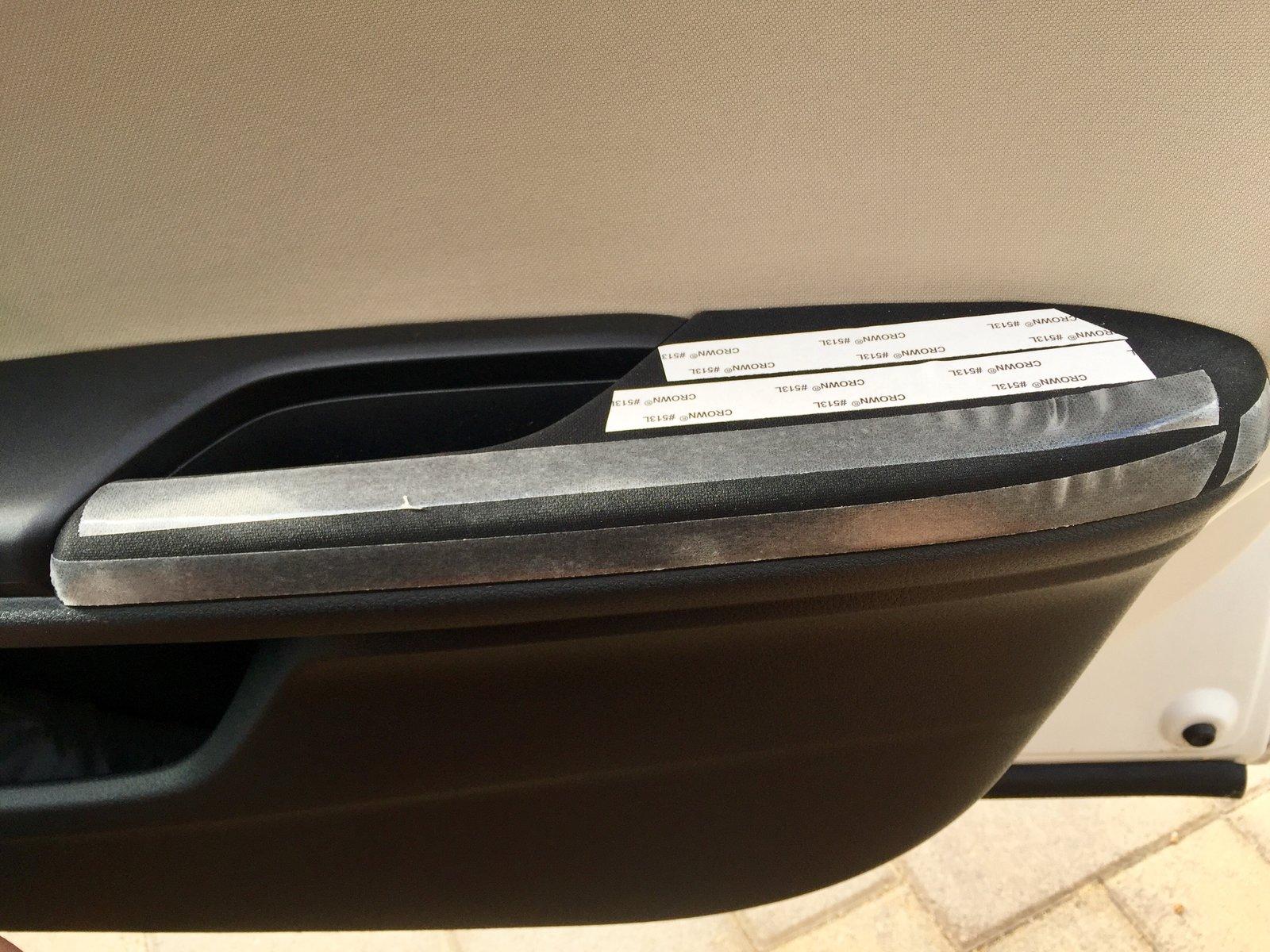

1. Start by taping the arm rest with the supplied double sided tape.
2. Dry fit the leather cover first so you know how its going to be applied.
Honda Civic 10th gen Ebay PU leather arm rest covers over cloth (install) IMG_E3942.JPG

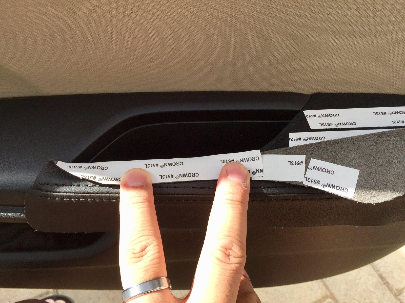

3. Peel the first two strips closes to you to apply the leather cover.
Honda Civic 10th gen Ebay PU leather arm rest covers over cloth (install) IMG_E3943.JPG

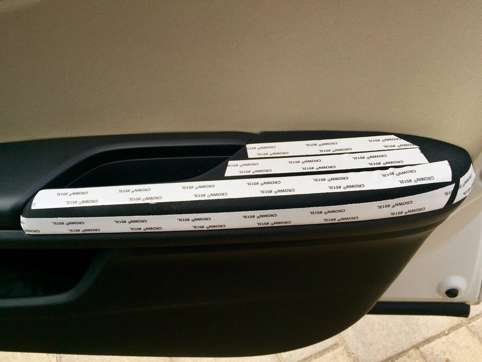

5. Apply double sided tape all the way to the edge of the leather. This portion will also be tucked using the angled tool.
6. Start tucking the leather underneath the arm rest and tuck in between the crevices.
Honda Civic 10th gen Ebay PU leather arm rest covers over cloth (install) IMG_E3946.JPG

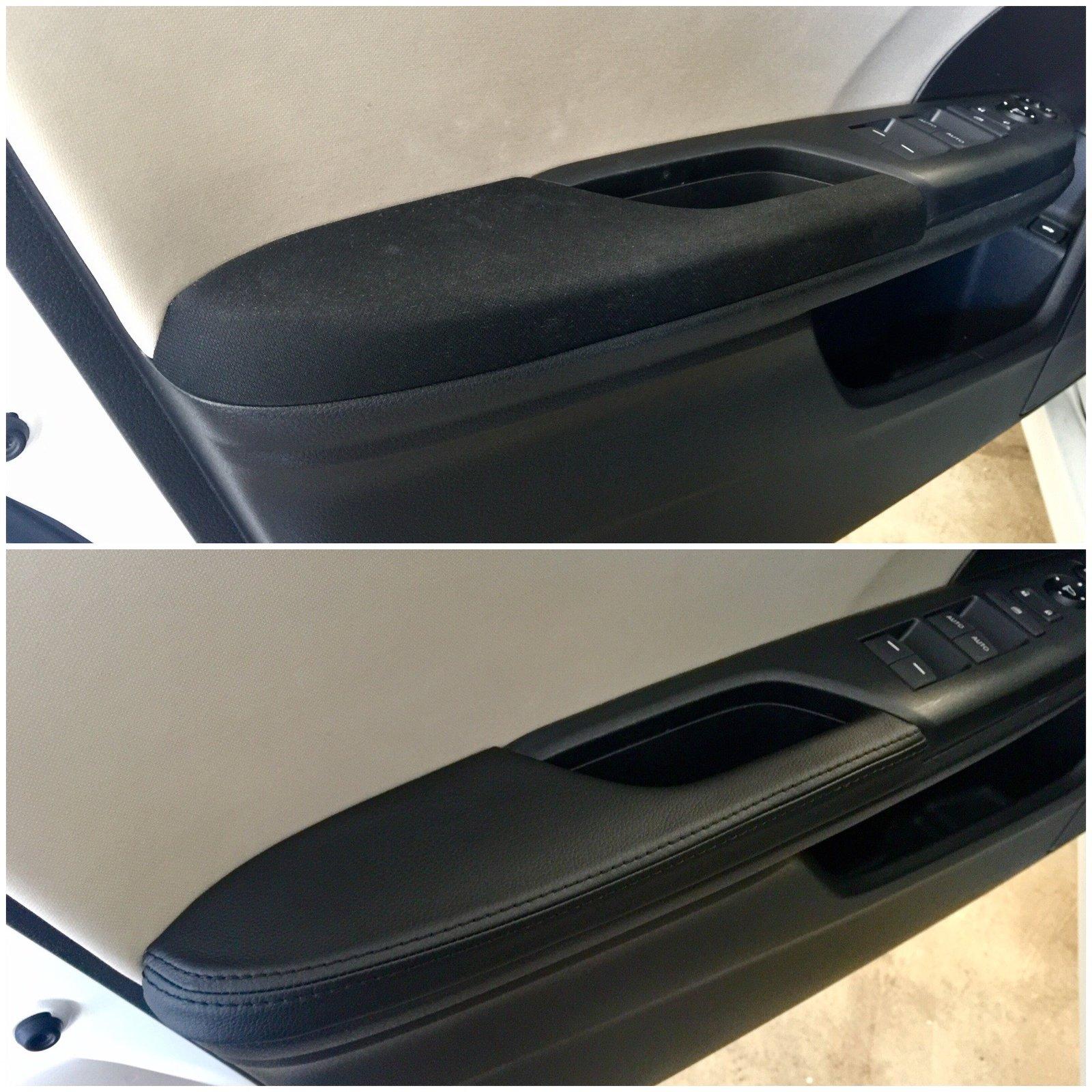

Before and After Front
Honda Civic 10th gen Ebay PU leather arm rest covers over cloth (install) IMG_3937.JPG

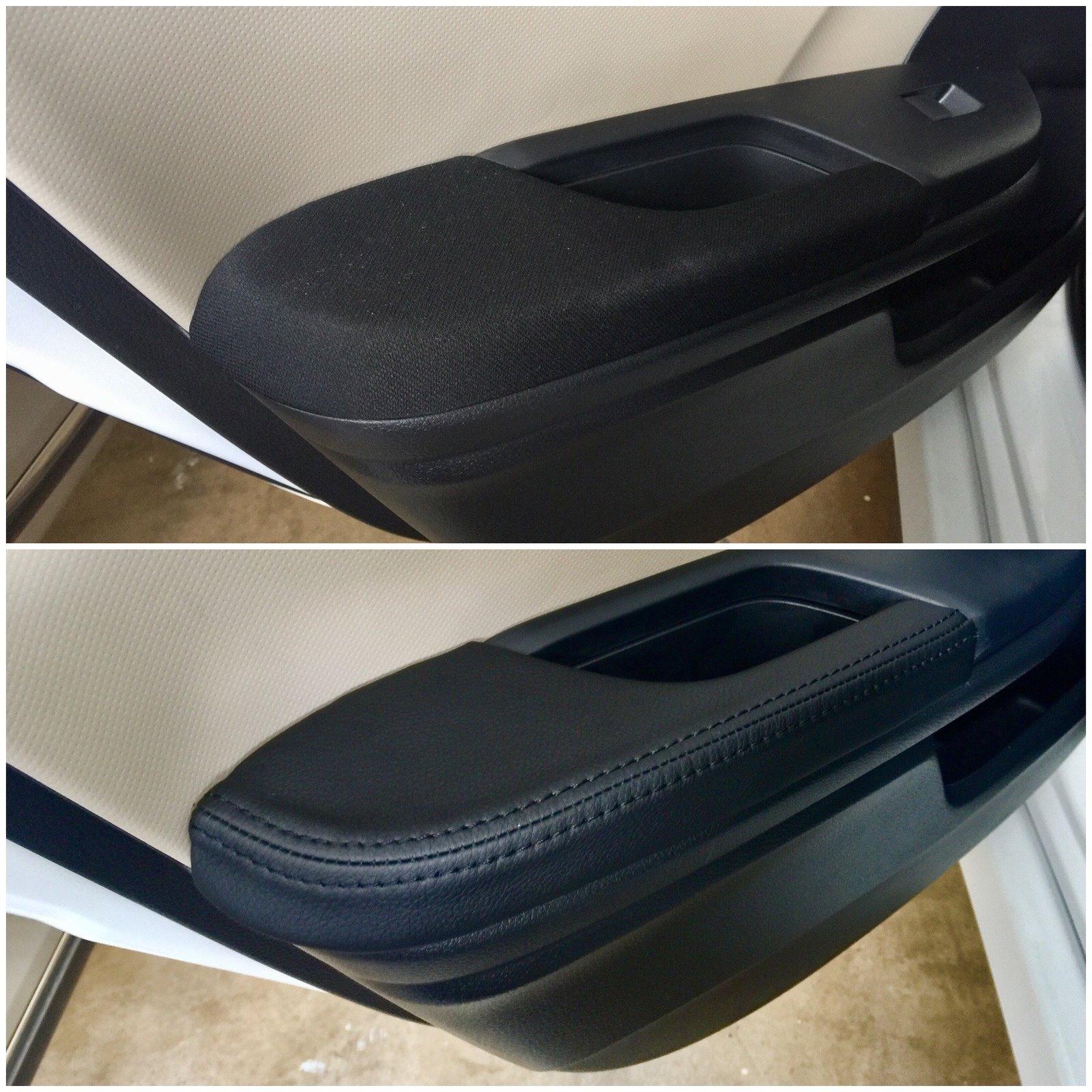

Before and After Rear
Honda Civic 10th gen Ebay PU leather arm rest covers over cloth (install) IMG_3936.JPG

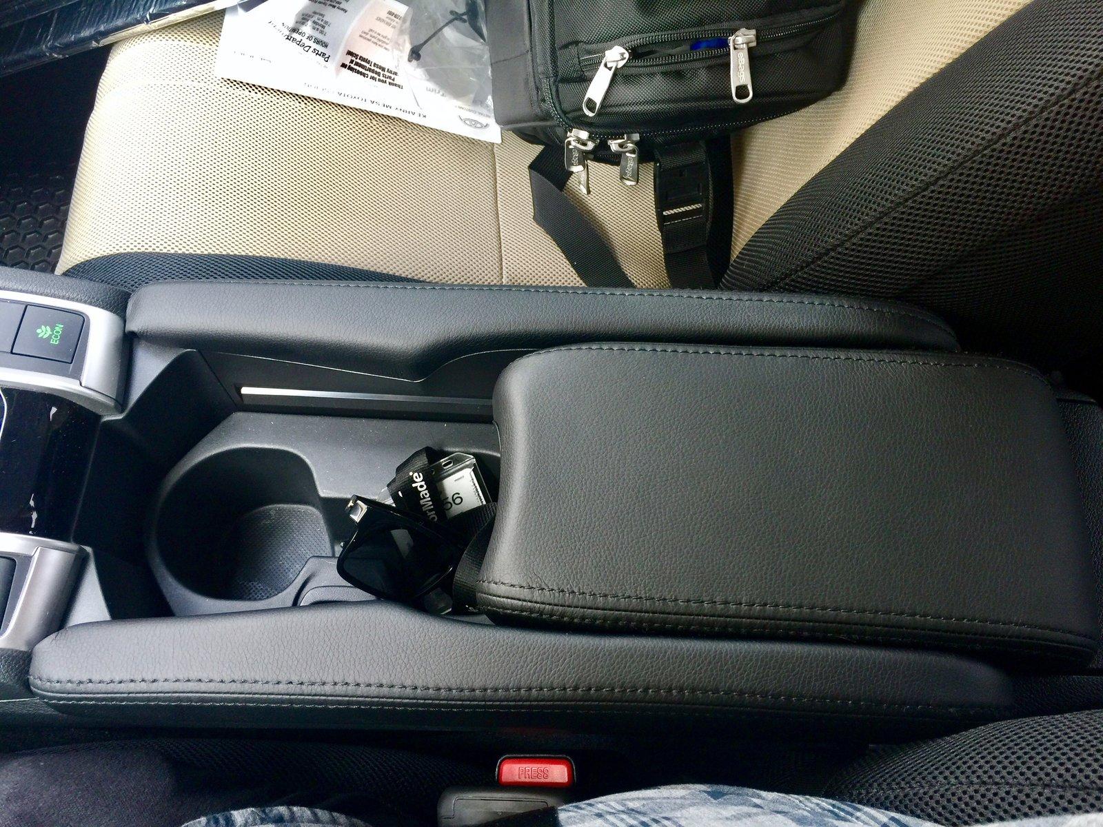

Also did the same type of kit for the center console:
Honda Civic 10th gen Ebay PU leather arm rest covers over cloth (install) centerconsole

For the center console, you're removing the side pieces and the center console itself.
Take a look at this thread to see how to remove it: http://www.civicx.com/threads/upgrading-from-cloth-to-leather-trim.12576/
The sides pop up with no tools. The center, you'll need to remove the back plastic cover with a pry tool. Then you'll need to remove the retaining "c" clip off the rod, and a screw driver to remove the rod. Should take you 5 minutes at the most to remove the 3 pieces. Once it's off, dry fit the pieces and use tape on all sides and top and bottom. Keep the stitching of the leather on the corners/edge and everything will line up. Be sure to fold the side pieces as seen here circled in green.
Honda Civic 10th gen Ebay PU leather arm rest covers over cloth (install) centerconsole2
