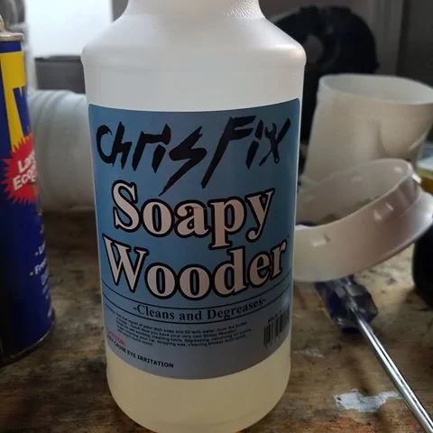

That looks like a good video - thanks for sharing. Once I got past the thick Philly accent in a stretch where he said "water" like 20 times in a minute, it was smooth sailing. Should be helpful in doing this!

ChrisFix is awesome. I watch him even tho I know how to do all that stuff already lol
It's a well done video, and I appreciate that he goes into the additional explanation as to why this is important. More than just being able to do these things, I like being able to understand what's going on, and it helps for that.
