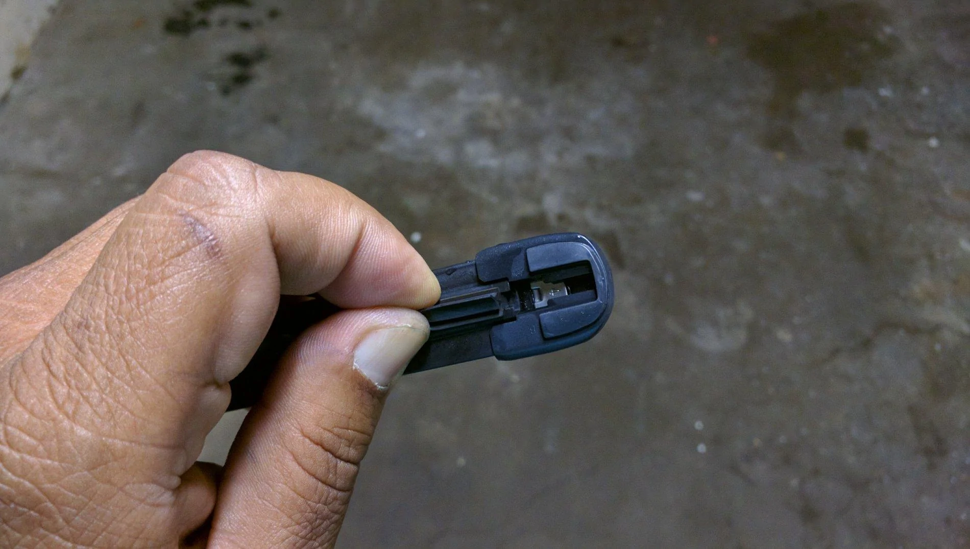

The first step is to remove the blade from the wiper arm so that it's easier to work on. You remove it just like you would with any universal blade. You pull up the arm, flip up the blade, press on the tab, and pull out the blade. I took a picture of the basic process, though I couldn't get the phone to focus on the right place.

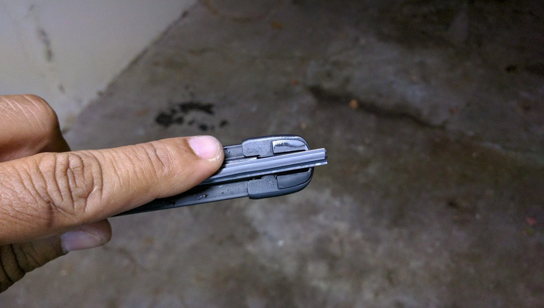

Once you get the blade out you pull the rubber insert back from the edge

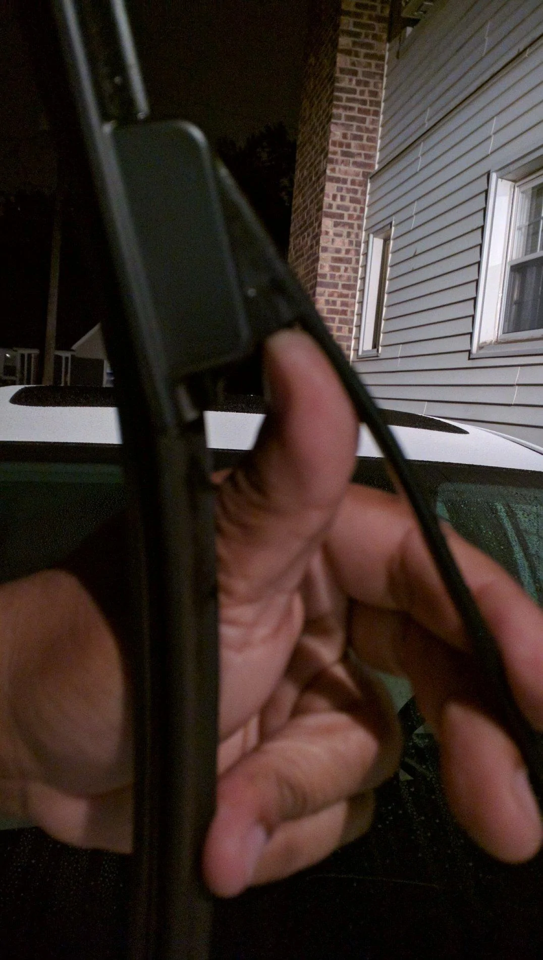

Then you pull the rubber insert up and out. It pulls out pretty easily. Once it's removed you insert the replacement

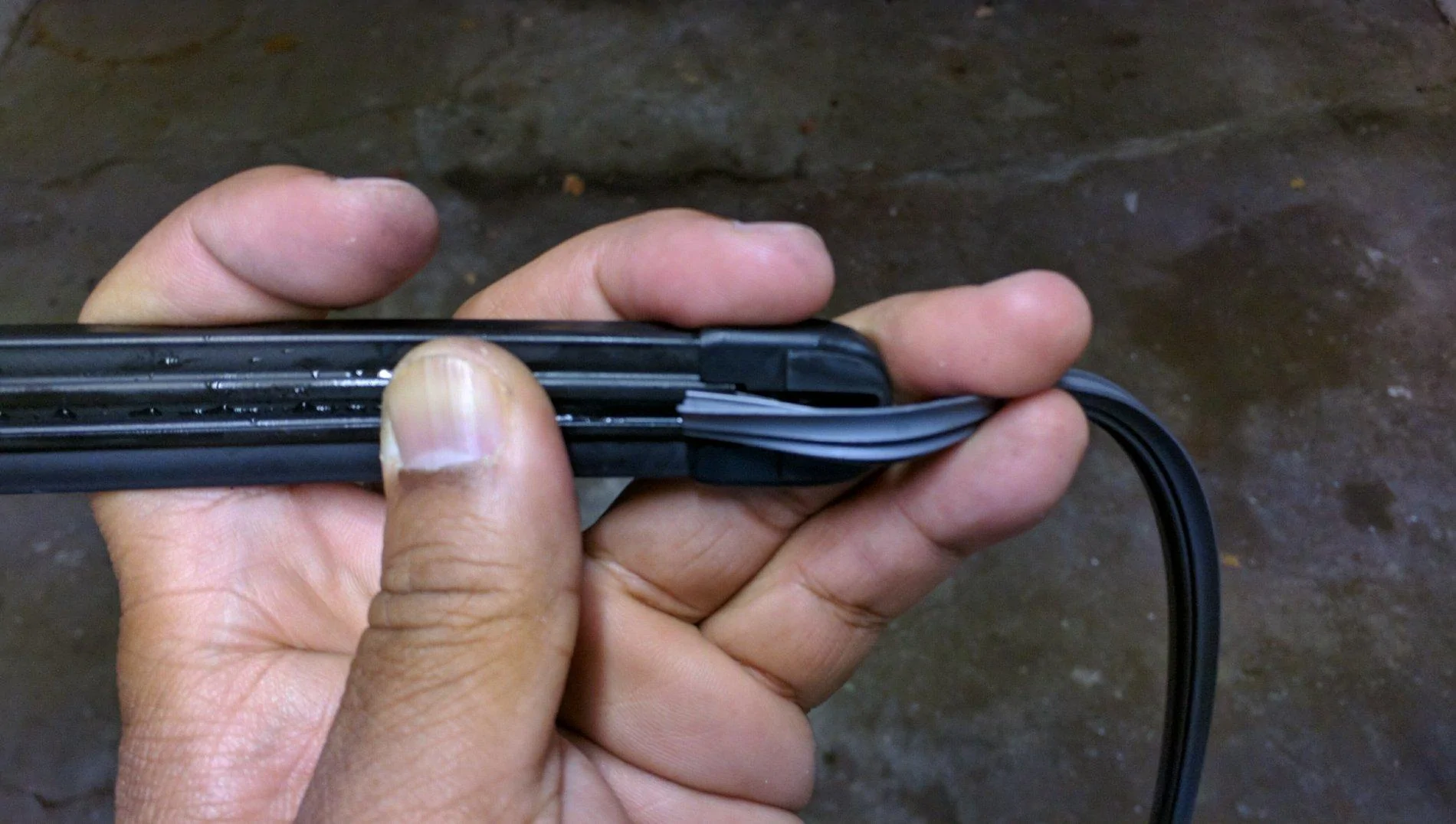

You pull the insert all the way in

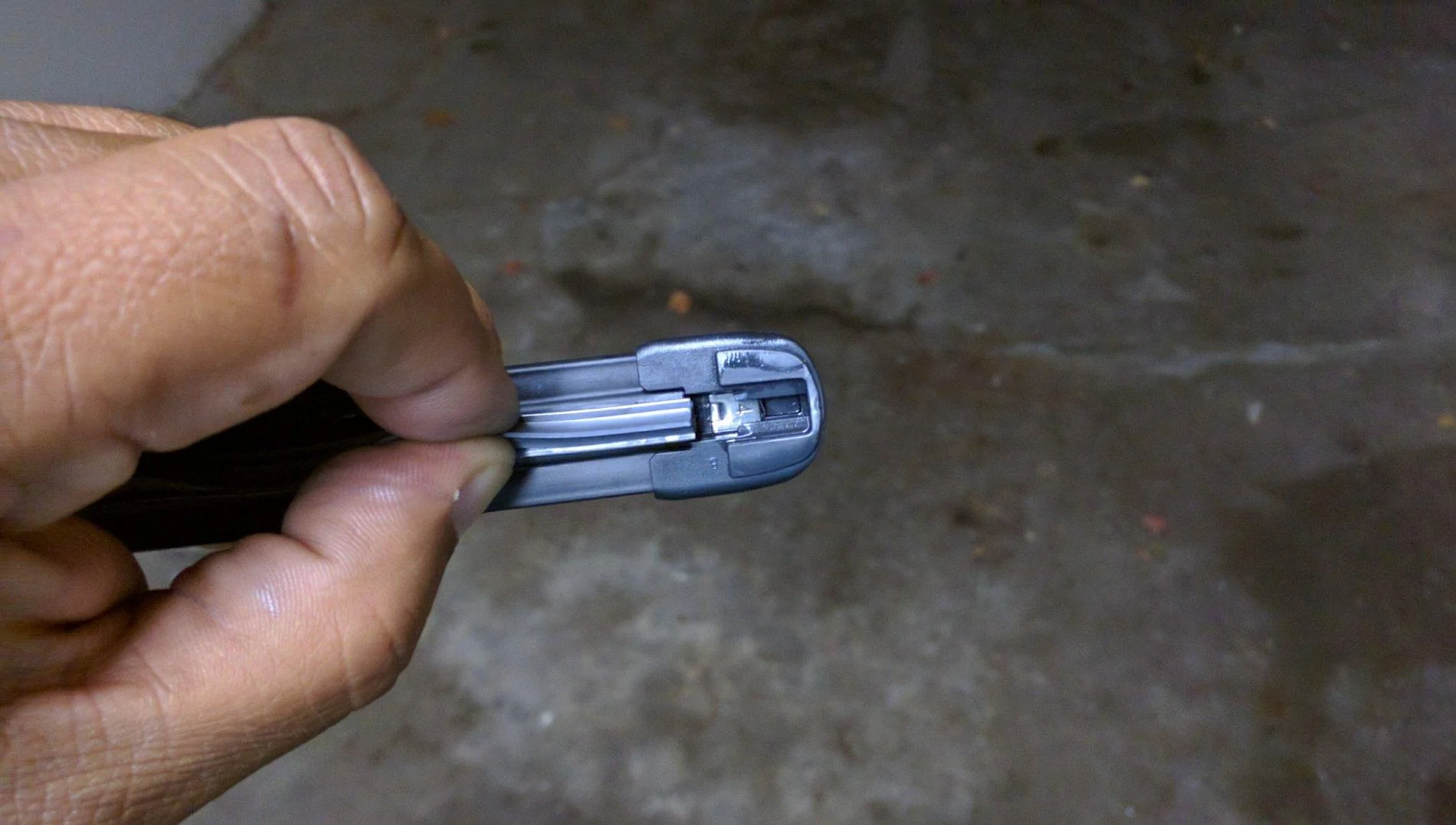

Then you keep pushing it in so it's a bit compressed
Honda Civic 10th gen DIY: Replacing wiper blade inserts IMG_20161001_022421
Finally you slide the rest into the edge of the blade and put it back on the arm.
