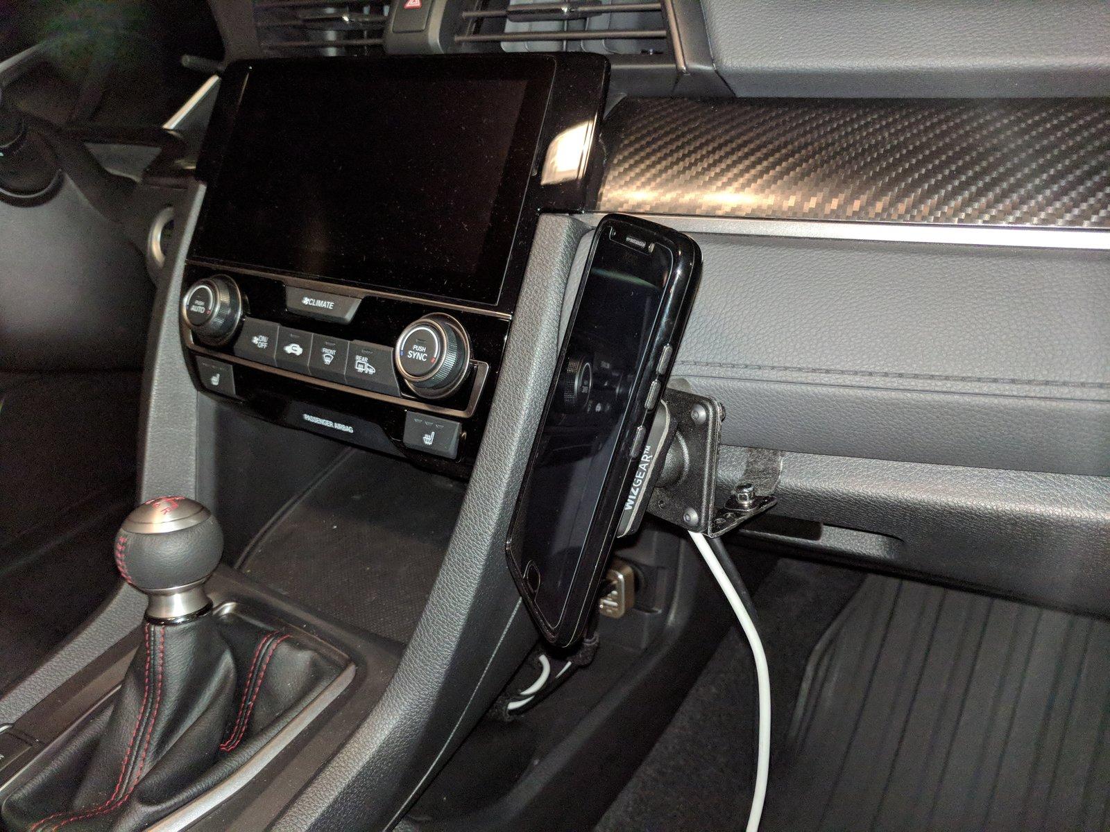

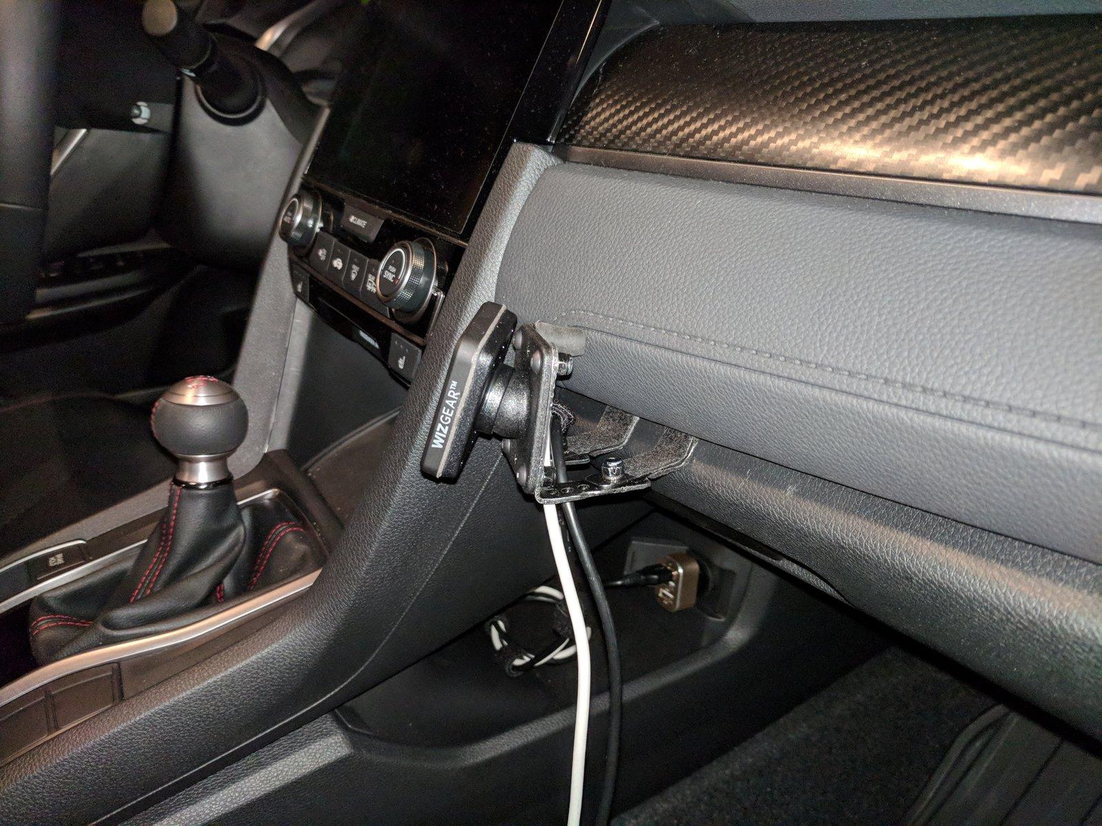

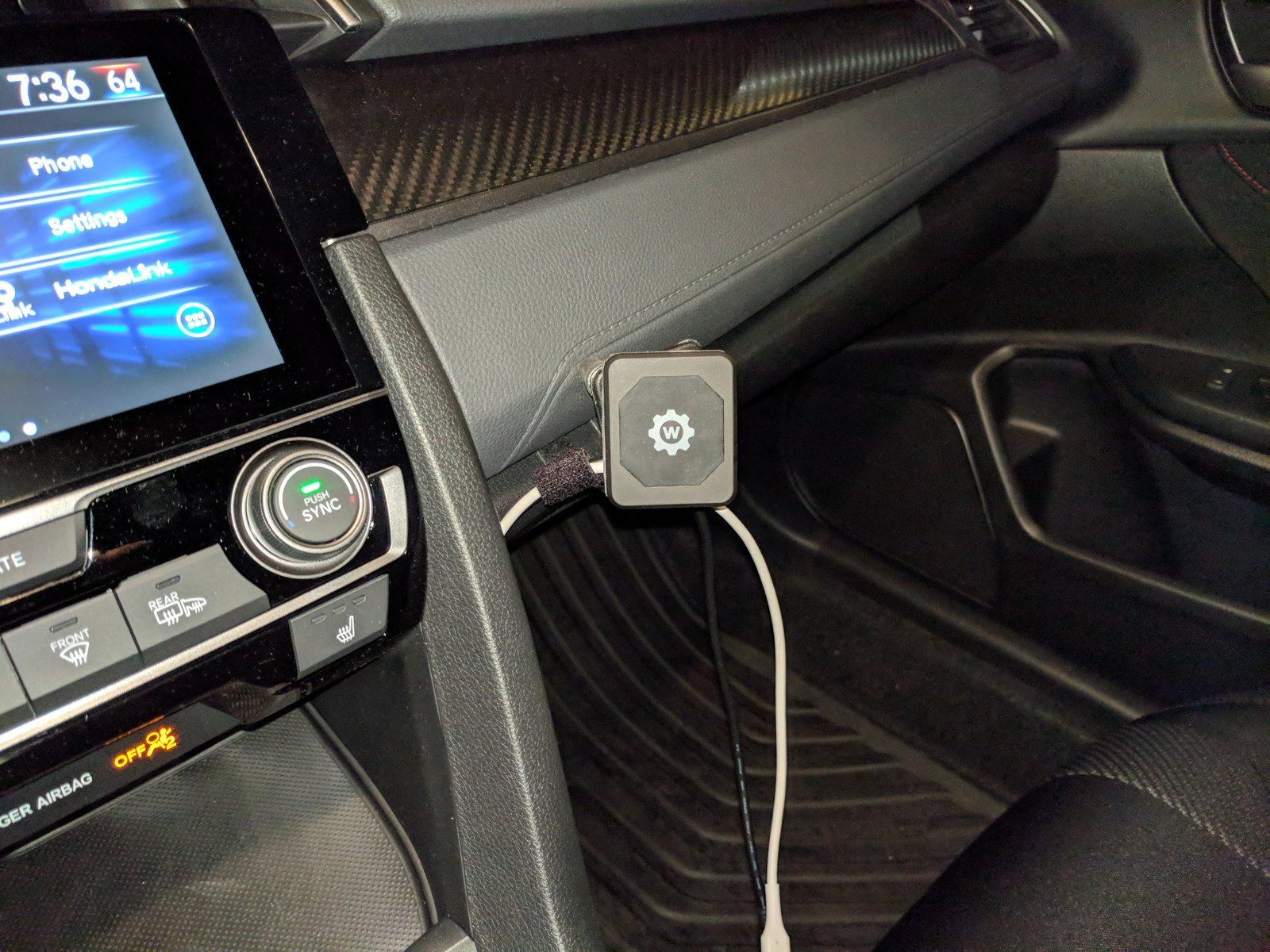

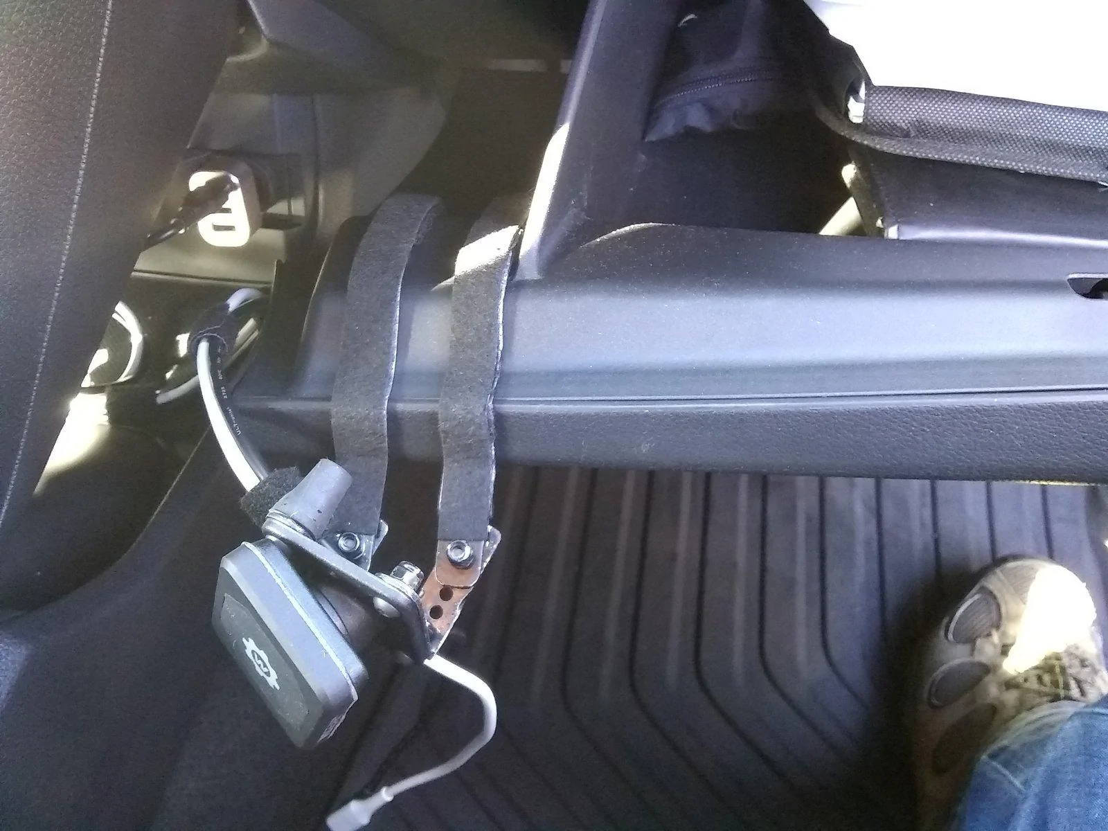

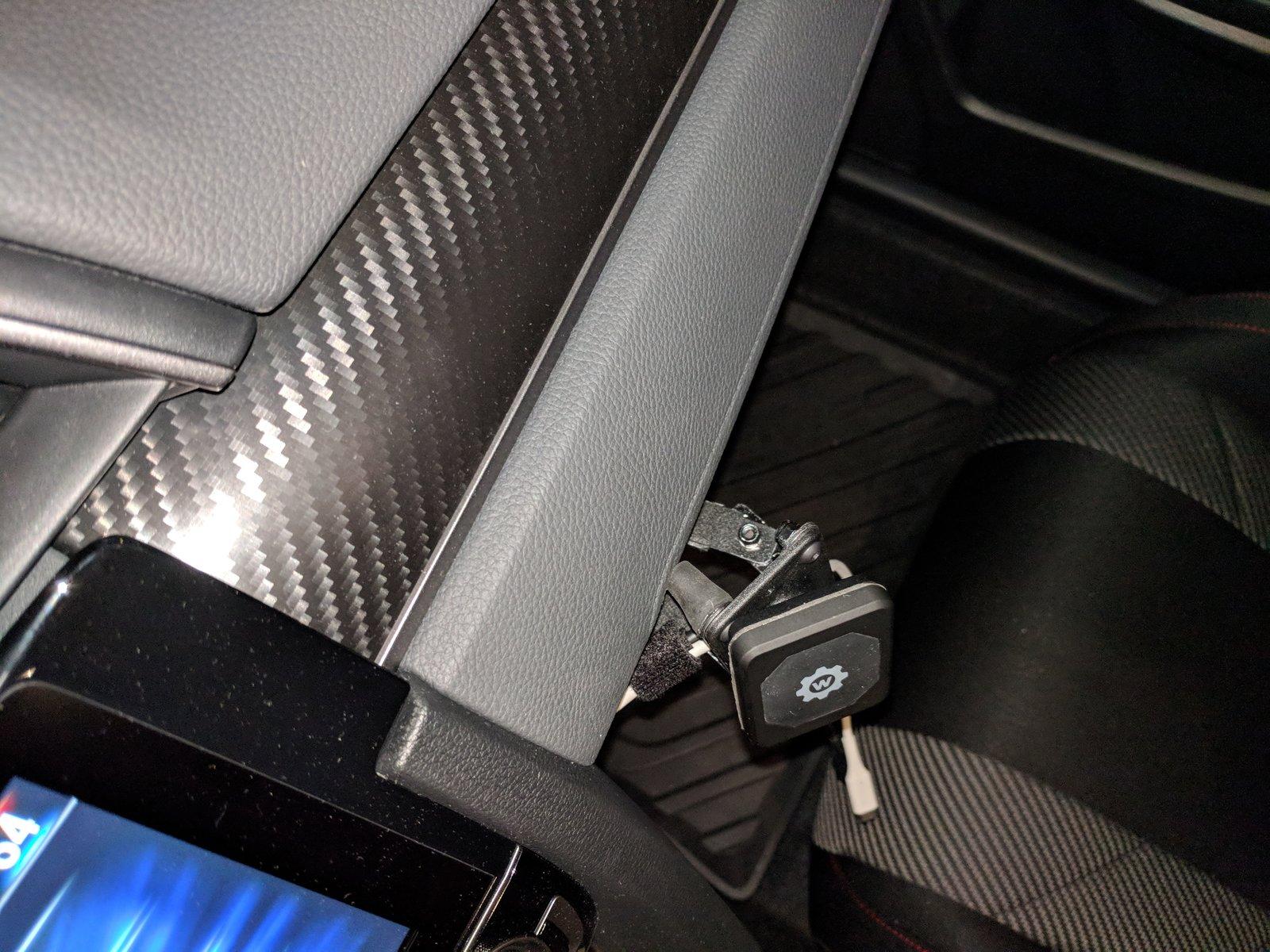

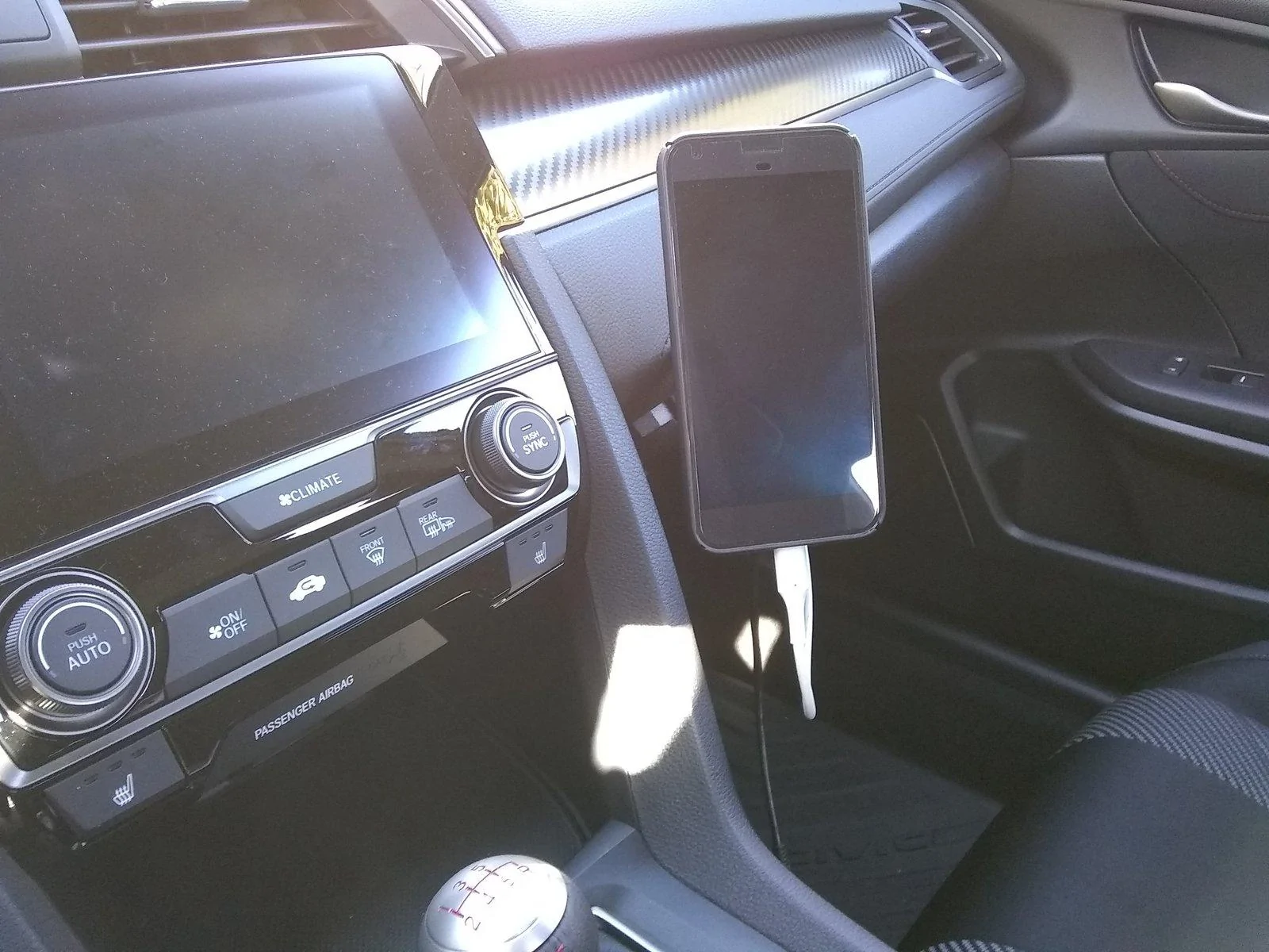

Just got my 2017 Civic Si two weeks ago and it was driving me crazy that I couldn't find a decent mount that wasn't over the screen and attached to the vents. After exhausting my search efforts, I decided to build my own. Using a variety of mounting hardware and some aluminum, I have what I think is a decent solution that tucks securely into the glove box and won't cause any damage or any need for drilling holes. If anyone is interested, I can post as much of the process and components and where to buy them as I can. If I get motivated, I might make a new one and fine tune some of the imperfections. The one arm needs to be redone but doesn't look as bad as the picture makes it look. The drill caught it at an odd angle right at the end of making it and I didn't feel like redoing the whole thing.
Honda Civic 10th gen Cell Phone Holder Mount IMG_20171020_193615 Honda Civic 10th gen Cell Phone Holder Mount IMG_20171020_193633 Honda Civic 10th gen Cell Phone Holder Mount IMG_20171020_193657 Honda Civic 10th gen Cell Phone Holder Mount IMG_20171020_193942 Honda Civic 10th gen Cell Phone Holder Mount IMG_20171020_152814304 Honda Civic 10th gen Cell Phone Holder Mount IMG_20171020_153007247 Honda Civic 10th gen Cell Phone Holder Mount IMG_20171020_193900

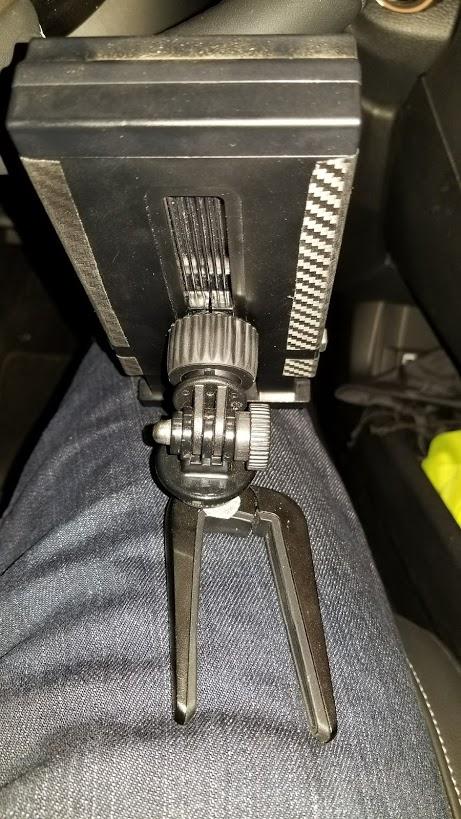

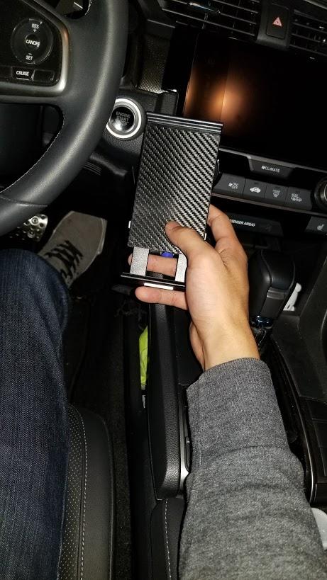

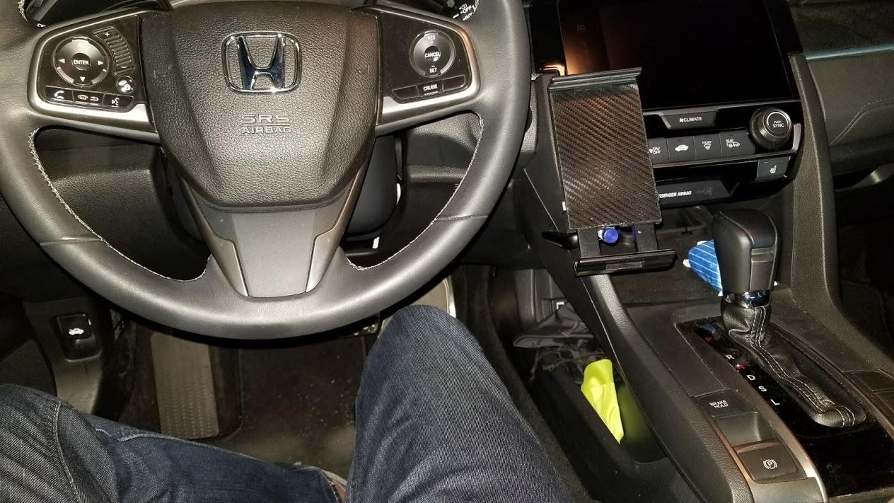

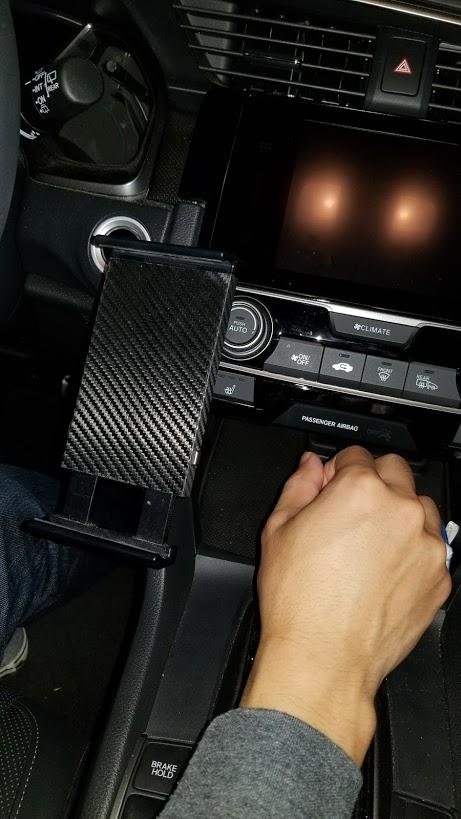

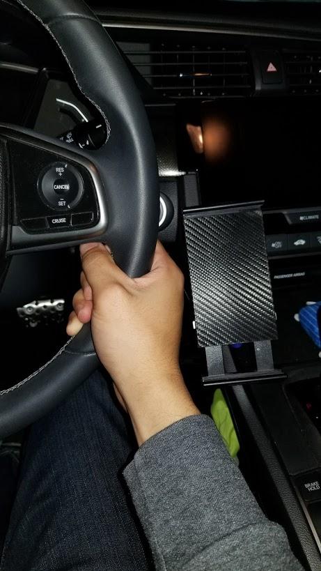

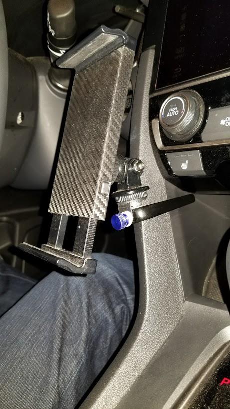

This one is pretty good in my opinion. No adhesives, no drilling/screws. Doesn't block vents, can reach easily with arm fully on the arm rest, and from the steering wheel
Honda Civic 10th gen Cell Phone Holder Mount bef7XL5
Honda Civic 10th gen Cell Phone Holder Mount TLdgbJQ

I'm not sure how you wouldn't hit that with your leg when it's on the steering wheel side and how do you adequately charge it when it's that close? Also, for those of us who drive mauual, that simply would not work. Good solution for your case but not all. How does that mount and how secure is it?

Only the tablet would possibly block shifting. I don't actually use the tablet in the car, just used it for the picture to demonstrate. But if you use it just for phone there is ample room for shifting stick. Doesn't block turning the steering wheel, and you would actually have to try to kick your leg up really high to hit it. The mount also rotates and shifts vertically if you desire. The angle of the photo makes the leg room seem smaller than it actually is. I've used this set up since I got the car and not once has it interfered with my driving. Charging is a non-issue for me. My phone last longer than a day under heavy use, but I can take some photos to demonstrate how it would look.

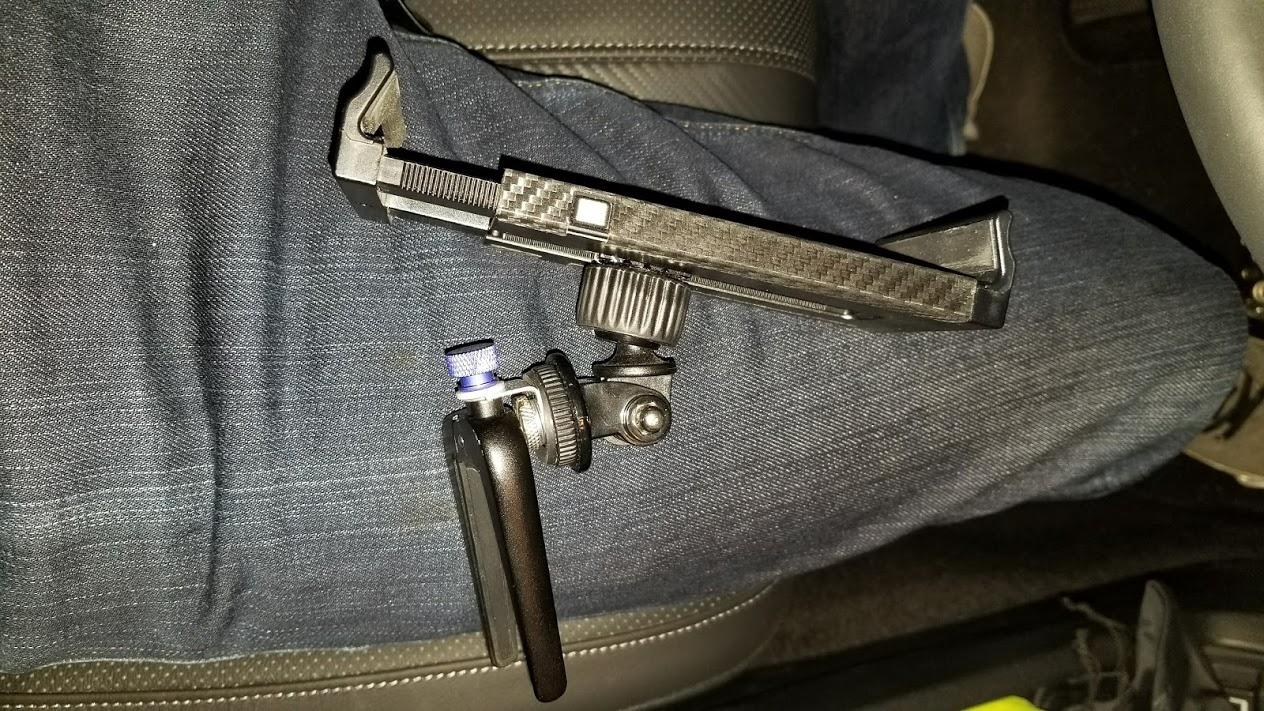

What mount do you have? Thanks
I made it myself. It's very easy, you just buy a guitar capo and stick whatever mount you want to it. Mine is probably a bit more complicated because I had some preferences, like using my old mount, and wanting it to swivel 360 degree. I did not want to block vents, middle console pocket, or any buttons. I also did not want to reach for the phone, and did not want to obscure my view. I did not want to use adhesives or screws. I wanted it to look good when the phone was not in it. The design changed as I was making it too, which added some unnecessary complications. But essentially it's just a guitar capo with a go pro ball that fits into the original mount. Took some additional photos. I added the carbon fiber vinyl on to it. There is ample leg room, as some people were disputing that I'd knock it with my leg.
What it can do:
Tilt up/down/left/right
Swivel 360 degree at the base
Rotate 360 degree at the part that holds the phone
Adjust height up/down
Holds phone/tablet 4-8 inches
Can insert and remove with one hand
Reachable from steering wheel and from armrest without extending
Has a hole in the bottom to let you plug in
Easily tighten/loosen by the blue screw. I changed the screw color to match the color of my car
Honda Civic 10th gen Cell Phone Holder Mount 20171022_175928 Honda Civic 10th gen Cell Phone Holder Mount 20171022_175951
Honda Civic 10th gen Cell Phone Holder Mount 20171022_175940 Honda Civic 10th gen Cell Phone Holder Mount 20171022_180006 Honda Civic 10th gen Cell Phone Holder Mount 20171022_180041 Honda Civic 10th gen Cell Phone Holder Mount 20171022_180052 Honda Civic 10th gen Cell Phone Holder Mount 20171022_180108

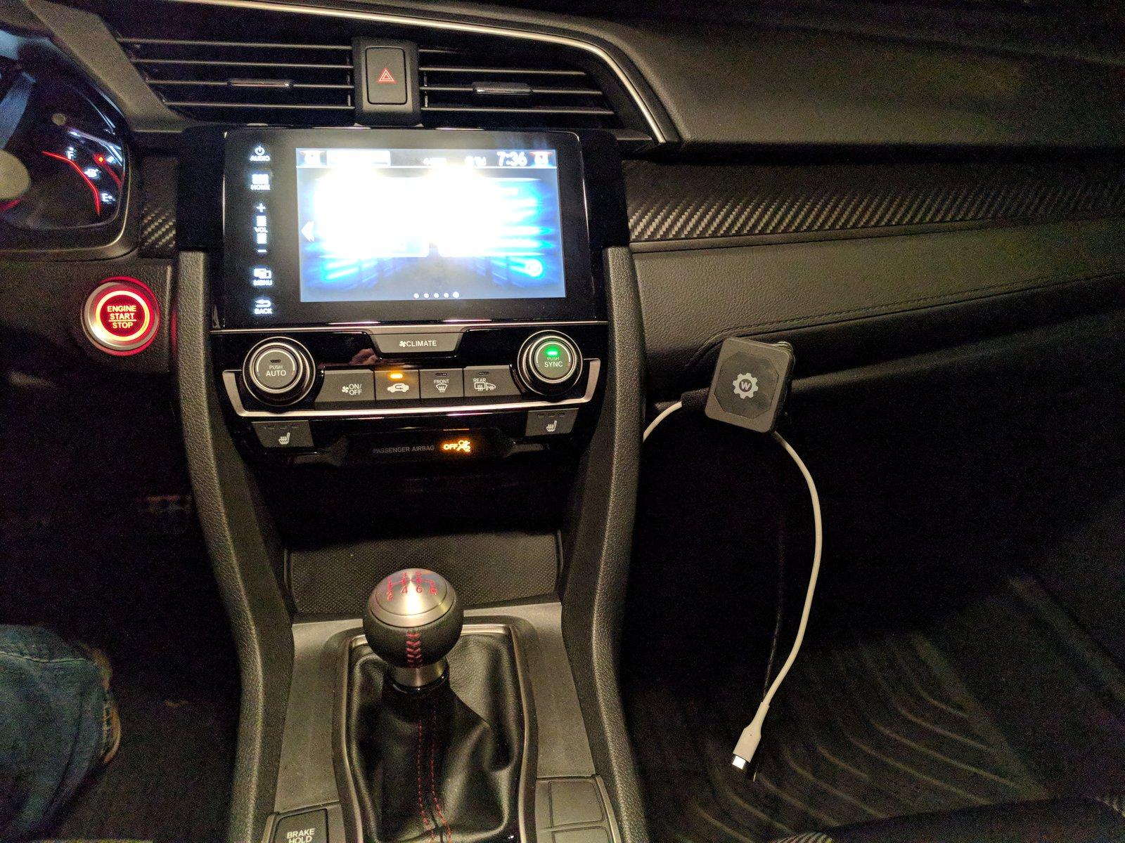

Seeing all these makes me glad I put mine on the left side. Don't even have to turn my head to see the phone screen.
