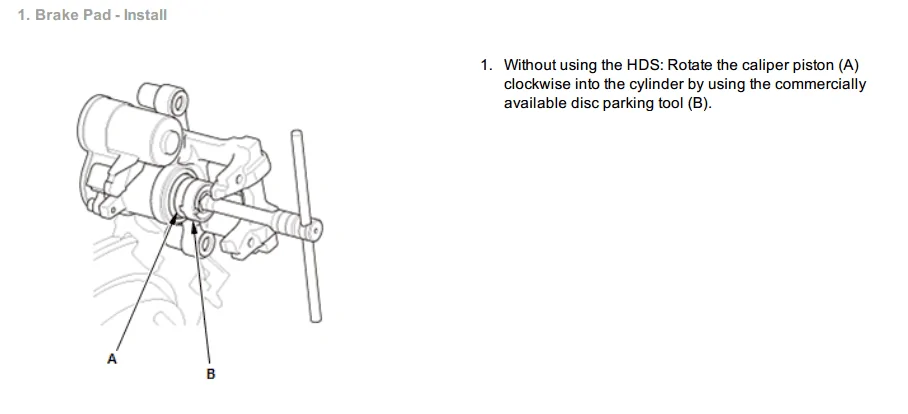

The service manual for the rear pads just says to either pull the pistons back in using the Honda Link computer, or rotate them back into the caliper like any standard Honda. I'm guessing your friend was speaking from his experience with some other Honda, since I think it's unlikely he would've gotten in a 2016 Civic that already needed new rear brake pads.
Edit: here is the page from the service manual:
Is this tool the same thing as the little square cube tool that fits on a ratchet extension and covers a few different types of pistons, or is it a Honda specific tool? Had one of those cube things and never ever had to use it lol
You can borrow a rear piston tool set for free from most autoparts stores with a tool rental program. (AutoZone, Advance, O'Reillys, etc.) Harbor Freight also has a set for sale, but I haven't seen it down to the $20 I paid a few years back; seems stuck at $40. Anyway, the rental kits work MUCH better than the cube.

I use one of these, it costs around $12 CDN.
Did you have any problems using this tool to wind in the piston (on a 2016 ); assume that the parking brake was not on. Did the car roll? Did you have wheel blocks?
And most inportantly, after the new pads were put on, did you have to do anything special to get the piston to compress the brakes?
Thanks for all your help.
No problems at all. I had to grind two (2) metal nipples on the tool, there is a side with four(4) nipples, just grind two and it fits perfectly.
No need for wheel block, you do one wheel at a time. Nothing special to do, just a normal brake job.
I lubricate all 4 brakes once a year, lots of calcium on our roads around here during the winter, this is a good thing to lubricate every year.
