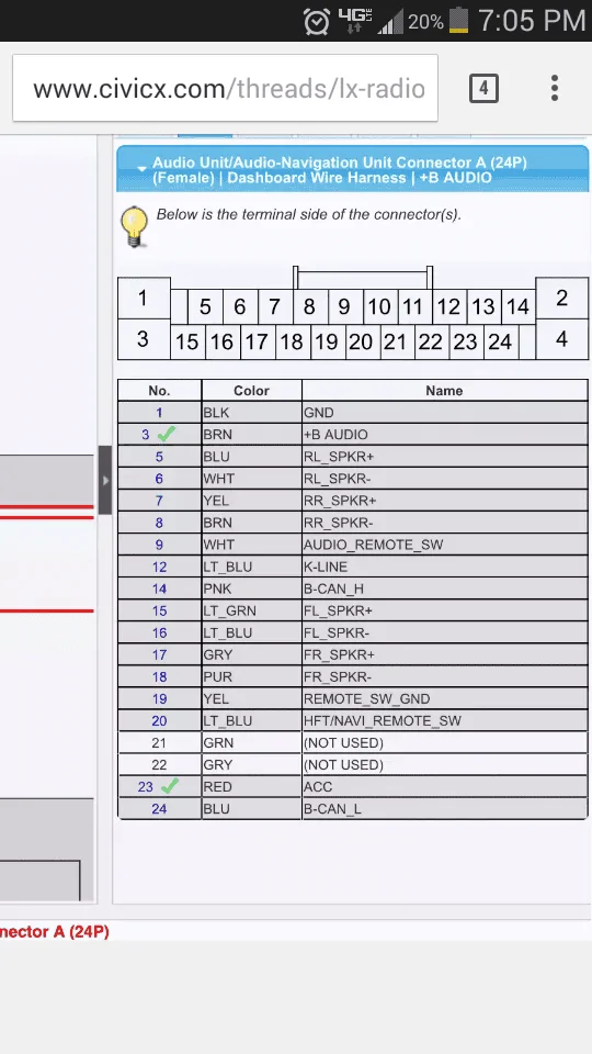

For those with an EX hatch, where did you connect the LOC to? The rear door speakers have 4 wires connecting to them, 2 on each terminal. Then the wires would have to run through the door harness.

I just pulled the radio and put t-taps on the
Wires. The actual connector looks like the one below, just mirrored - flip flopped when looking at the wired side. . I used the yellow and brown wires.
Steven - did you use one of those wires as a remote turn on for your amps? I figured if I am in the dash and I can tap one of those wires, that keeps me from having to go to the fuse panel.
I assume 23 red would do the trick, but didn't know if 9 white would.
Thanks!!!
Thanks!!!
My p300-10 has a audio turn on option and as soon as it senses a signal thru the rca line it turns on.
