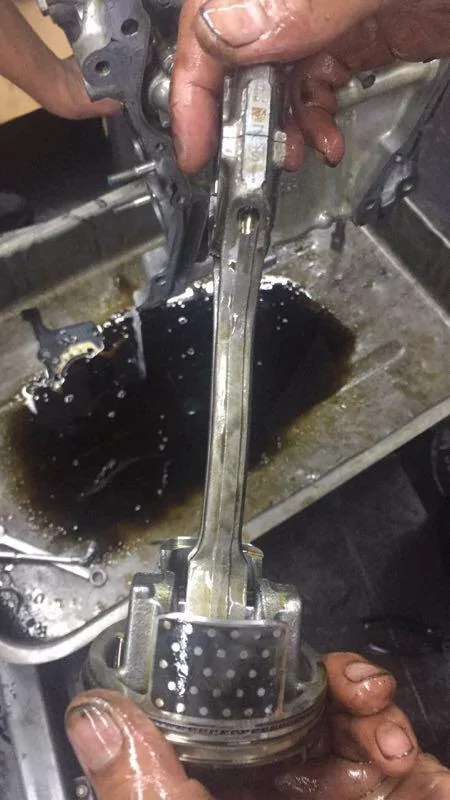

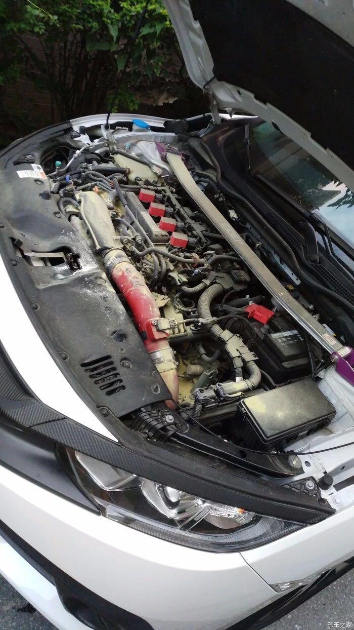

Here's one with 27 pounds of boost
Was this an Si or a regular Civic? What tune was this running? There are OTS tunes out there now that pushing those levels of boost.

The car has 10:3:1 compression. Isn't that a bit high for a lot of boost? I don't know.. Just asking
direct injection allows more boost, but we run really low timing
