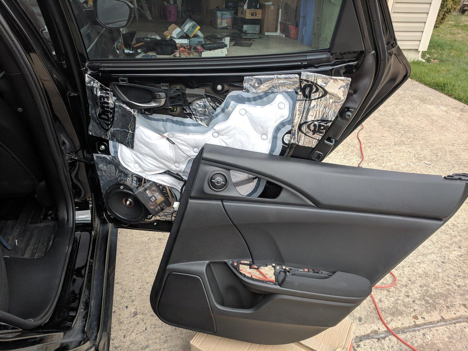

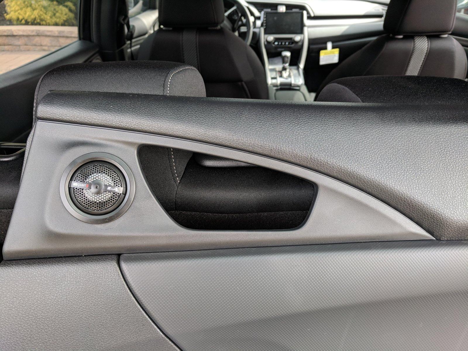

i went with MB Quart Z line Components and love them, just installed this past Thursday, 2017 Civic Hatchback Sport

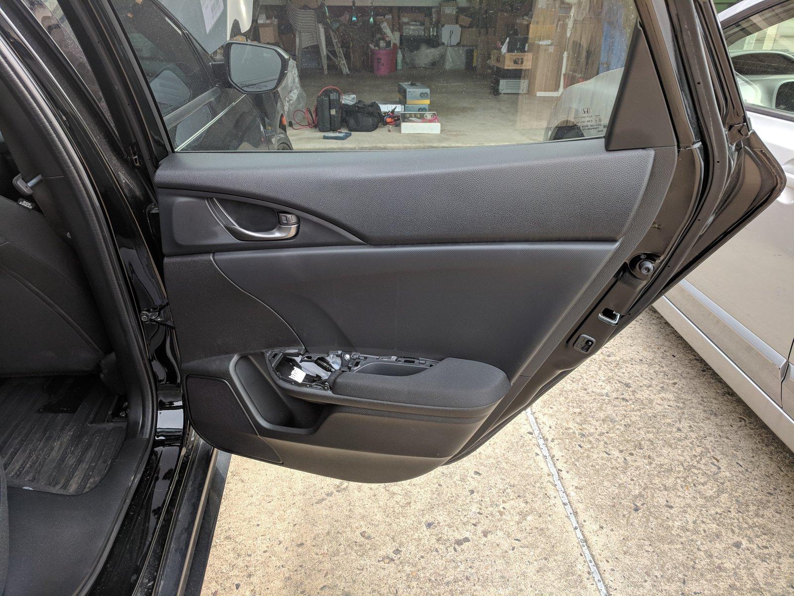

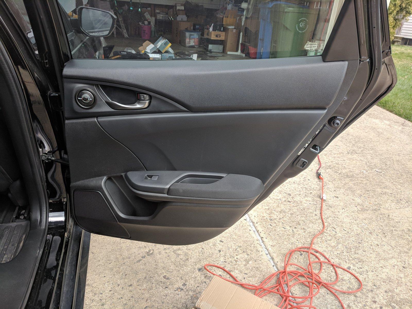

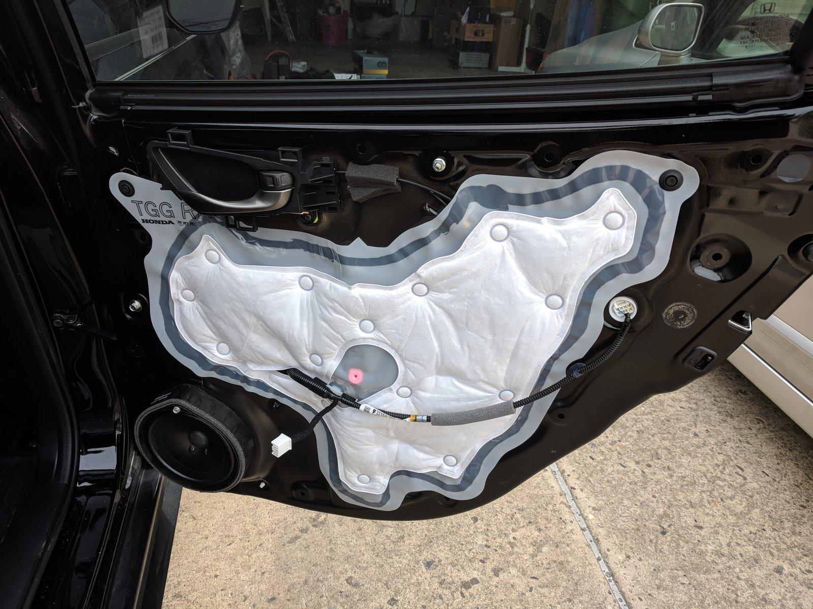

That's sick! Are the holes in the back door drilled? What kind of civic do you have? Mine doesn't have backdoor speakers :)
i have the 2017 Civic Hatchback Sport, the coax speaker was in the rear doors, i did change them to MB Quart components, when i dook the door cover off, there was a spot where the factory tweeter would go on the EX and above models, just took the 1" hole saw and drilled it out in the factory space. im going to assume that if you don't have rear door speakers then you have the sedan with the speakers in the rear deck shelf.
I see. Yes I don't have the rears, but I'm going to work with it and just have coaxials in the rear.
