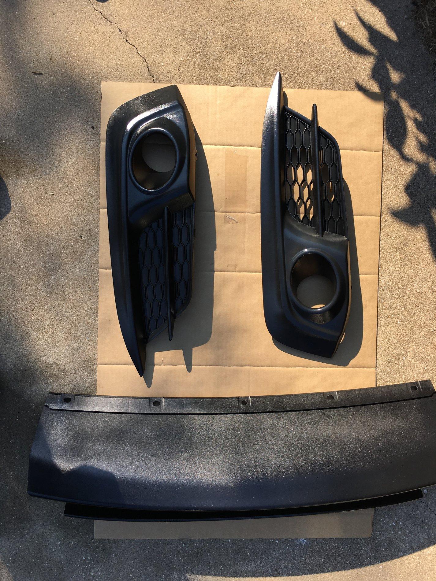

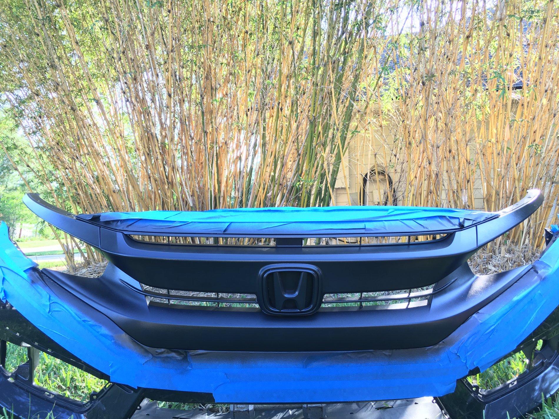

I messed it up a bit so I'm thinking I'm gonna re-do it. I've watched some YouTube videos on the Dipyourcar YouTube channel to learn how to better mask before painting and remove the mask after painting. I suggest you do the same to avoid the mistakes I made yesterday.

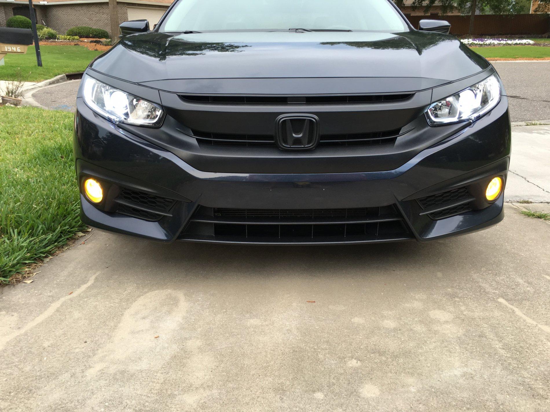

Here's a pic of the finished product. In the pic it looks good but up close you can see chrome still showing through by the edges due to my incorrect masking application.

That was 4 coats of matte black and 3 coats of plastidip glossifier to make it glossy

Thanks but if you saw it in person you'd see how the edges are all messed up. Watch their video on masking. I wish I had before I tried. I masked it off like I would if I were painting the grill. I took the tape right up to the edges and tucked it around the edges and this is what screwed me. You have to leave a frame around whatever you're dipping and peel off the excess dip afterwards. If you mask it right to the edge like I did, then when you remove the tape, the plastidip comes with it and leaves ragged edges and areas with bubbles where I managed to push the dip back down.
