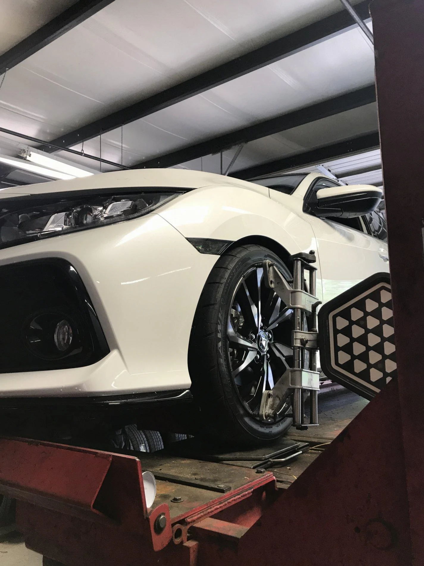

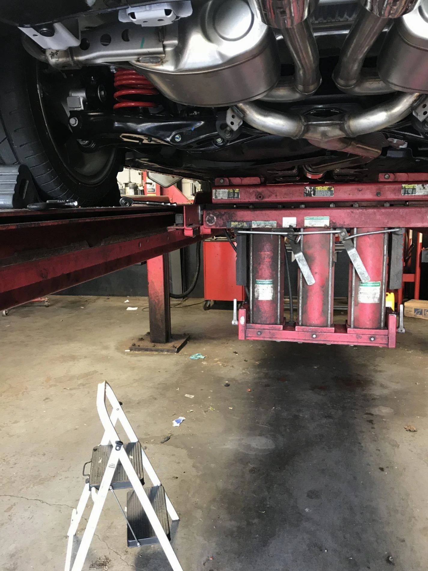

4,873
The alignment kit was installed.
I wonder if it's normal for shops to send cars out with unequal camber. They tried to do the same thing to me. It looks like they did not touch the camber arms you had installed. My shop initially didn't know what to do with them, even after I provided the instructions. I had to get back there and fix it myself, true story.
It's normal if the shop sucks. ;)
I found a good guy when I got my EP's camber arms installed. This shop let customers go back into the service area. I asked, "Hey, can you install these in the rear?" He looked at them, we looked at my car on the lift, and he goes, "Okay, yeah, I see how these work -- loosen this, unscrew that, lock it down -- yeah, I can do it." Did the work, brought me back to show how he did it, and they stayed in place for the next seven or eight years until I sold the car.
