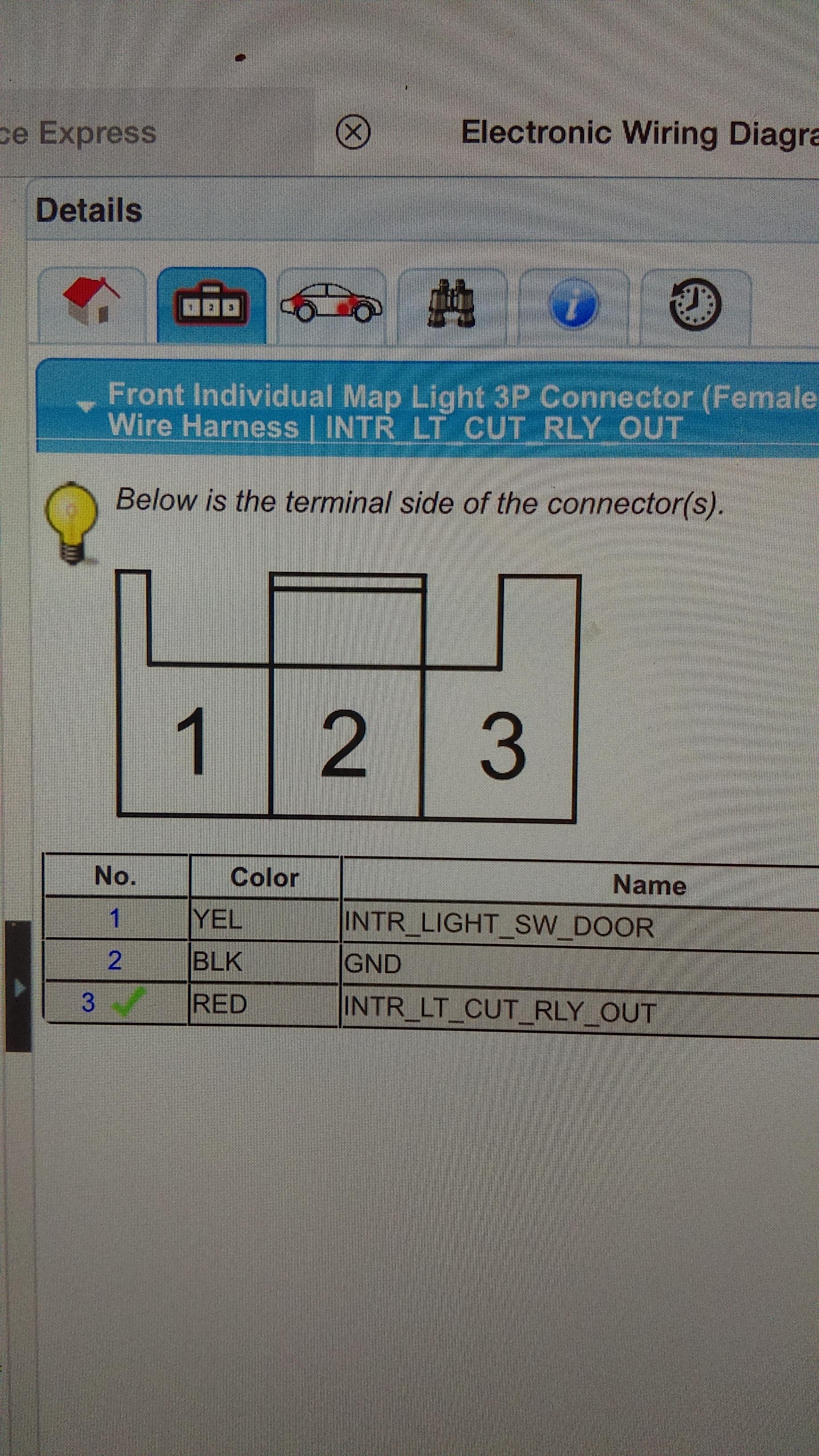

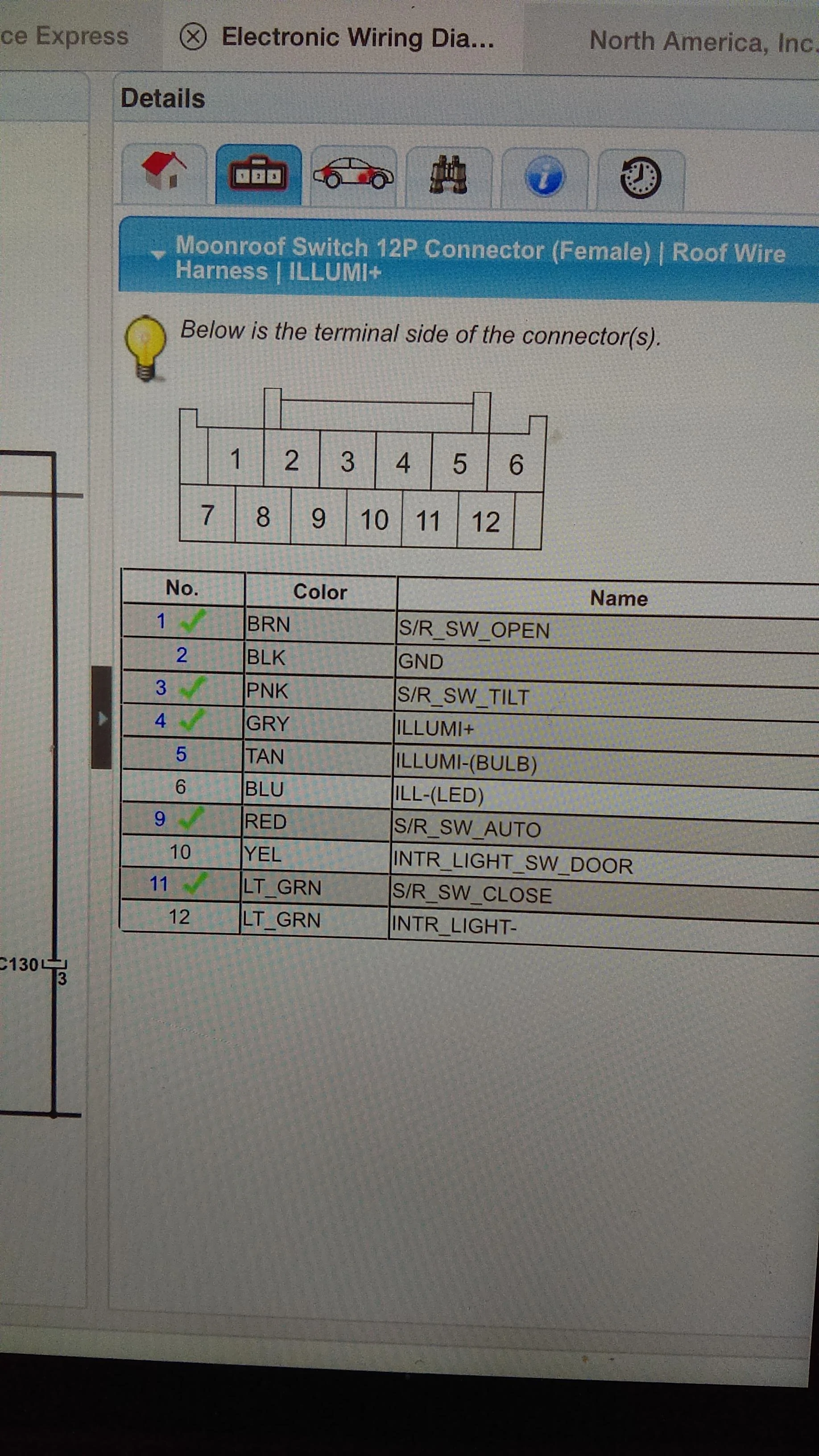

Also here are wiring schematics for moonroof/maplight connectors (for 2017 Hatchback EX) that may help confirm your multi-meter readings.
Honda Civic 10th gen OEM HomeLink Install Moonroof
The maplight schematic is straightforward (red=positive, black=ground):
Honda Civic 10th gen OEM HomeLink Install Maplight
