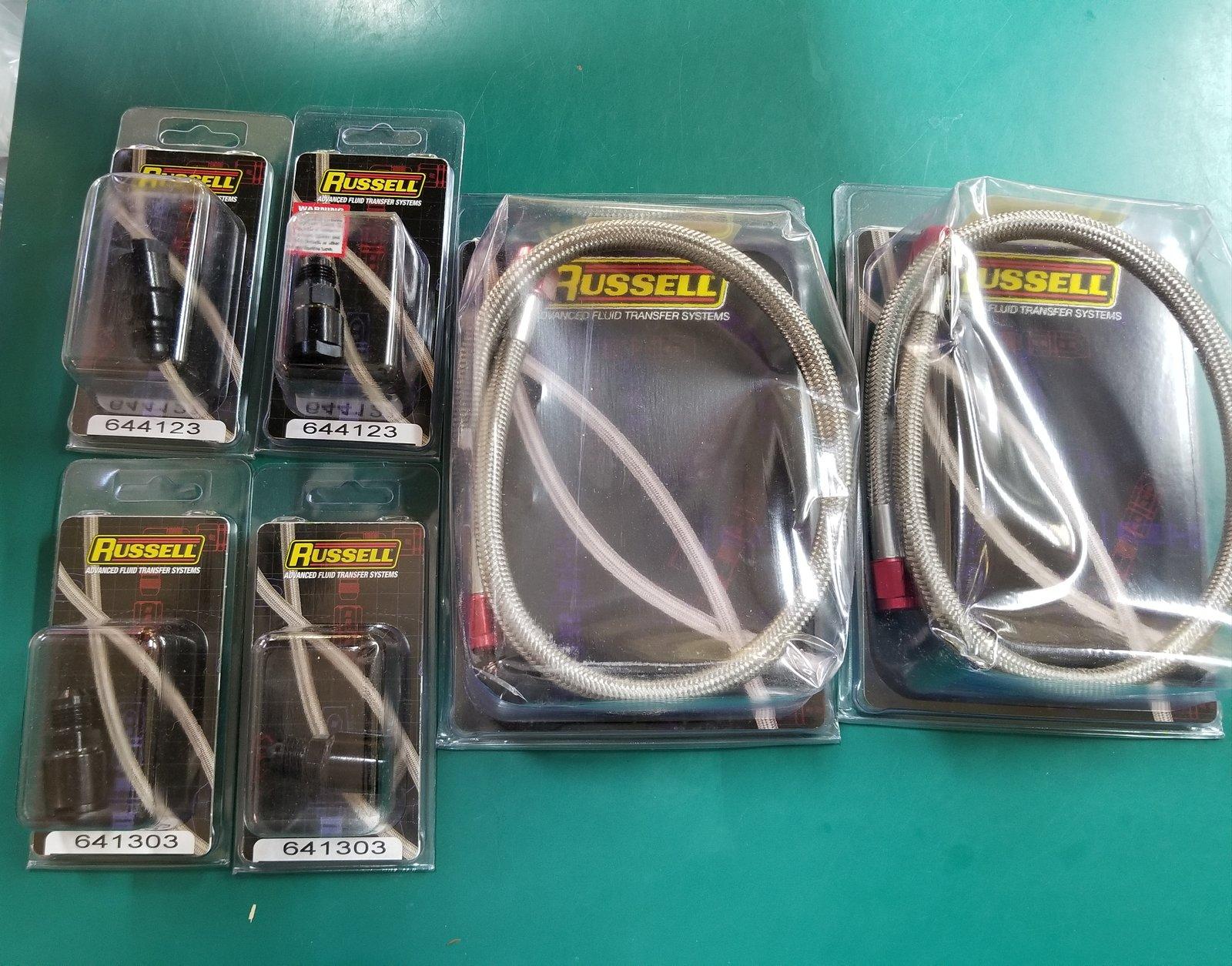

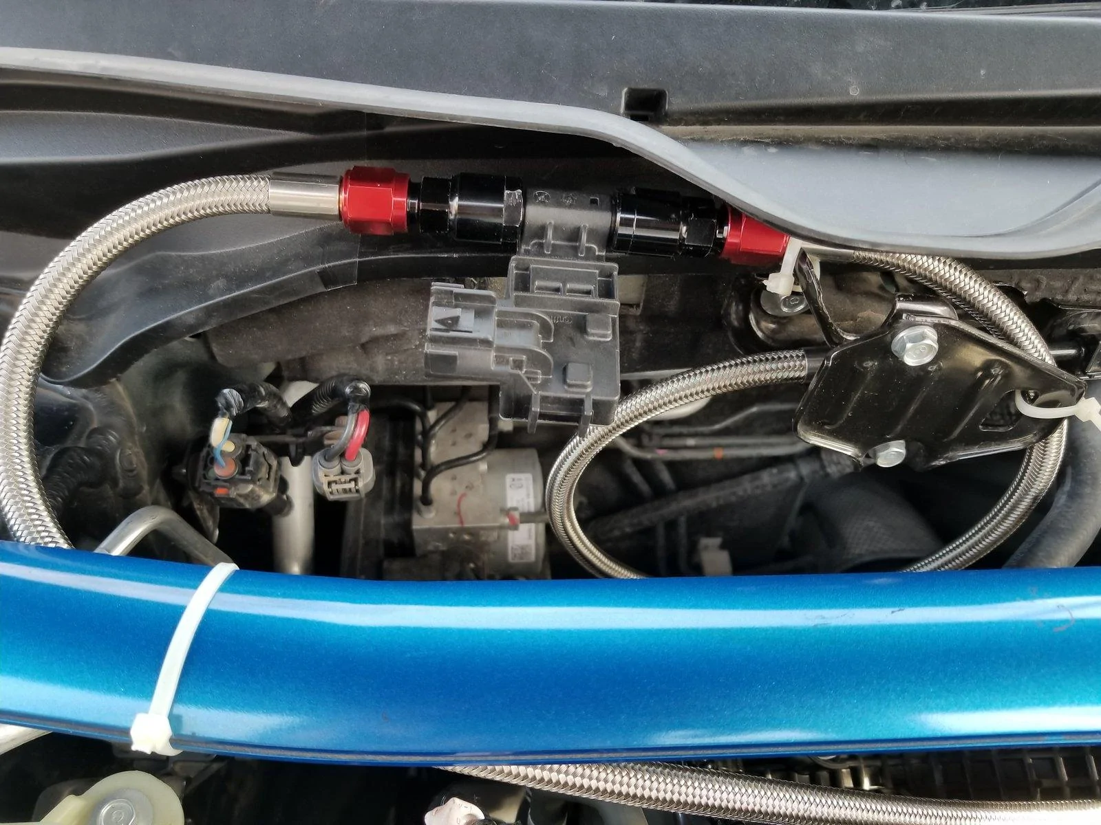

Here's my setup with AN lines. Idea is to use a 6" fuel line on the firewall but the smallest Russell sell is 1'. You can also make your own line too by buying 3 or so feet of teflon -6an line and 4 -6an fittings.
I have it temporary mounted there. I plan on tucking it somewhere. Where it's not as visible
I went with the zeitronix ECA-2 kit. The kit and AN fuel line costed me under $400 on Amazon. I believe the Innovate kit is around $250. Dorman fittings is $10 or AN for $100 or less
