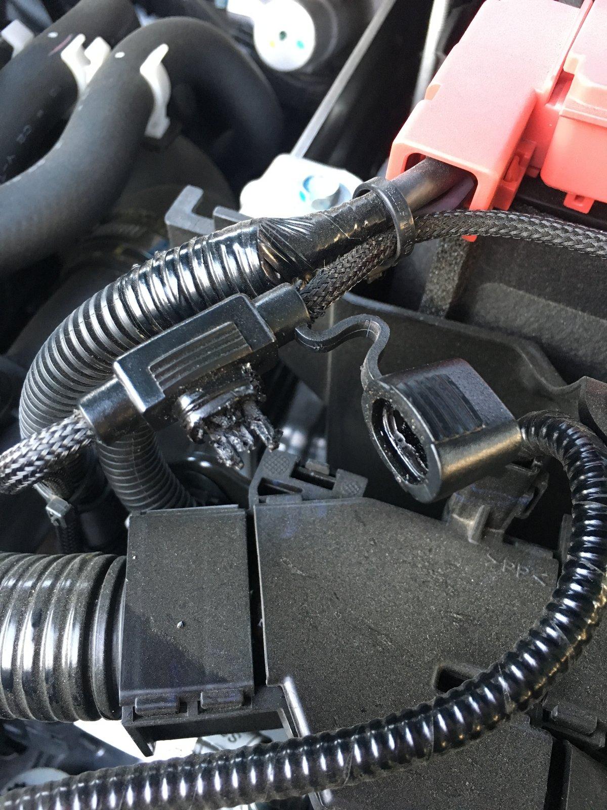

An additional relay to what is already in the Morimoto harness is not required, and not what those here are suggesting. They are just stating that a relay is required.
For example DO NOT do it this way and use an adapter to use the OEM headlight harness input to directly power the ballasts.
